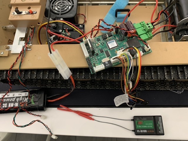

Hi guys... i ve got all i need ans start installation...
Almost done...
but now im stuck...
I pluggeg the receiver cable on the board.... but now what????
I have a flysky ia10b to plug....as u can see in the pic... lot of cables with black pin... that i think are channels that go into the receiver... but...
How?????
I have a new radiomaster tx16s... virgin... to pair wirh the board... but...
How???????? Wanna cry....
Anyone could please help me???
Almost done...
but now im stuck...
How?????
Re: Help connecting elmod pro on torro tank...
I have the same set up. Here’s my receiver wire connections. Hope this helps.
Ignore my servo connection to channel 9. You won’t have that.
Hi friend, the ideal port for the + and - wire, is where it says VCC. You connected it in a sensors port. Works, but it is better the other one.Jimster wrote:I have the same set up. Here’s my receiver wire connections. Hope this helps.
And for Andreabert:
https://www.elmod.eu/pdf/Fusion_RevF_english.pdf
Reading and understanding the manual will save you a lot of trouble.
Wow! Thanks for that. Changing it now.
Done! Looks better.

Are you using the correct binding settings, i am away until Sunday night. Had trouble binding at first with flysky as it has lots of binding settings, will post pic when home. Hope you get it sorted (ronnie42). Sbus setting i think on flysky? Wish the RX came with binding instructions.

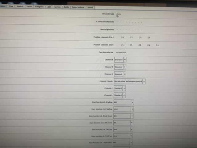

I think that the problem is here.
The tank doent see any receiver...
- 19869C38-A868-470B-B02E-E52E7E899668.jpeg (53.9 KiB) Viewed 4659 times
ok guys
now the tank work. but still have some problems....
i mean,
the stick axix are wrong
on my radio if i move the stick up and down im operating channel 2
if i move right/left im operatin channel 1
how can i swap?
i mean,
how can i swap?
