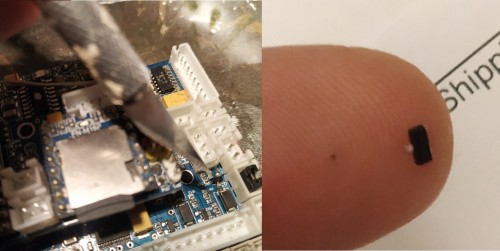

Here is one example of the things I fixed myself
I was very worried but hey, the thing did not work so there was not a lot to loose. Glad I did it.
So to any of you with something not working, guys, just try it!

Thanks :D , and you're right. I dont think there's a component on there worth more than 20p. If it's broken you have nothing to lose and can learn a lot on the way. Good job replacing that little SOT23 device, you dont realise how tiny they are until you try and work with them, sneeze and they're gone :haha:
