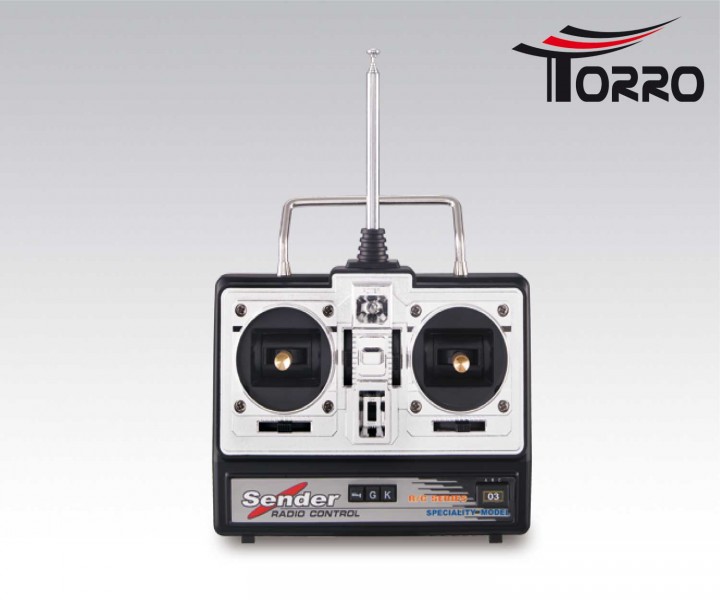

Not at home so from memory, its the older 2.4 crystal transmitter / receiver. I've tested the battery with a cable tester to make sure that I'm getting the full charge, otherwise I do make sure that it goes on charge for a while.

My transmitter
Jofaur86
Posts: 2172
Location: Centre France
Re: HLong Tiger 1
Post by Jofaur86 »
OK,radio 27 Mhz :'( old génération,then wiring diagram attached.For the battery be sure that the even if voltage OK :thumbup: it has the capacity (Ah) at the end if charge for a 7.2 volts must be at least 8.6/9 volts :P
