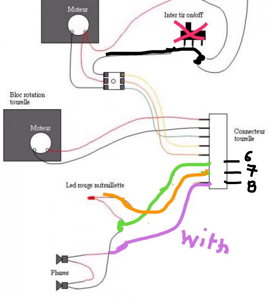

Hi, me again. The one who is trying to piece together a HL Tiger 1.
I've managed to test both the turret turn and the elevator, both motors work. I've even tested each in turn in the far left of the 8 pin connector (on the hull end, bypassing any other cabling just in case there is a dodgy connection) so that I can confirm that the transmitter works with both.
I have a problem where the elevator or the turret turn, doesn't work in pins 3 or 4 (from left). I've had a look at the transmitter (crystal type) and nothing looks loose or rusty. Does anyone know if there is a way to test the mfu, other than the basic tests I've been doing ?
I've even checked the web for various info, apart from getting even more confused with the schematics everyone has posted about the wiring, they all seem different, even though they say they are for a HL Tiger 1 :-(
The current info I'm working on is shown attached.
Thanks
Cabling I'm following

Just for info, after I've followed the cabling in the diagram I've posted, I can use the joystick on my transmitter and when pushing either left or right (with the turret turn connected), the motor responds. If I then take you advice, and transpose the cabling, won't the signal (via the transmitter for turret turn), then be activating the lights, and vice versa ?
Will try anyway and see what happens :-)

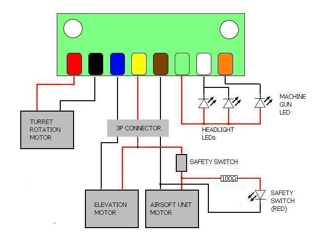

Jofaur86
Posts: 2172
Location: Centre France
Re: HLong Tiger 1
Post by Jofaur86 »
Hello :D
Y can help , here is the principle of heng long wiring,with the colors of the wires ,this is the original system. :thumbup:
https://www.forum-rc-panzer.com/t3963-C ... trique.htm

Jofaur86
Posts: 2172
Re: HLong Tiger 1
Post by Jofaur86 »
Yes :D
Sory,me too hard for English," Google translation " is my friend :thumbup:
Jofaur86
Posts: 2172
Re: HLong Tiger 1
Post by Jofaur86 »

thats great - and hopefully that reflects in the same diagram above :-) Plus loads of extra - Cheers

Hello :D
Error on previous photo,must be so for the heads lights and the machine gun,sorry for the drawing quality :{
Jofaur86
Posts: 2172
Re: HLong Tiger 1
Post by Jofaur86 »
Sorry :thumbdown:
Mad a mistake.....
1: white. wire in 7
2: Orange wire in 8
Am tired this morning :wtf:
