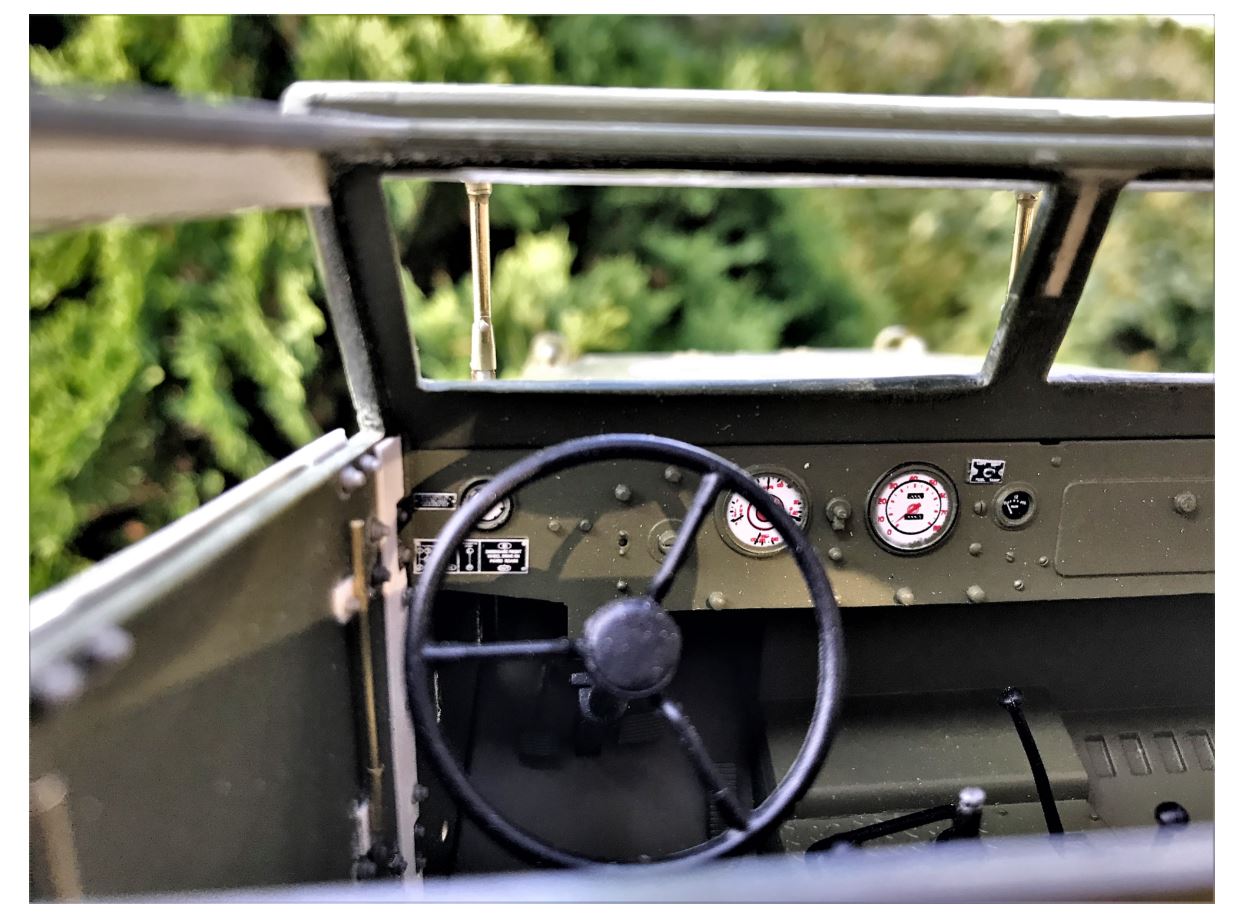

I noticed the front cabin is missing a few levers. And the buttons on the dashboard would benefit from an upgrade in size. One thing that WSN did very well in my views are all the markings on this vehicle. It is really sad that they will all be overpainted.
1/16 RC M16 Half Track MGMC Meat Chopper Korea build
I kept the dashboard removable so that I can salvage all the dials. I know Archer sells new ones, I will need to investigate if I should use them instead.
