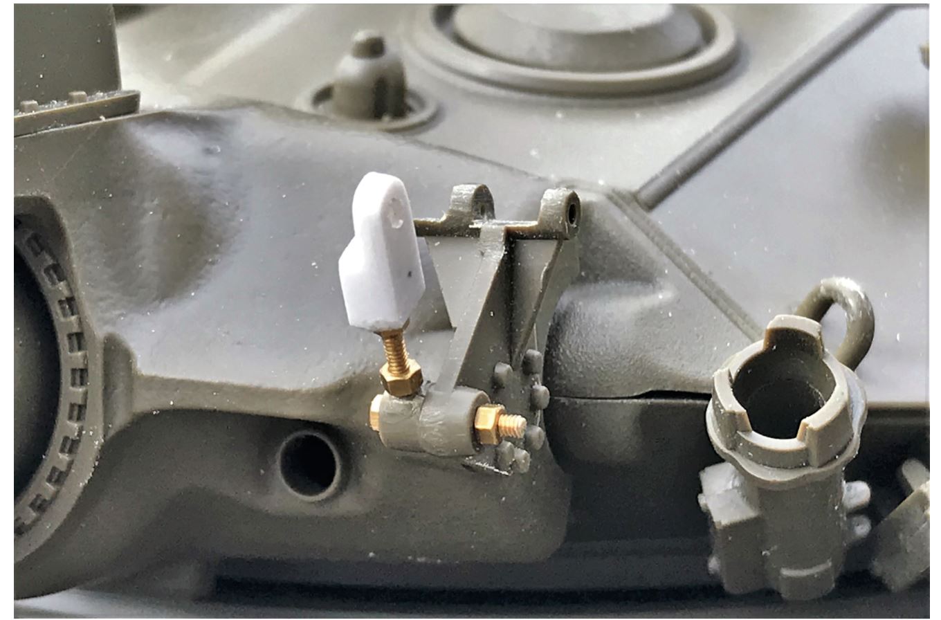

I will not install the search light on my model, Vietnam tanks are rarely seen with it. The mount is sometimes still there, sometimes completely removed. I decided to show the mount, but Tamiya got the forward arm completely wrong, see encircled.
An hour of work can improve it using an M1.2 bolt, 2 nuts and a plasticard part easily crafted using a hand file.

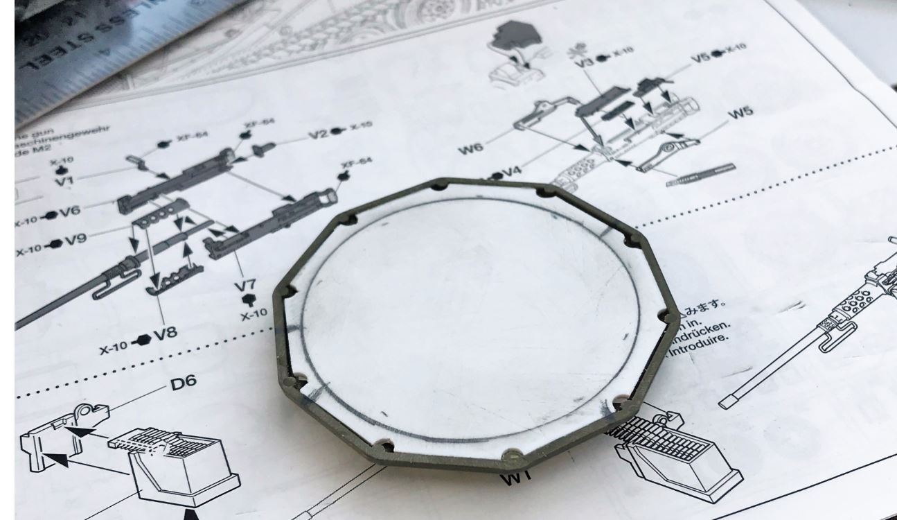

The M551 has a rotating cupola, electrical with a manual bypass. This feature of the cupola has been totally ignored by Tamiya.
Tamiya wants you to glue the cupula strait flush on the top of the turret in a forward facing fixed position, as if the commander could only shoot his M2 strait ahead. This is a big miss from Tamiya. The cupola should have at least been allowed to rotate by hand for positioning. I therefore decided to not only reproduce the feature, but also give it some simple RC function.
A base is created in plasticard to which a rotation roundel can be attached, creating with a thin plasticard strip and glued to the base while the cupola is inserted in its turret ring. Then the base is made hollow. Periscope glass will be added later after painting.
Instead of being flat on the turret roof like Tamiya is indicating, the cupula should be shown raised a bit.

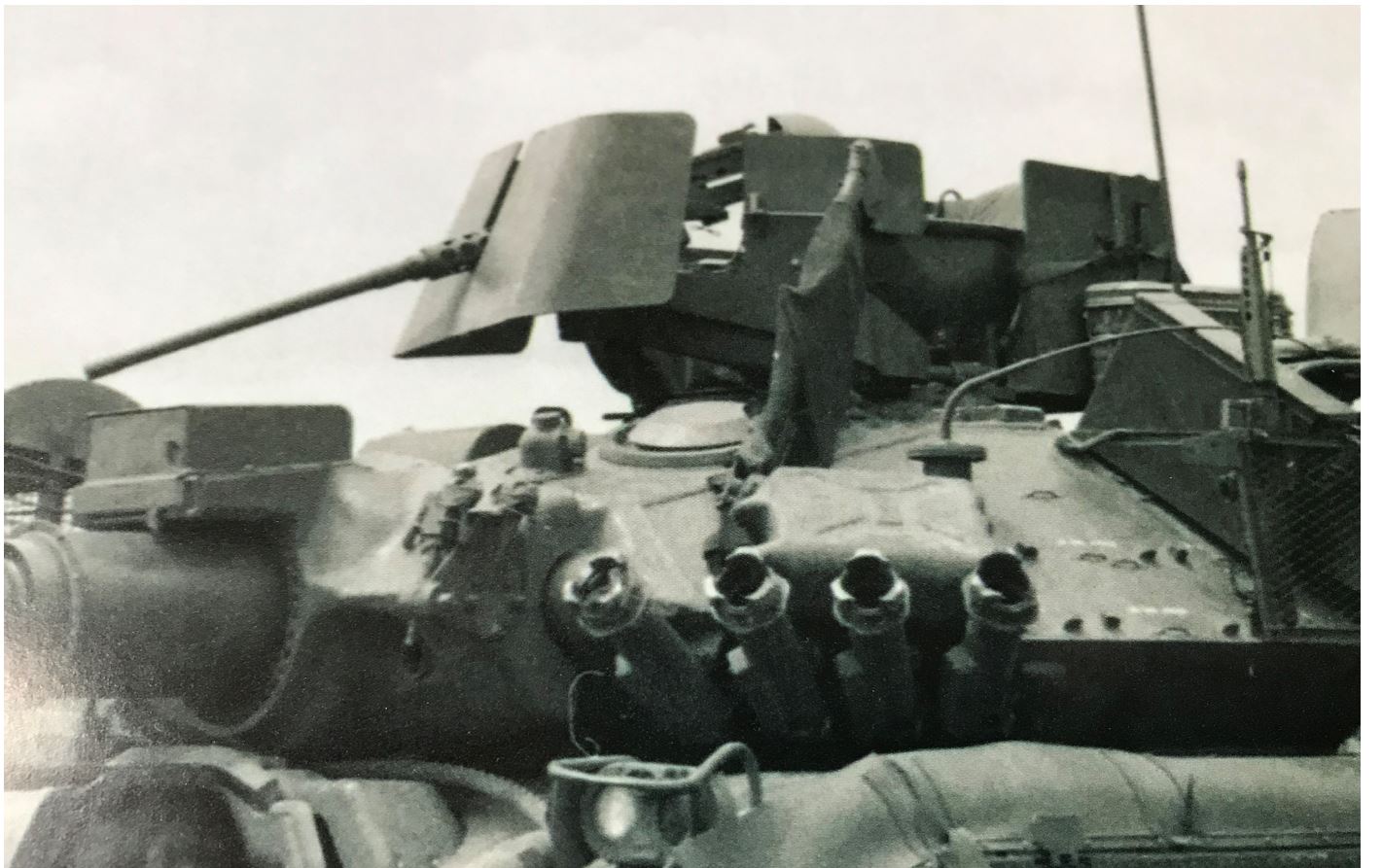

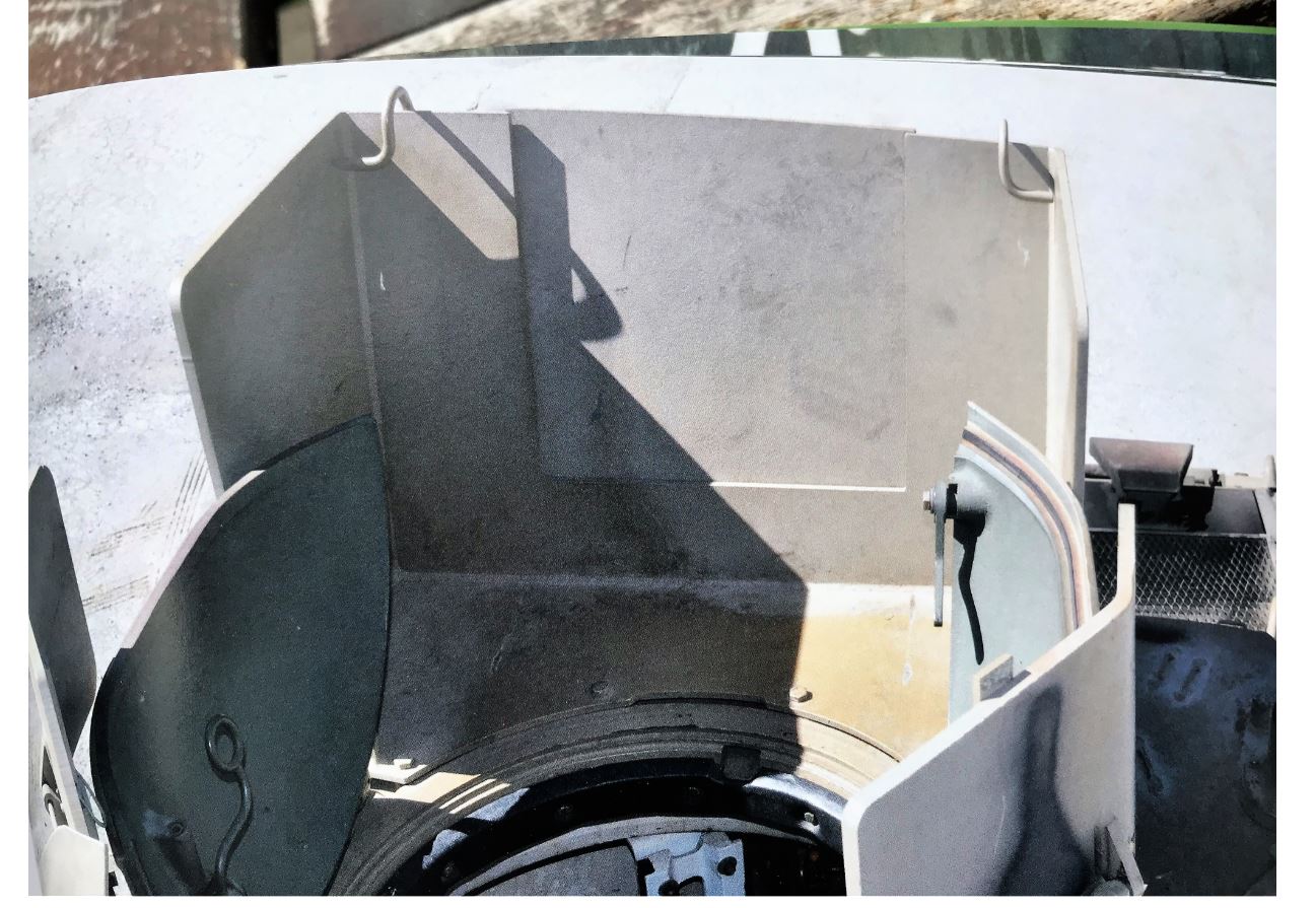

Instead of providing the ugly RPG mesh screen, Tamiya should have put focus on providing a good commander cupola, with a complete set of front and rear shields. Tamiya provides only the center parts but thankfully, these are the most complex ones. The missing components are pretty flat and easy to repro.
View of the rear component of the cupola shield.

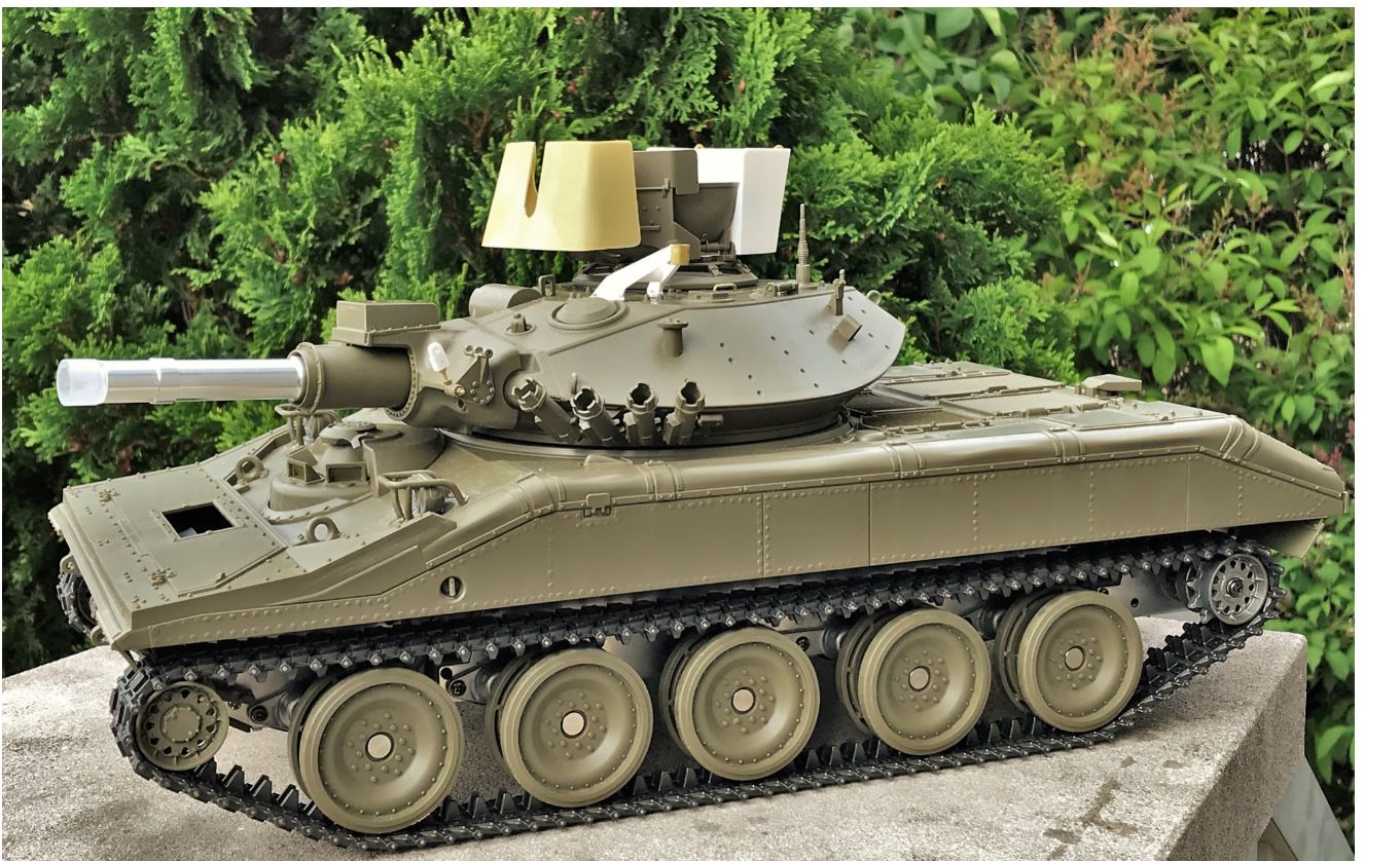

Both gun shield and rear cupola armor can be easily reproduced. The gun shield is the Verlinden M113 Acav shield reduced in size to match the M551 shield size seen on pictures.
Notice that Tamiya provides a clear part for the 152mm gun muzzle. I cannot imagine how this can be of any serious purpose or help to the modeller who pay a fortune for this kit and do not appreciate cheap gizmos. Maybe its for the gun flash to be brighter for builders who do not paint their models. But then, who wants a glass gun ?? I find Tamiya can make weird designs. A muzzle with the highly visible rifling of the real gun would have been a lot more interesting to have.

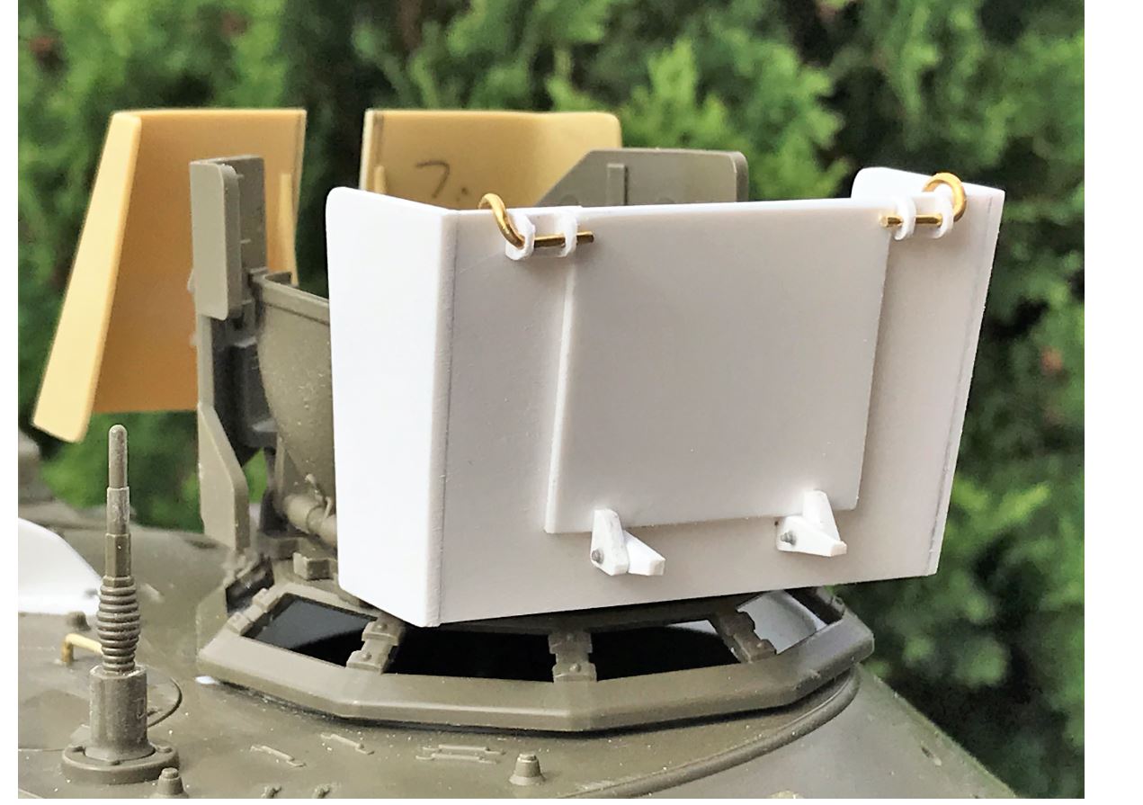

The back of the cupula is easily reproduced in 1.5mm plasticard using references and figuring the dimensions and functions the best I could. And the ugly molded-in solid handle on the gunner's hatch has been replaced by a 1mm brass rod. That's another corner that Tamiya cut in 1/16 scale, as if we were still in the 1970s.
Notice the molded-in tie-downs on the turret roof. These will likely all have to be replaced by better ones in 0.5mm brass rods.
Ah, I need to add bolts for the attachment points.
I removed 7mm from each side of the Verlinden shield, and re-glued the sides to the center section. I also put the sides over boiling water in order to bend the corners a bit more.
