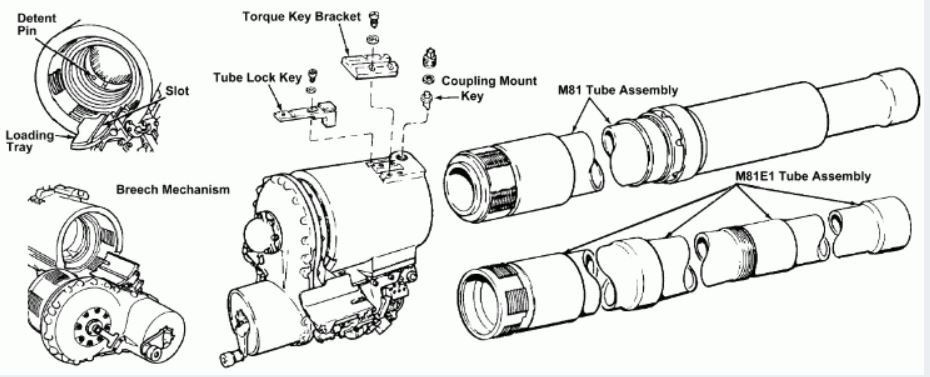

The history of the Sheridan is directly linked to its M81E1 Rifled 152 mm Gun/Missile Launcher. Also used on the M60A2, but in a turret that was not as good looking as the Sheridan. There are 2 versions of the gun, early M81 and late M81E1, with a much different look.

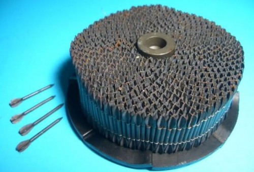

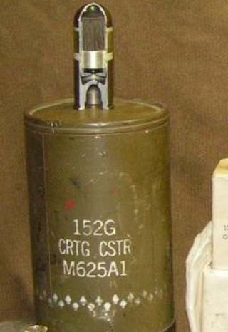

Use of the Sheridan in Vietnam is associated with its 152mm Beehive canister ammo that contained 10,000 metal flechettes per rounds. Whole waves of attacking Viet Cong could be massacred with a couple of rounds.
1/16 RC M551 M-551 Sheridan Vietnam build
Example of the flechettes

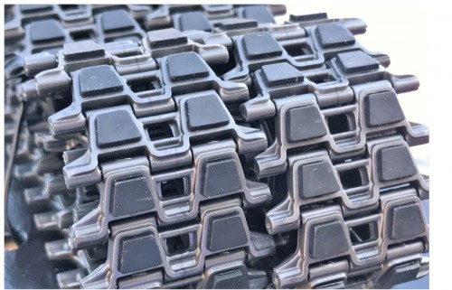

It has pre-assembled, nice quality plastic tracks with rubber pads, a luxury.

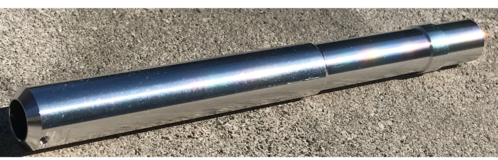

The superb metal barrel is the Late version.

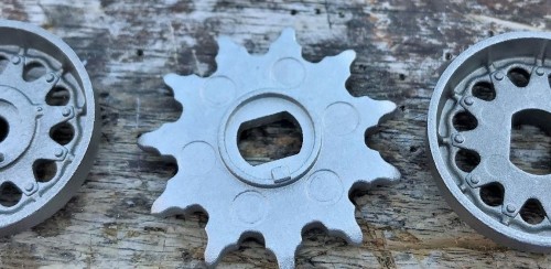

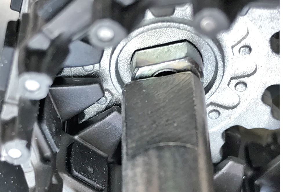

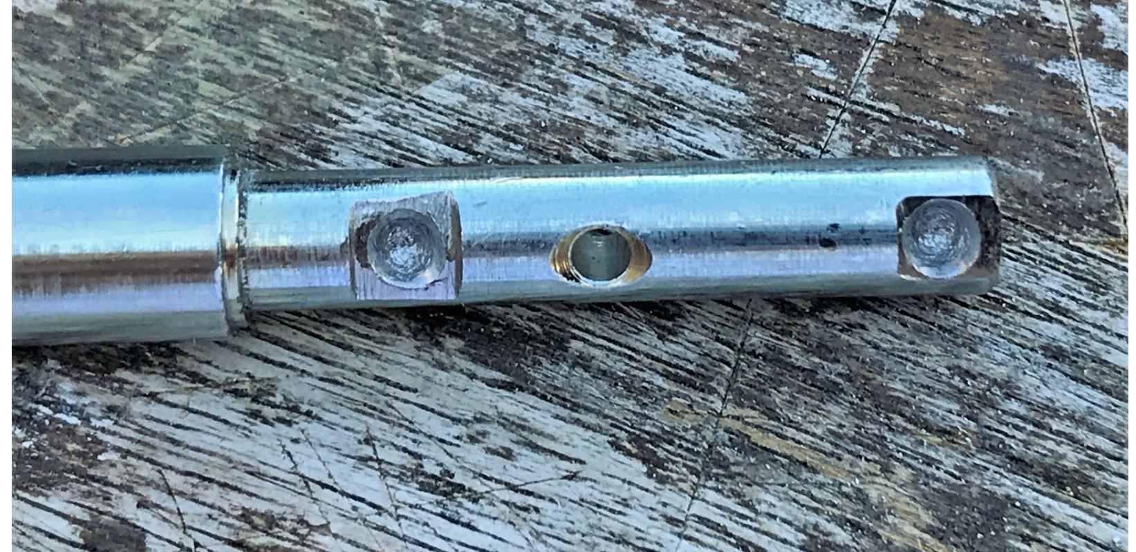

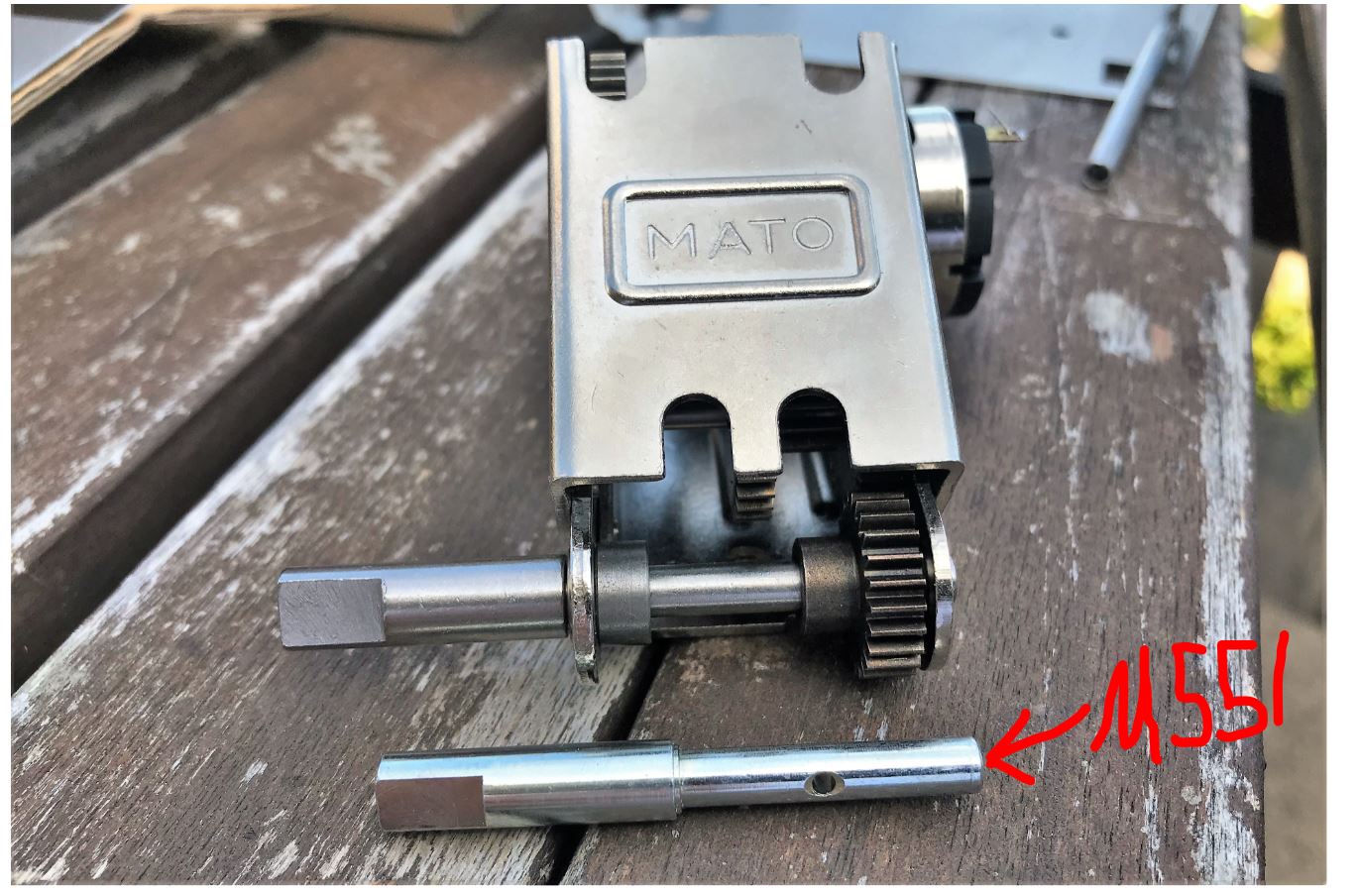

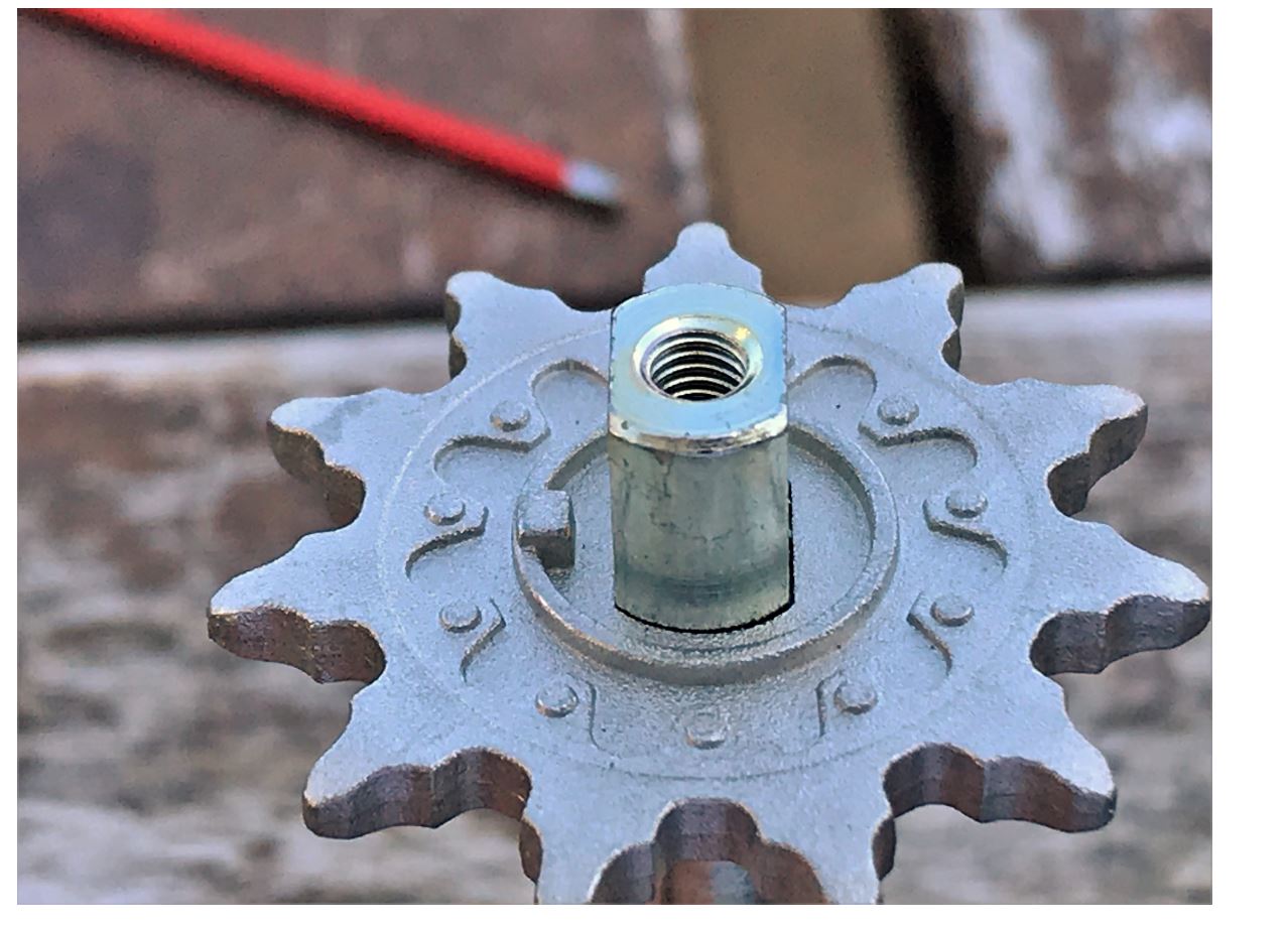

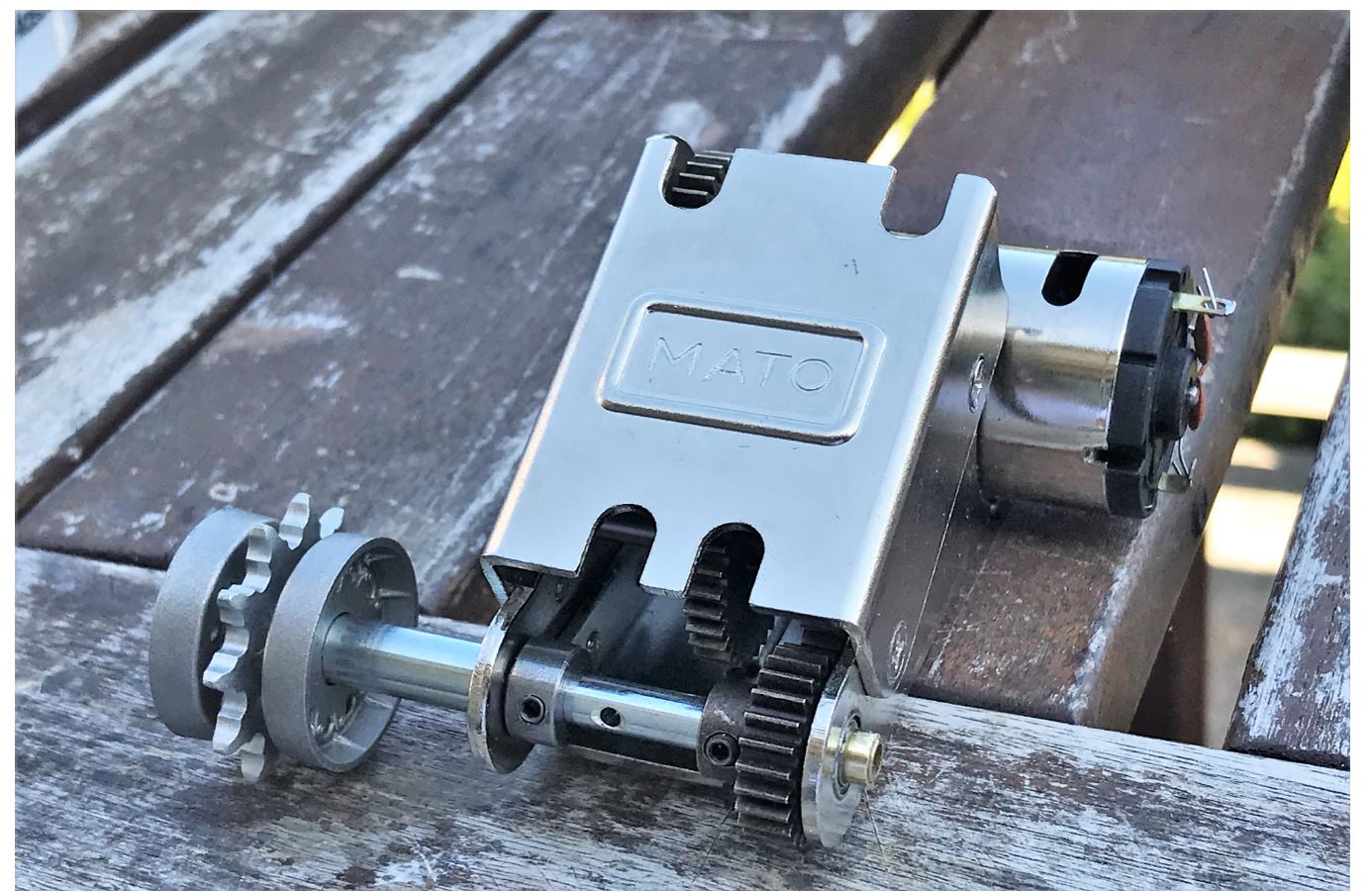

Now, the first thing to engineer is the motorization. The M551 has a small sprocket with a small shaft. A regular Heng Long shaft cannot be used at all.
Thankfully, the Tamiya metal shaft that fits the sprocket is provided with the static kit. It must be reused on a gearbox.

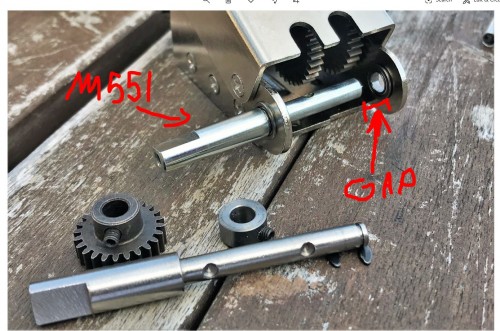

A Mato 5.0 gearbox will be used. These are quite inexpensive for the quality. I paid less than $70 at Matomart during their regular holiday sales, with free shipping. Contrary to HL gears, the Mato gearbox has screws allowing the shaft to be easily disassembled and modified, and supported by flanged ball bearings. The regular Mato shaft needs to be replaced by the Tamiya M551 shown at the bottom.

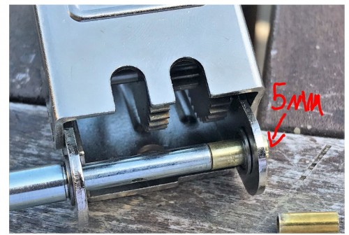

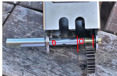

A small issue is that the shaft is shorter and does not reach the other ball bearing. The gap is shown here. They both are 5mm shafts for the gearbox, but the Mato shaft section that connects to the sprocket is about 1mm larger in diameter than the Tamiya.
Unless the builder has access to a metal grinding solution that can produce strait results (which i don't), plan B is an extension of the Tamiya shaft using a 5mm thick brass tube has been created and simply inserted in the ball bearing with some pressure. It is solidly in place.
It is the gear itself that will link the two shaft components together, it makes a perfect joint at exactly the right location. The screw is connected to the main shaft driving the sprocket, the other shaft is just there to maintain balance.
New screw anchor holes are created. It is critical to take the right measurement.

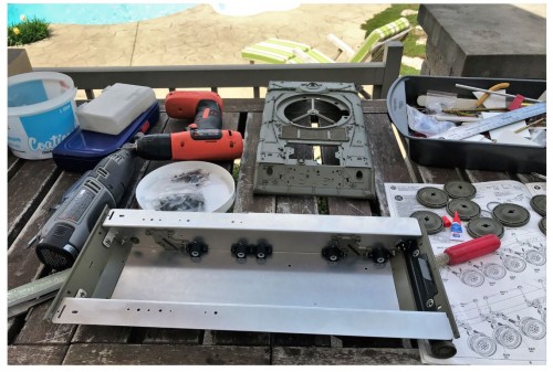

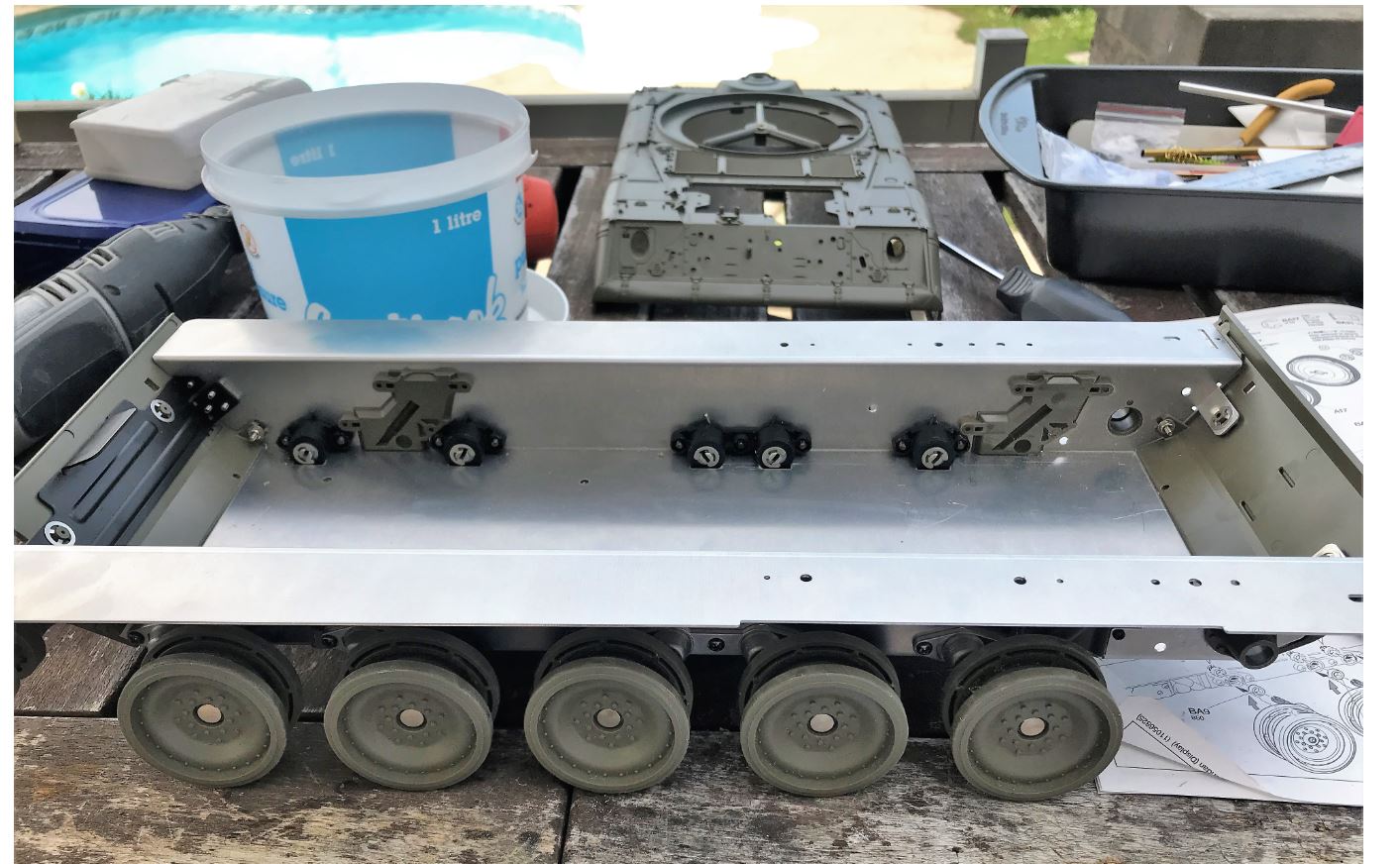

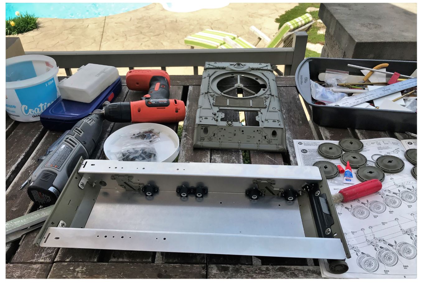

Construction of the main hull and suspension goes very well, no story here. I am not following instructions and leaving small items for later.
I think the road wheels need ball bearings to replace the plastic ones provided by Tamiya. Recommended. I will get the size.
One major disappointed are the molded-in fake dampers provided by Tamiya. I checked the full RC version and it is the same thing. At the price Tamiya is selling this kit, it should have a real dampers.

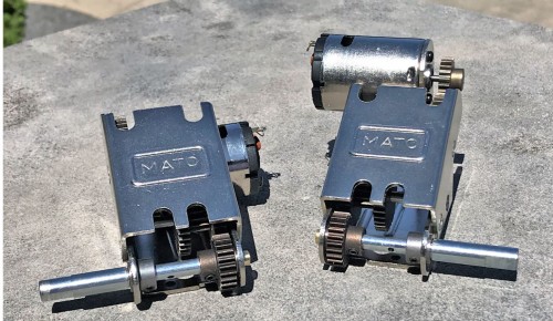

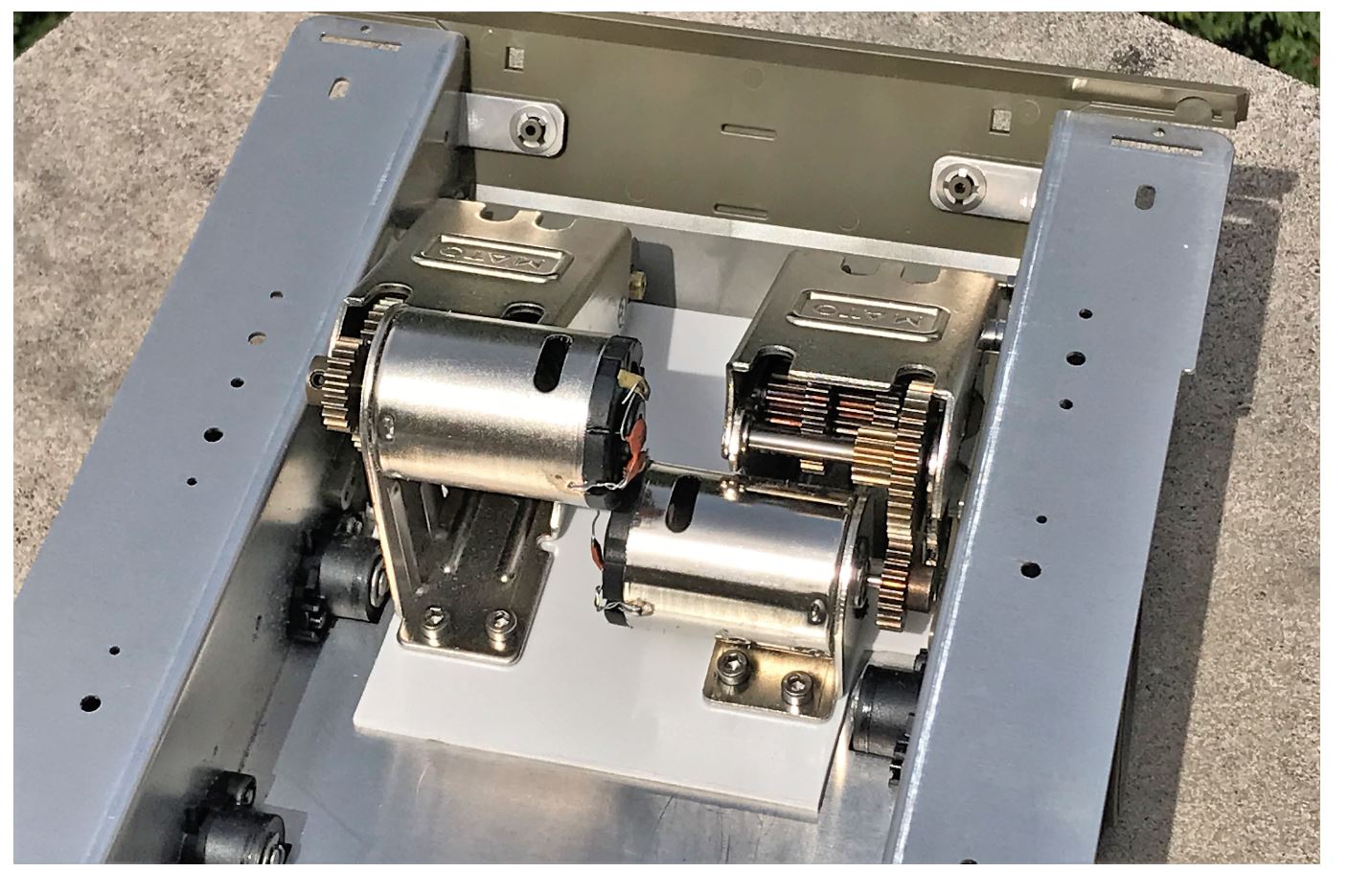

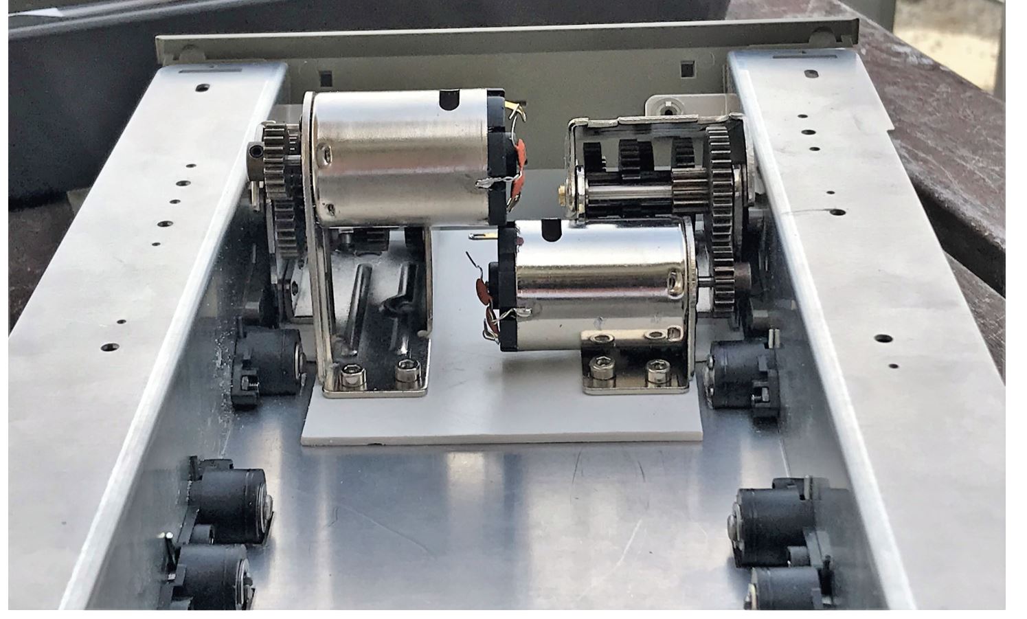

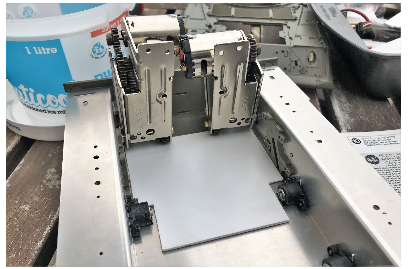

Two modified Mato gearbox are made ready to mount on the chassis.
They only need a 2mm plasticard cushion to be at exactly at the right height for the sprocket holes.
The gearbox are installed with crews going through the plasticard and anchored on the metal bottom hull. I am lucky that the contour of the Mato gearbox shape and base seem to go around the Tamiya rear suspension point. This is luck...
The gearbox are solidly lined up against the plastic part of the fake dampers for a perfect width match of the sprockets with the tracks.

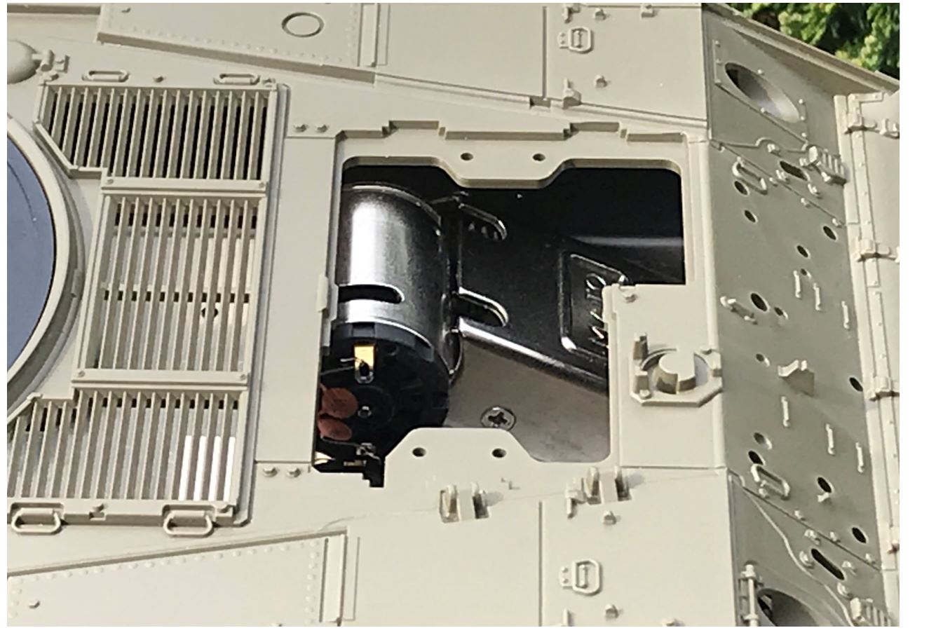

Lots of space is provided for the upper hull, no height issue here. I could have used the smaller Panzer III Mato gearbox if height had been an issue.

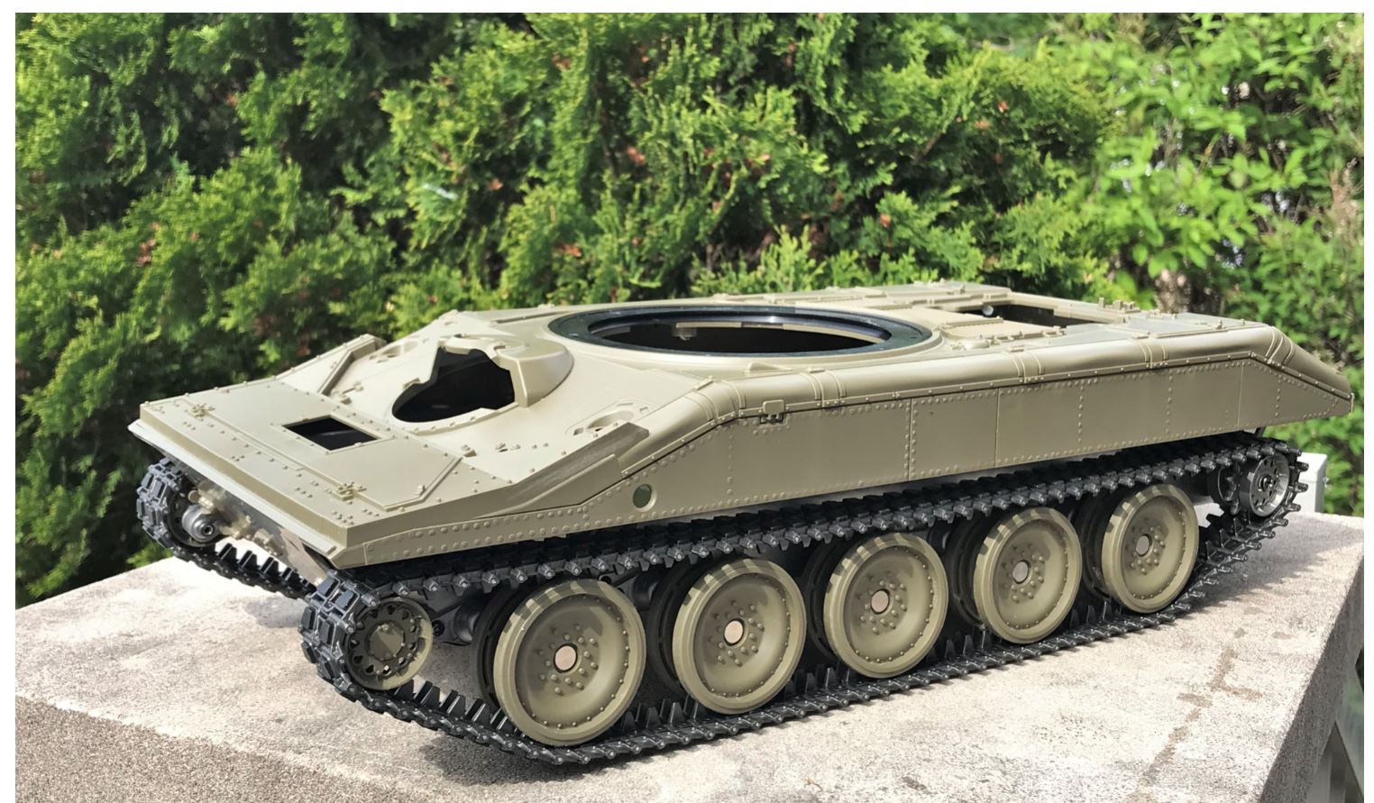

Here is the lower hull with full suspension, road wheels, tracks and gearbox. Looking very good. The build is going surprisingly well and fast.

Great stuff as always, Louis. Couldn't you have milled another flat on the mato shaft and used that? Is there any other difference between the mato and tamiya shafts?
Re: M551 Sheridan Airborne light tank - Vietnam - build
Hi, thank you !
Max-U52 wrote:Couldn't you have milled another flat on the mato shaft and used that? Is there any other difference between the mato and tamiya shafts?
Yeah, that was plan A. But the Mato shaft diameter at the sprocket is about 1mm bigger than the Tamiya as you can see below. It would have been an all around milling job to make it fit the sprocket perfectly centered, and do it twice. Maybe if I had a lathe and knew how to use it, it would have been real simple. But with my 2 metal hand files and some drill bits, the task was daunting. From previous experience, I saw that the slightest imperfection in the shaft/sprocket integration makes the sprocket rotate with a visible wobble. Plan B is what I did but only because the M551 is a light aluminum chassis with plastic tracks. The pressure on the gears is low and the Mato gearbox is really tight and powerful so I think it will work very well. It took me 1 hour to adapt the two gearbox. I would not have done this on a heavy tank chassis with metal tracks.

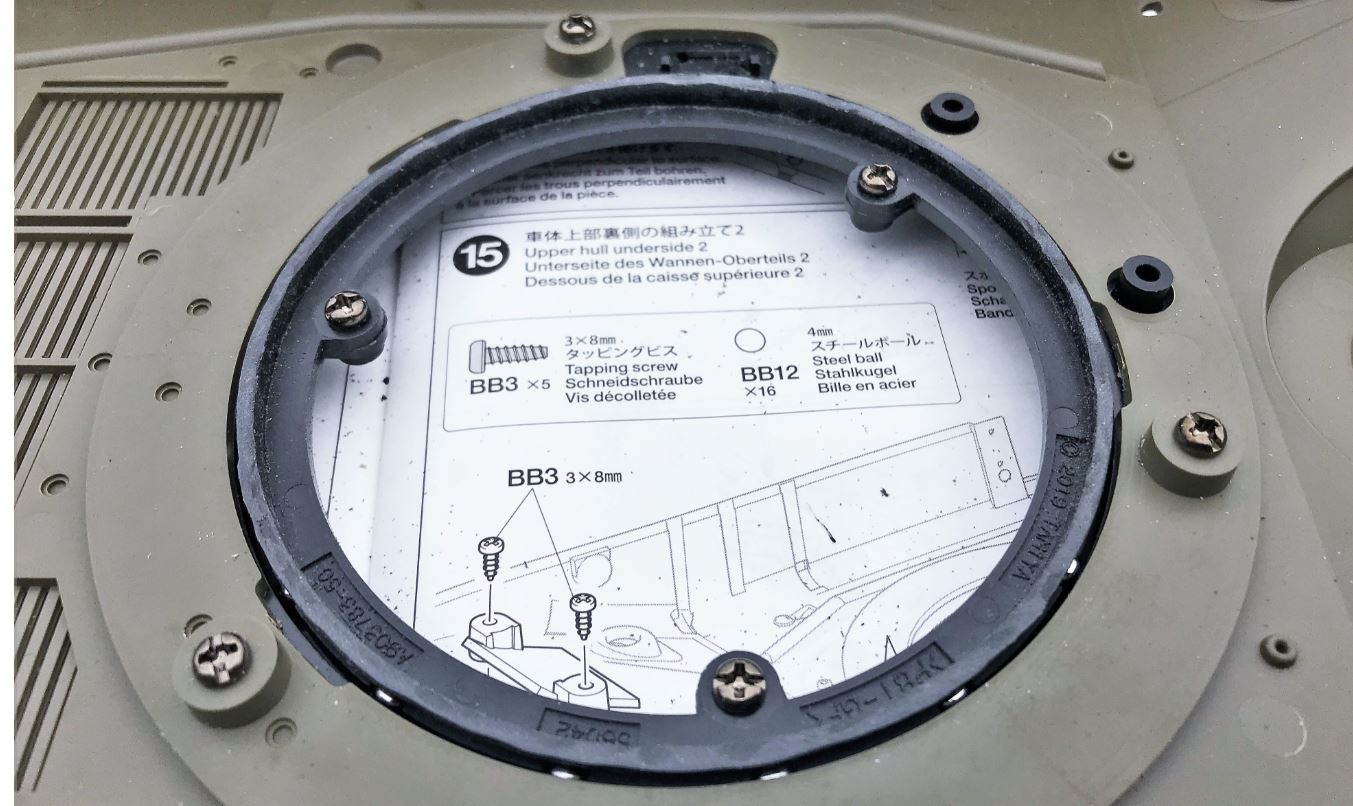

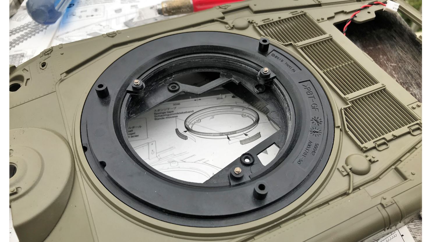

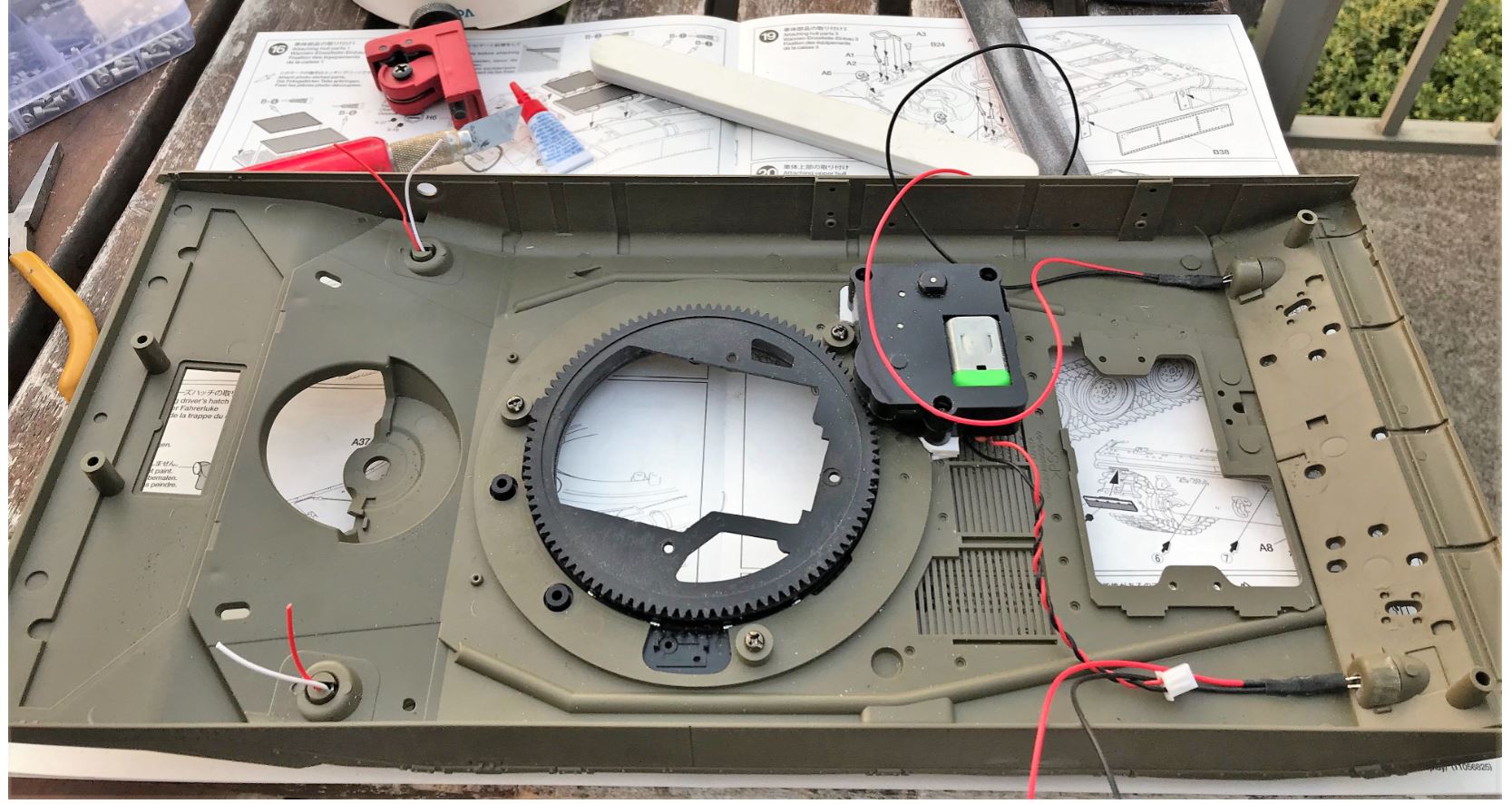

Here is the inside of the upper hull.

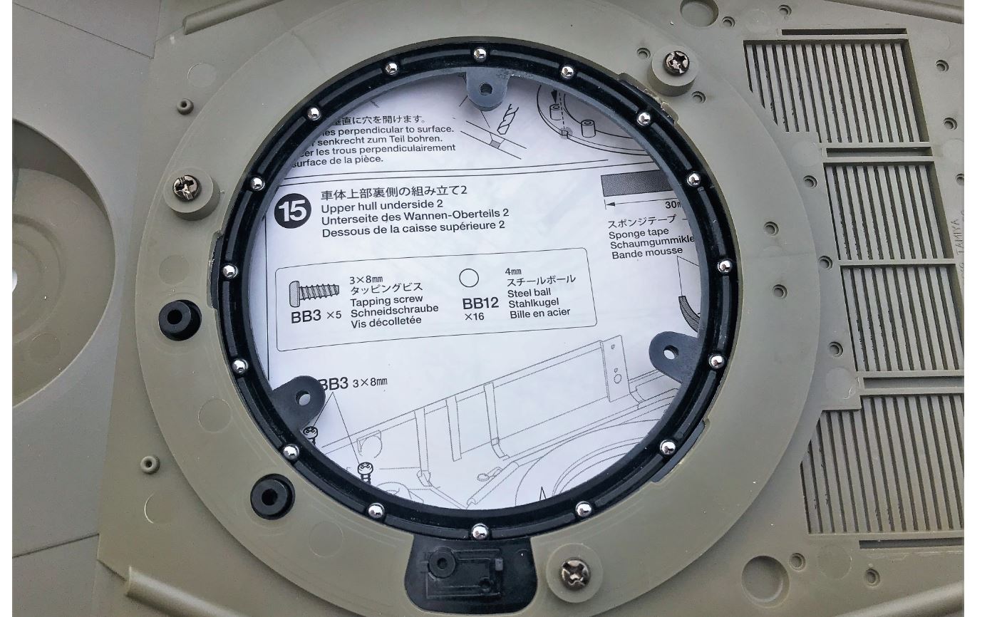

Tamiya provides a gizmo ball bearing turret rotation. Individual bearings are loosely placed in a socket. I personally found the design to be lacking in solidity. Anyone looking at this picture can imagine what can happen next.
The ball bearing are then held in place by the rotation dented wheel placed on top, held with 3 screws. I previously removed the small Tamiya dents to make room for a standard Heng Long rotation wheel to be placed on top.
And what was to happen of course did happen. While pressing against the main wheel to glue the Heng Long rotation on top, the whole thing suddenly snapped out of the upper hull, spreading the ball bearings all over the place. I never found 2 of them, Tamiya providing only one spare. It still works ok but I do not like the concept. It does not feel like the ball bearing are actually turning inside. Rotation is provided by a Heng Long unit installed on a custom base.

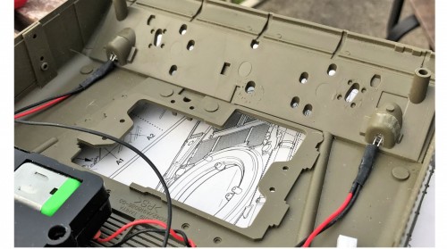

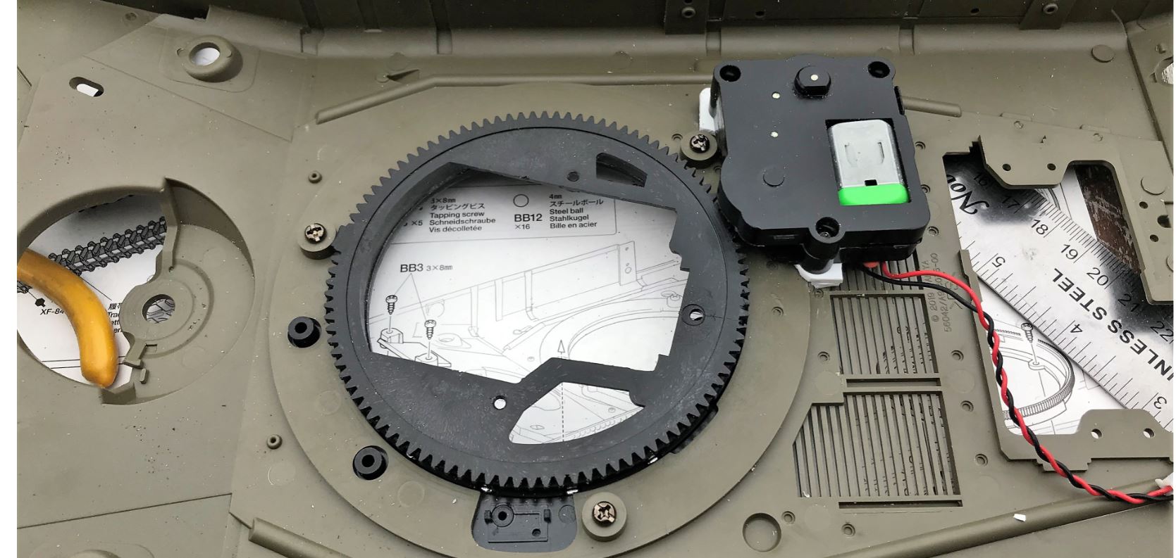

View of the top where the base of the turret will come sit. As you can see, the standard Heng Long rotation wheel is a perfect match to the size of the turret ring.

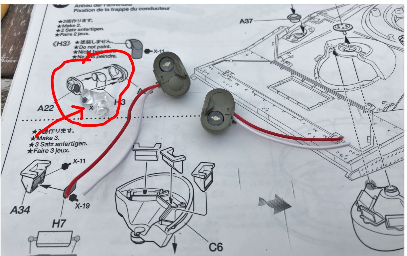

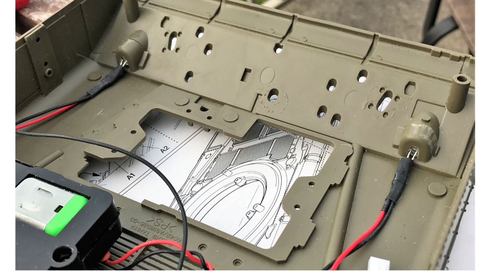

A simple $2 RC LED kit can be used for head and tail lights, here the tail lights.

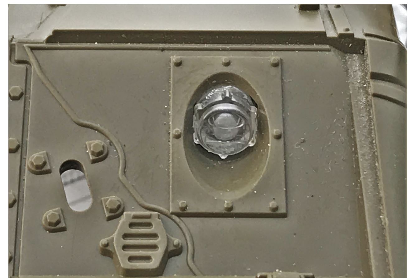

Tamiya provided the tail light in clear plastic, a questionable decision as it does not really help with the painting at all.

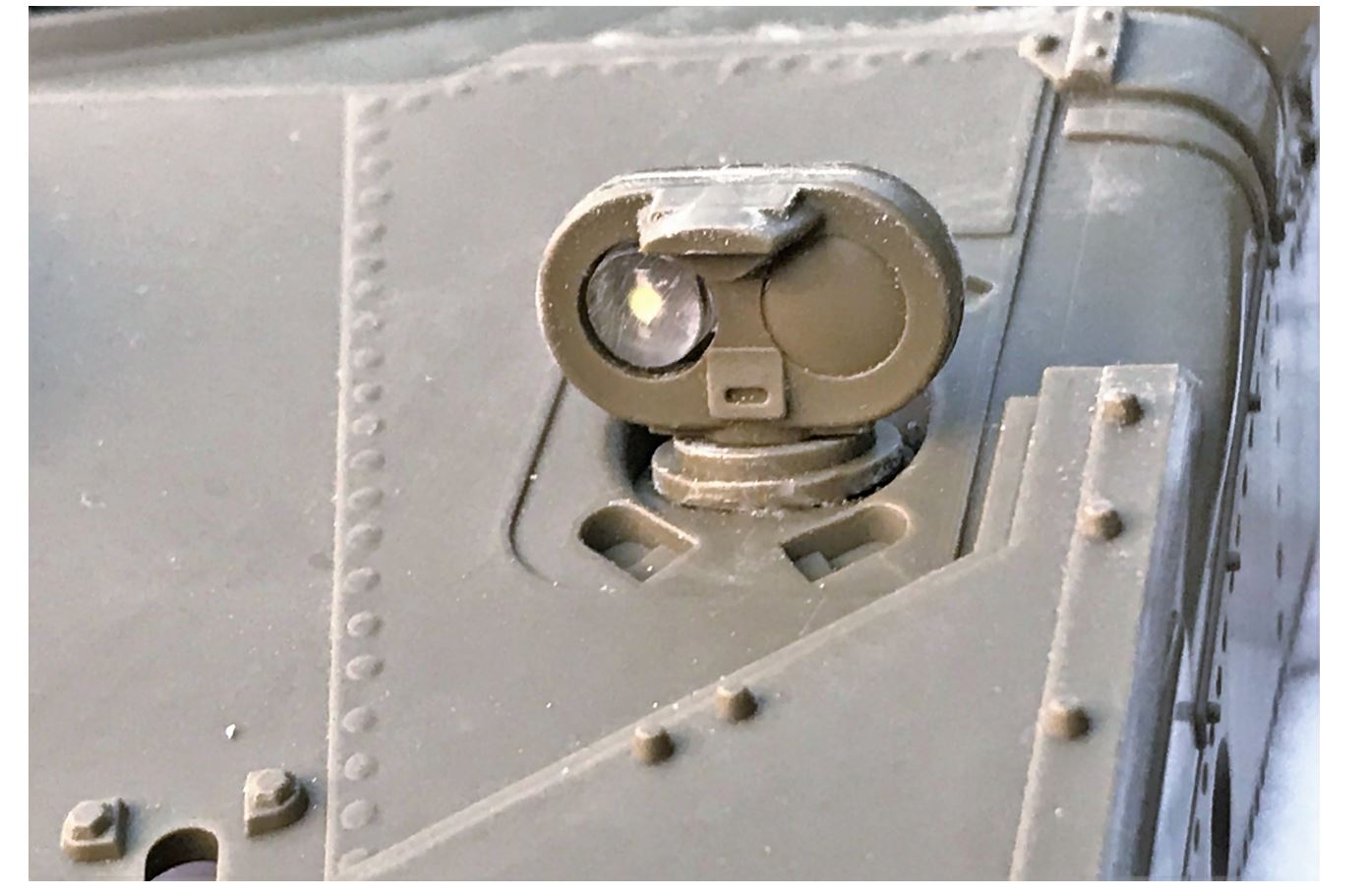

The headlights are excellent, empty so that it can be provided with LEDs inside. I reused some LEDs from an WPL pick up with the lens flattened and then polished, the resistor will be placed inside the hull later. I wish Tamiya could sell these headlights separately for my other builds. Notice (in red) that Tamiya provides a clear part that can be installed inside the headlights with the LED connected from under. But I preferred to have my LEDs directly illuminating the front of the tank instead of relying on reflection through the clear part. For sure, it is simpler to use the Tamiya clear parts.
Overview of the interior of the upper hull, about $20 of added material for turret rotation and lights.
