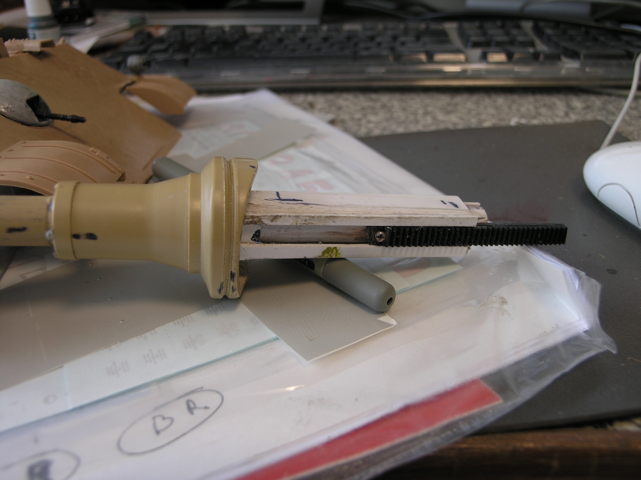

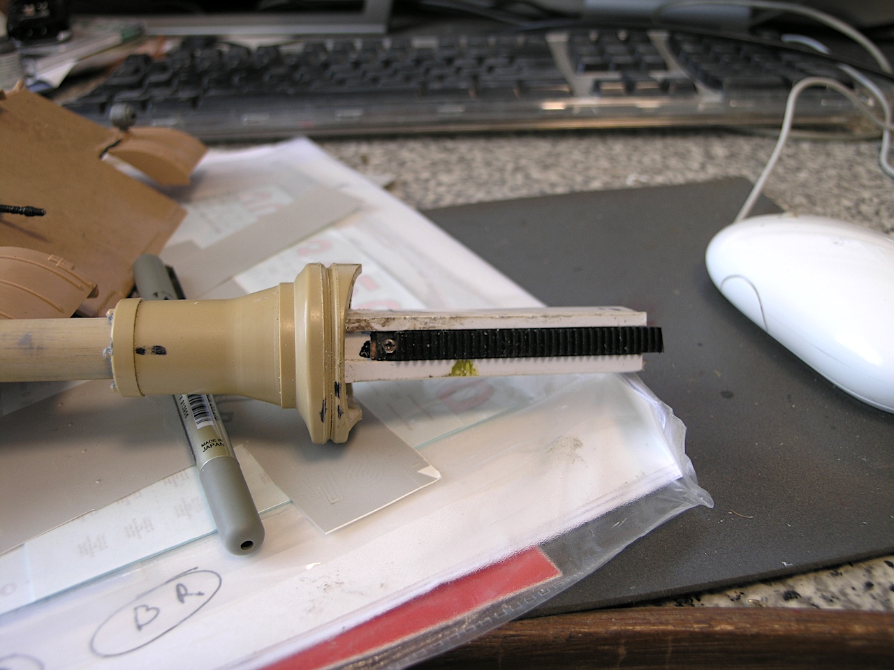

Why don't you make one , rc robotic shops or Ebay have all the parts needed. Here is one i made for the King Tiger

If you make one its easy to get scale recoil distance

The servo bracket goes on the square support ,just need to fit a cog to the servo and check position for clearance.
