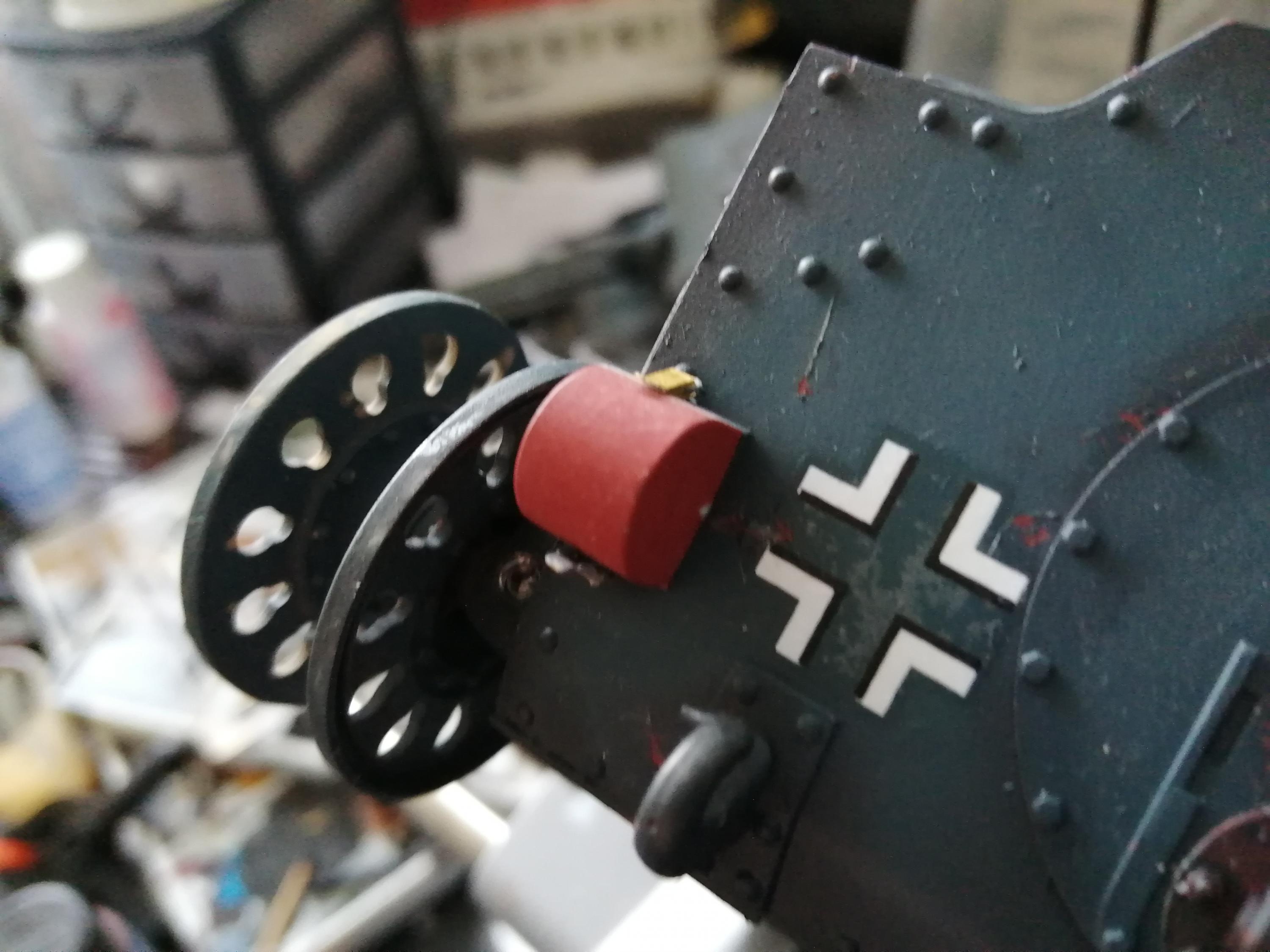

Every time I attempt any photo etch work, my admiration for BarryC and his fellow magicians takes another leap upwards. They can take some brass sheet and rod and turn it into an engineering marvel. I take some parts that are all cut out, with the bends marked for me and then struggle to put the bits together! My latest attempts are the clips that retain the covers at the rear. I think the covers are over the adjustment gear for the idlers. In theory, they should be removeable, but I think I used too much superglue to fix them. There are 4 in total here. I have three more to do for the central cover.
The paintwork needs a bit of attention but hopefully it will all turn out OK in the end.
Richard

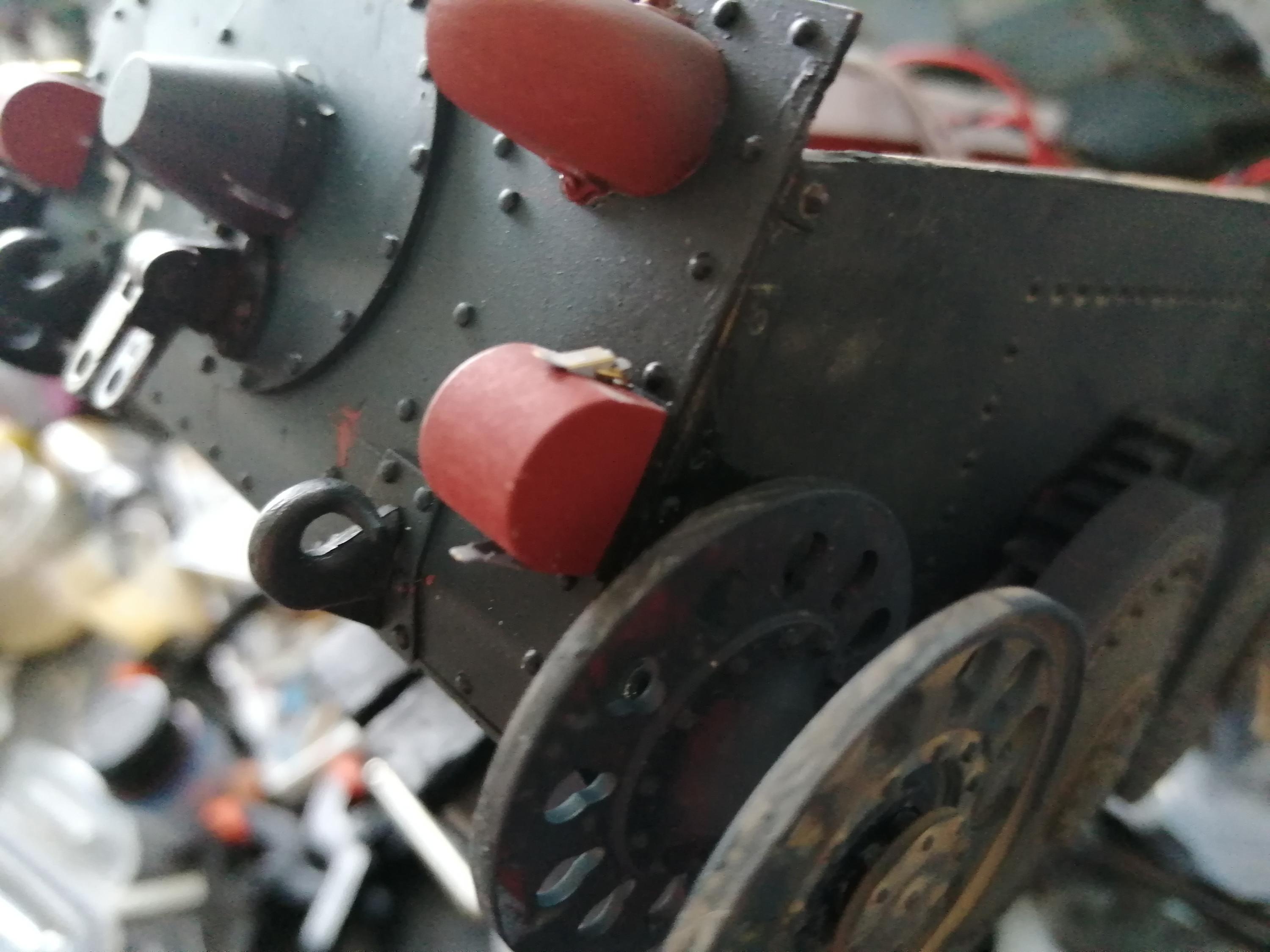

I have been playing around with some weathering, possibly a bit too much in places. To get an overall picture, I went to fit the tracks. I thought I had measured them very carefully, but found I was one link short. After a few more punctures to my fingers, this has been corrected. This is what the chassis left hand side looks like, tracked up.
Richard
