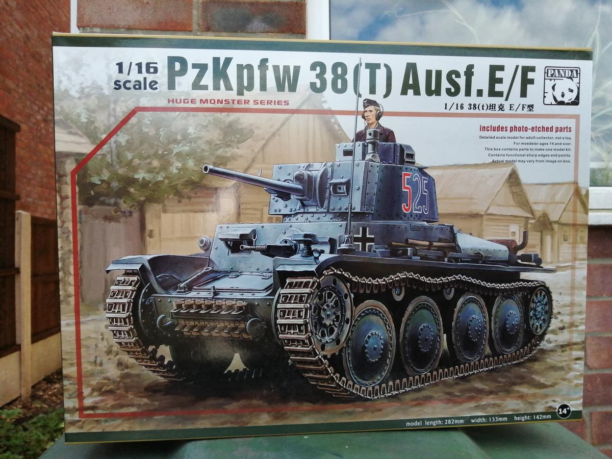

I have had this sitting on a shelf for a number of years now.
During that time I have added the 35rctank.com conversion kit and later the Spade ace metal tracks. In the last few days, I have received a Henntec track tensioner. (Excellent service from Guido).
I have decided it is about time that I actually did something with it. I was and still am most impressed by Carl's award winning work, from which I shall be shamelessly be pirating as much information and tips as possible. (He is aware of my intentions!)
I really did not fancy my chances of drilling all those plastic track links, hence the metal ones. That has not been totally straight forward as there is an inconsistency in the castings, some being very tight fits. I filed them down where possible. They are fairly soft metal so I am hoping that repeated flexing will ease them off a little. I don't think they will stand up to very heavy use, but I am not intending that. I started using by using the wire that was supplied, but changed over to using pins which I cut down after fitting. According to the kit instructions, there are 186 links for the 2 tracks, so I have followed suit. Some very sore and frequently punctured fingers later, the tracks are assembled. It now remains to colour them up initially with gun blacking. I have had a look through the forum for technique for producing a realistic overall finish/weathering without success. If someone can point me at painting and weathering metal tracks I shall be grateful.

I have the instruction leaflet with the conversion kit. Apart from the tracks, all I have done so far is have a quick scan through both this and the actual kit instructions. All the kit parts are still sealed in their plastic bags. When I have cleared the decks in my work room, I shall study both documents in depth as well as going through Carl's thread again, before anything gets opened. My wish is to produce something that is as close as I can get. It will be difficut as the bar has been set very high.
