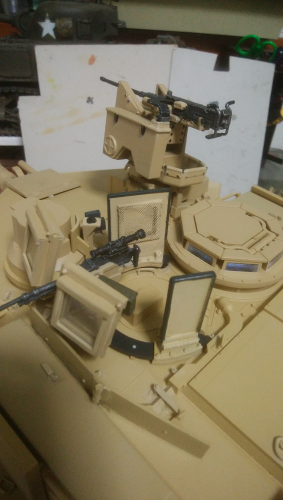

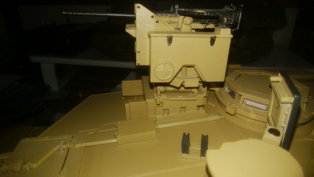

I continue to detail Tamiya M1A2 Abrams little by little. Now that the M153 CROWS mount is ready for installation, I used an LED chip to synchronize the flicker and sound of the M2 machine gun. It is a video of M2 machine gun.
There are still many parts to detail in this model. The black one on the turret is resting when CROWS is folded sideways and stowed.

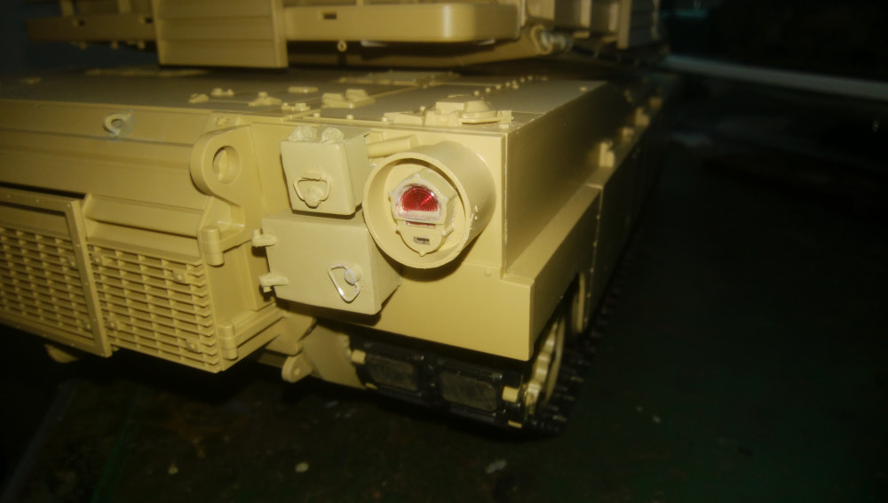

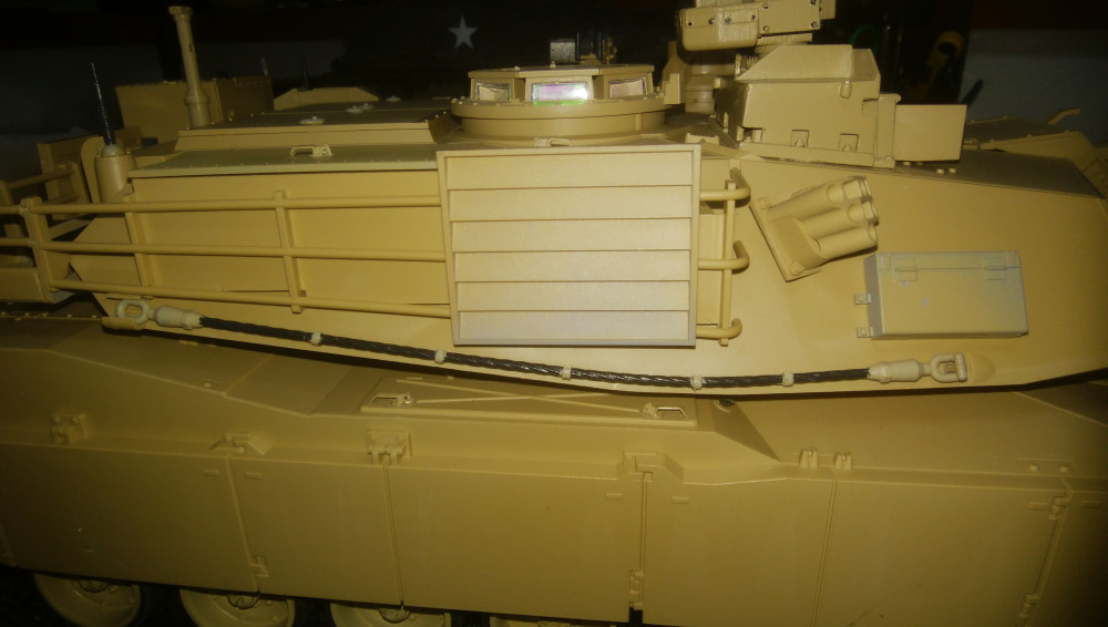

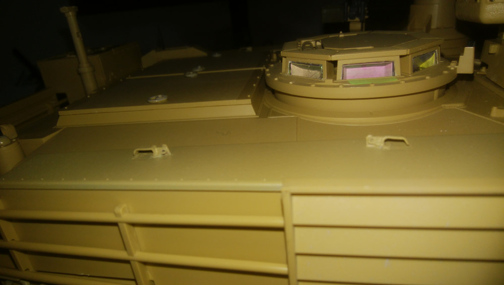

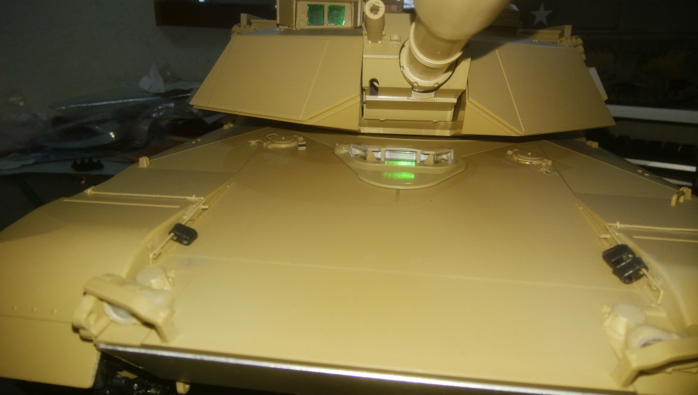

I have rebuilt the simplified fender holddown torsion bar by integral molding. In the real tank, there is a case that the side end of the track is inserted into the bar as a weight to suppress the bar and the fender from jumping up.
I added a driver's hatch stopper. The handle of the filler cap is a simplified integral molding, so I cut it out and remade it with brass wire.
Many handles of the original model are integrally molded or simplified and have strange shape. The toolbox handles at the top and bottom of the turret are simplified as a one-piece rectangular projection. In particular, if the lid of the toolbox below the turret is a hinge type, the lid can not be opened depending on the position of the turret, so turning this handle will unlock the internal lock and the entire lid will come out. These handles are unique in shape, so I rebuilt them.
The number of handles in the Abrams tank is not more than that of the Type 10 tank, but since there are still many, I have no enthusiasm to remake everything, so I remake only the handrails that stand out to be molds.

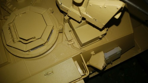

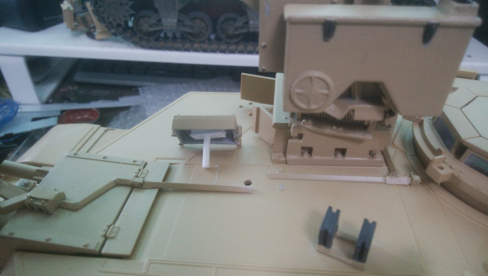

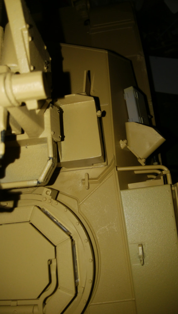

It is a continuation of detailing up. I added bolts at the top of the side skirt. These bolts will not be visible if I attach the Explosive Reactive Armor to the side skirts, but now I have no perseverance to add up there.

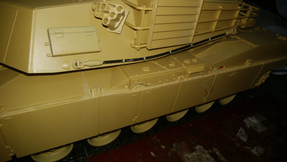

In this model, the triangle cable duct near the range finder is interrupted halfway. It is a unnatural and strange shape. In the old 1/35 Tamiya M1A2 model, there are some terminal boxes at the end of the cable duct. The cable duct disappears on the 1/16 model. This is an obvious omission. It has nothing to do with the strength of RC tanks.
After all, I scratched the cable duct with a plastic board. I added a tank infantry phone box and a slave cable terminal box.
I added a remote control terminal box and cable to the side of the CROWS machine gun. It looks like the feeling of detail has improved a little. The world of self-satisfaction! I will install the anti-sniper gun barrel coaxial gun (3D printed product). This has not been fixed to the shield yet and has been temporarily placed, but if it is installed, it is also necessary to make a cable duct that leads to this.
However, this cable duct needs to be movable so as not to prevent the barrel from moving up and down.

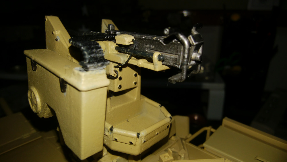

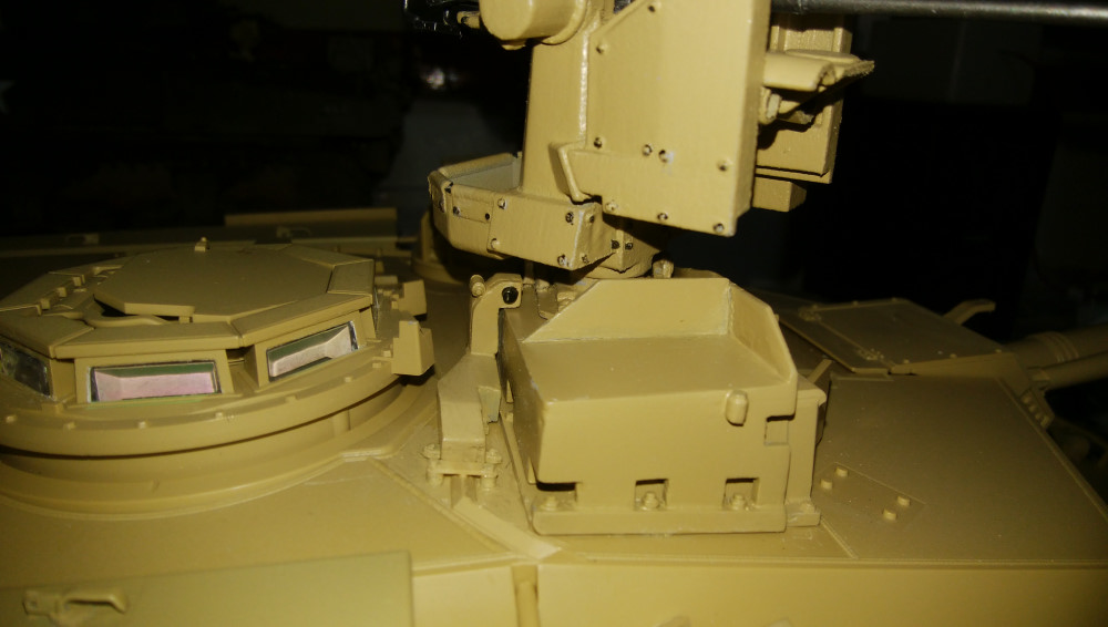

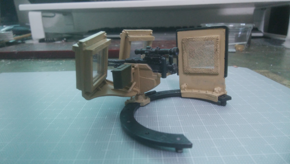

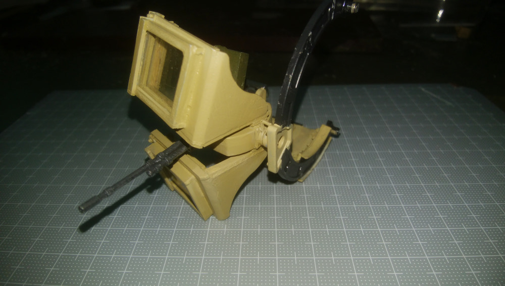

For the detail improvement of the Tamiya 1 / 16?M1A2 Abrams display model, I started to work around the Loaders hatch. There are many abbreviated and simplified parts here, but I need to decide how extent to remodel. I would like to remodel up to the extent at least the level expressed by M1A2 of MengModel. I referred to this real tank photo published by MengModel.
A shield that surrounds the Loader's M240 machine gun area. Because the protective shield in front of the machine gun has a fairly special shape, it took time to fully scratch. Thick bulletproof glass is in both the outside and the inside. The bulletproof glass is slid in from the top, and the top is held and bolted with the cover. I made this with plastic material. Since the boundary between the vertical and horizontal parts is an oblique cut shape, the plate material is bonded vertically, the triangular plastic bar is bonded to the corner, and the diagonal cut is made from the outside. I used a 1.7mm transparent plastic plate for the bulletproof glass part. There is also a protective shield on the side of the machine gun. Inside this shield, a diamond mesh is attached over the bulletproof glass. According to the commentary, this wire mesh protects the glass from errant feet stepping on it when this shield is folded down.
Since this machine gun is often attached with a sightscope, I also made from scratch it.
In addition, a protective plate is attached to the left and bottom of the gun seat. I have made from scratch these parts.

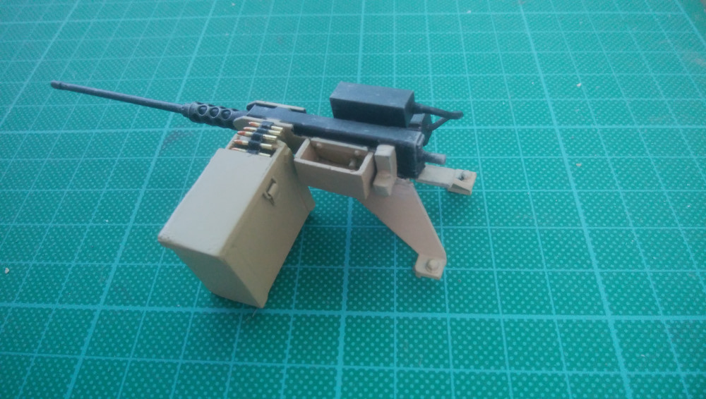

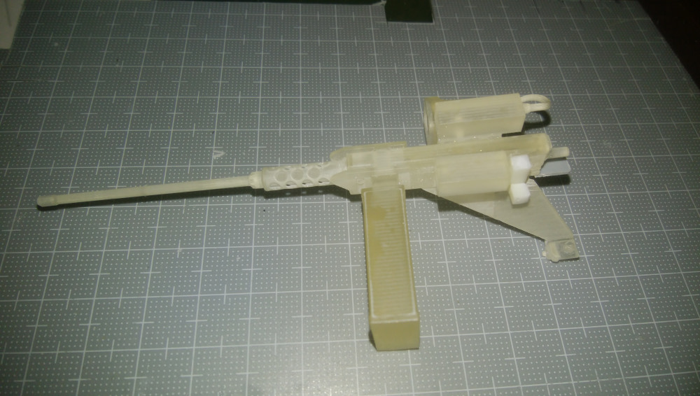

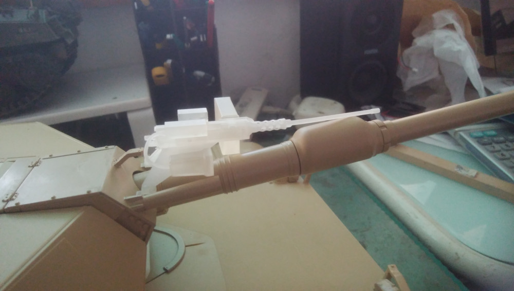

This is a coaxial machine gun that I got from Shapeways of 3D printer.
However, the size and shape of the ammunition box are strange. The width is narrow and the length is abnormally long to store 12.7 mm ammo. The upper part of the cartridge receiver is not open. I can not use it as it is, so I cut them and scratch it again with a plastic plate. ?I made amunition to cut a 1 mm brass rod and bite it into a mini router to form a tip. They were placed and glued on black 0.3 mm t plastic strips at equal intervals, and a strip of printing paper was applied on top of them.
If you need flexibility for ammo belt, make both sides of paper instead of plastic. This method is useful. (More sophisticated 1 / 16th scale ammunition is also available but expensive.)
Because the barrel moves up and down, this cable duct also needs a hinge in the middle. (Same for actual tanks)
In addition, this model has a structure that removes the upper part of the turret, so the junction box of this cable duct can be removed.
I thought that this machine gun would also be able to emit sound synchronously and that the light attached to the machine gun could also be turned on (USM-HL-2 would be easy to add these functions as long as wiring and LED could be installed), but as for now I will refrain from working so hard. I would like to conclude by making an additional bustle rack at the rear of the turret and modifying the useless part of this model.
