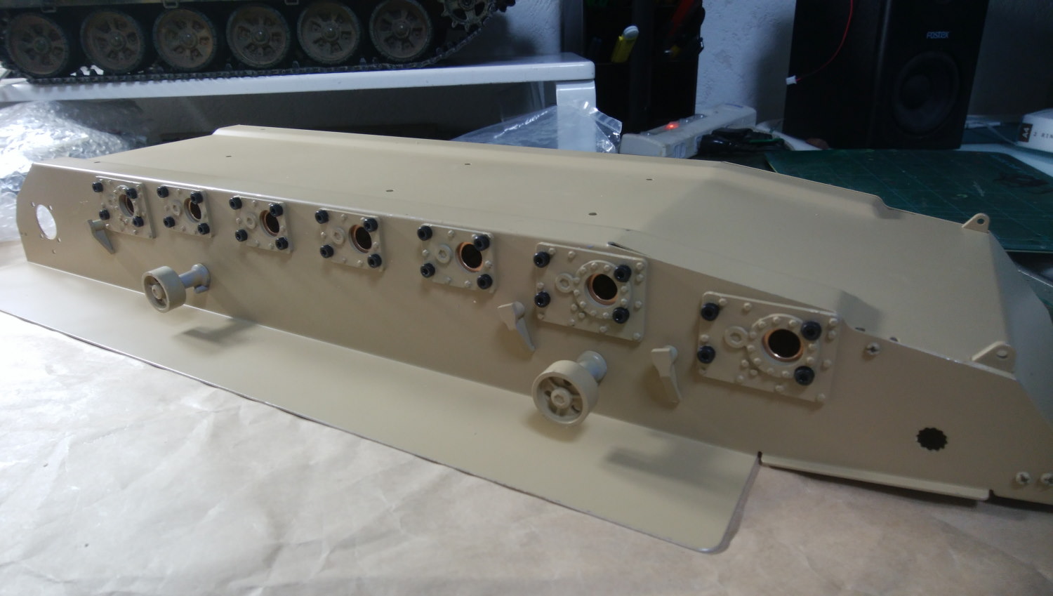

Hello everyone.
I tried assembling a lower hull (road wheel) at the beginning of remodeling the Tamiya M1A2 Abram display model to a radio control. First I sprayed a metal primer and a lacquer paint (Tamiya's light sand) to the metal lower hull. Tamiya has recently released lacquer paint, and its coating seems quite strong.
Because it is made by Tamiya, it was able to build a tightly combined structure with enough strength as RC tank without any stress. In the article of Armor modeling magazine, the black cap screw which fixes the suspension mount of the road wheel was reworked since its shape and position are completely different from the real tank, but I will not stick to that considering the strength. Although it is a part that can be seen from the outside, I will keep that part inconspicuous by painting. (It is true that I have no guts to remodel to that extent.)

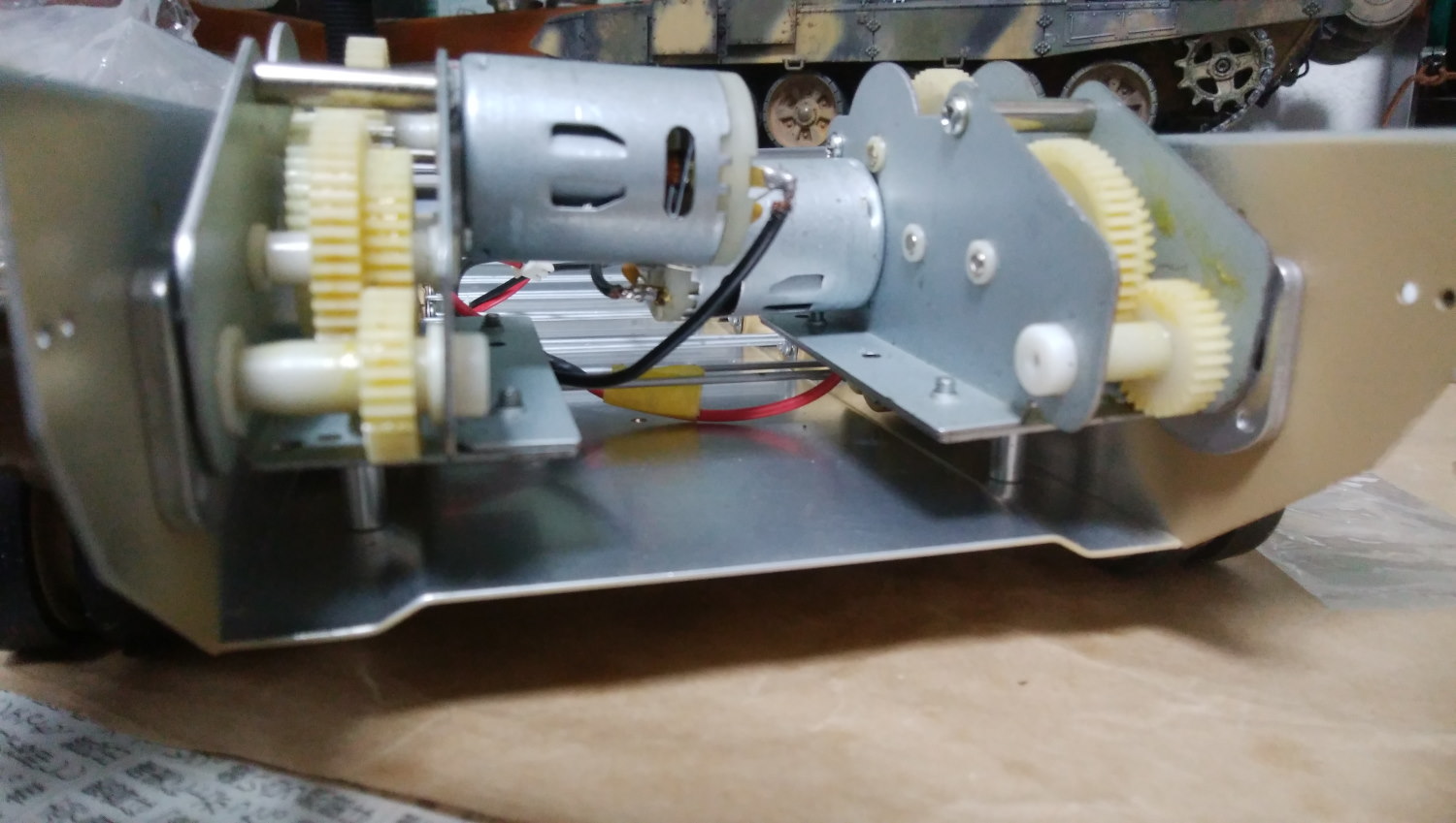

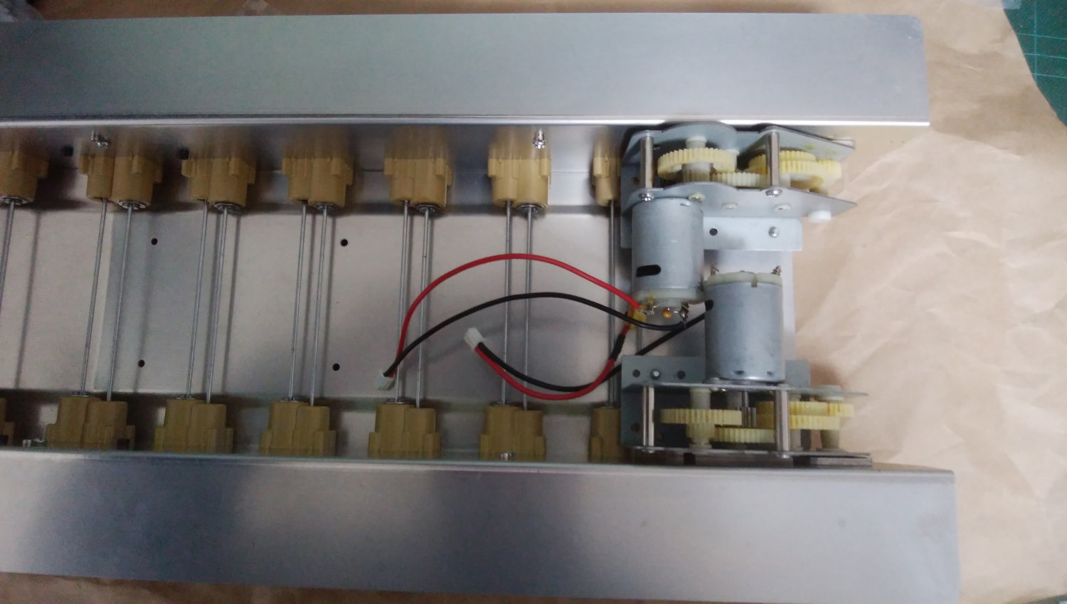

I tried to see if the spare HengLong plastic gear fits into this lower hull.
This is a state in which the gearbox is raised with aluminum color and temporarily placed (unfixed). Centering of the drive shaft seems to be no problem. If 360 ° turret turning (slip ring) is adopted, batteries and controllers must be placed in the lower hull.
Somehow it is likely that all parts will fit within the lower hull. If you use the speaker box of the full operation kit, you only have to put the battery and the controller inside the turret.

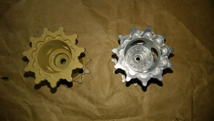

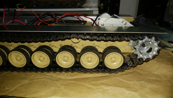

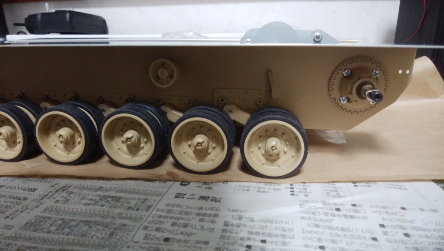

I got a sprocket wheel from "MatoToys" to match the axle of HengLong? drive gear. The painted one on the left is of Tamiya, but the hole in the wheel has not penetrated. The right one has a hole exactly like a real tank. As this part is visible from the outside, I think whether it is important about the details whether this hole penetrates or not.
What I was most interested in was whether this Sprocket fit Tamiya's genuine track, but it matched without problems. I can not judge whether it will match if I do not finally check the driving performance, but for the time being, I feel relieved.

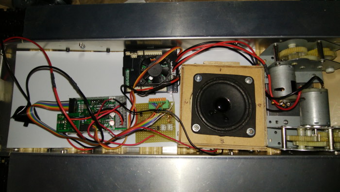

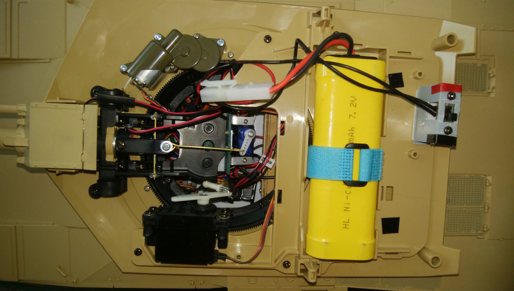

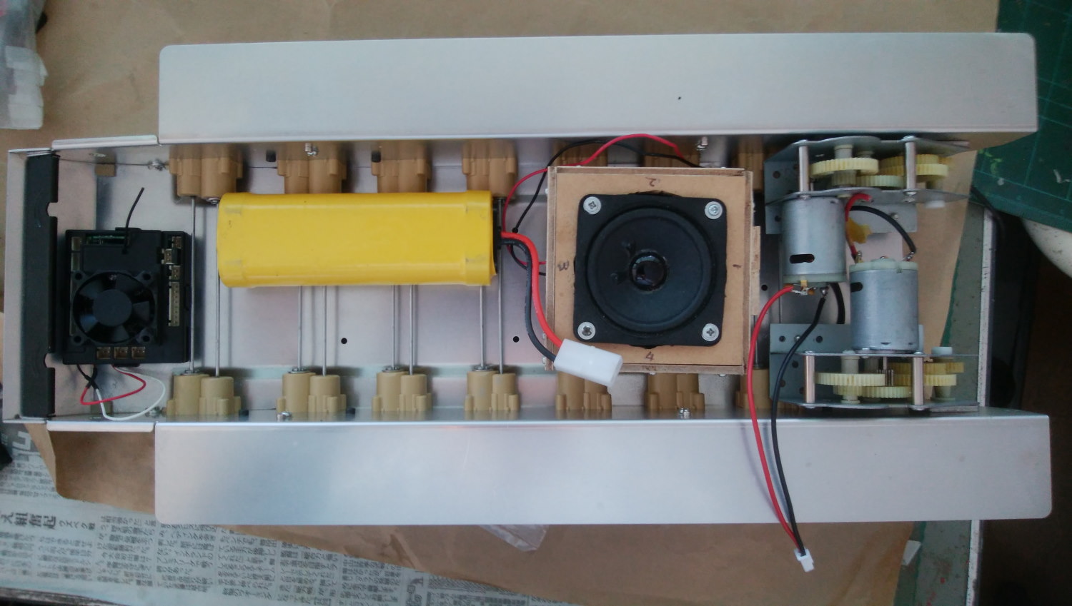

I installed the USM-HL-2 sound board and the TORRO RX18, but as a basic concept, remodeling is limited within the range where it is easy to remodel Tamiya genuine full operation.

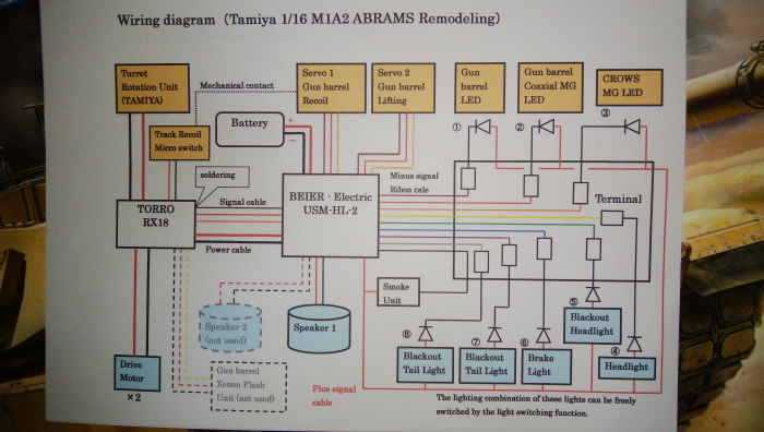

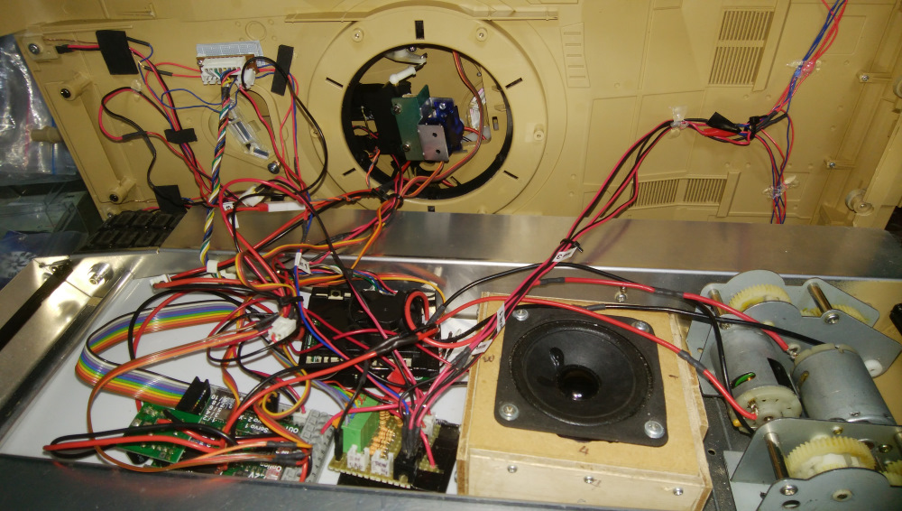

Wiring was done as follows.
In Tamiya full operation, tail lights and headlights can be switched to blackout (BO) headlights, BO brake lights, BO taillights, etc. in various ways so-called camouflage mode, but this USM-HL-2 is also possible with the "light switching function". Lifting of the main gun was also possible with servo control by this boad.

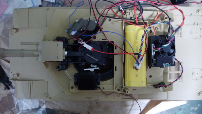

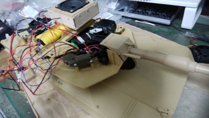

Temporarily, I installed these for operation function check. The servo for main gun lifting is a old servo that was used in RC helicopter. It is about 30 years old, but works well.

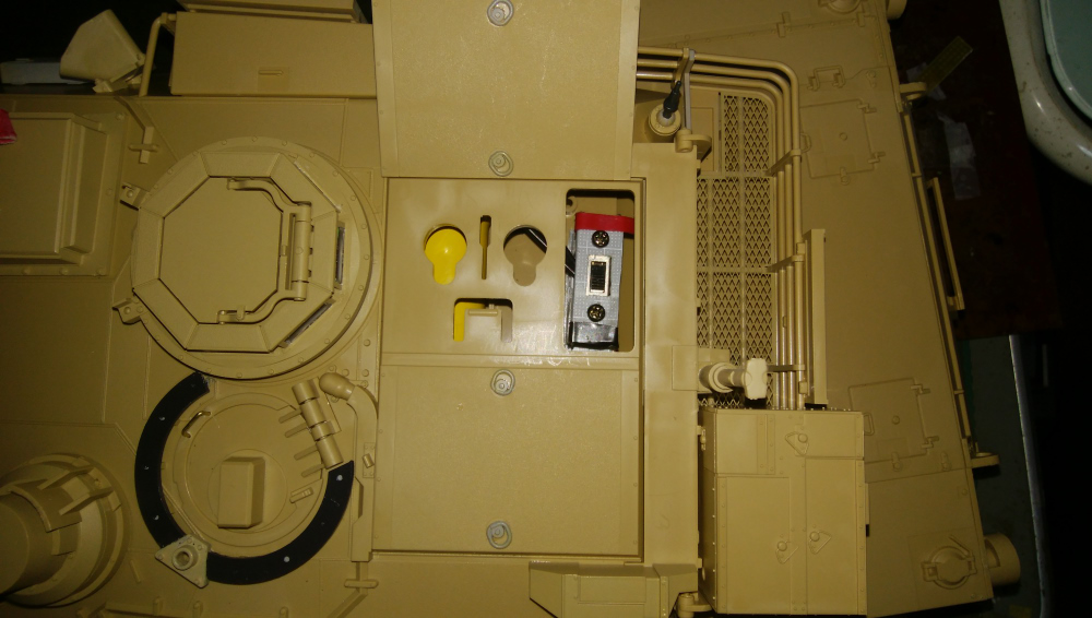

All except the battery are in the lower hull.? The main switch has not been fixed yet and is left floating.

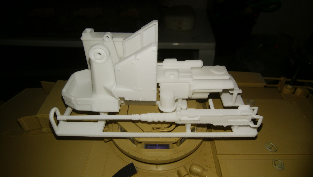

In addition to the coaxial machine gun, I am planning to make the CROWS on the turret also able to emit light.

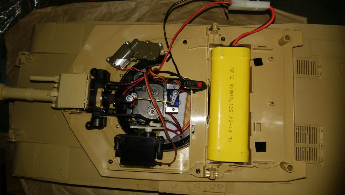

- Gun lifting unit, barrel recoil unit, turret rotating unit, and main switch
- DSC_1332_01.JPG (74.45 KiB) Viewed 14579 times
- TORRO RX18, USM-HL-2, speaker, and output terminal in Lowe hull
- DSC_1327_01.JPG (87.67 KiB) Viewed 14579 times
- Wiring diagam
- DSC_??1330_01.JPG (86.22 KiB) Viewed 14579 times
- DSC_1329_01.JPG (87.1 KiB) Viewed 14579 times
- Sprocket wheel TAMIYA(left) and MATO(right)
- DSC_1324_01.JPG (66.03 KiB) Viewed 14579 times

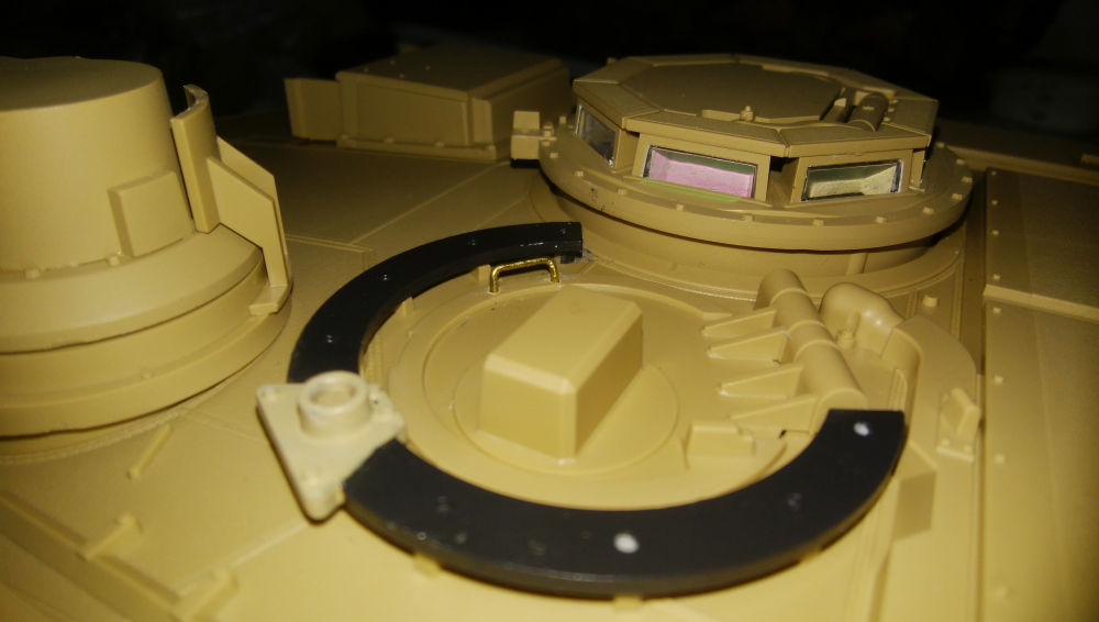

Well, this time I assembled the kit as it is, but despite the fact that this is the latest 1/16 scale Tamiya tank, I am completely dissatisfied with the details. This is not completely out of the so-called TOY zone.
First of all, the external handrails and handles are molded, and the shape is quite rough. I think that it is unavoidable if it is a complex shape, but even handrails and hooks of simple shape are expressed by molded strange shape. I feel that the strength is considered too much in the radio control.
I was forced to remodel this handrail immediately.
