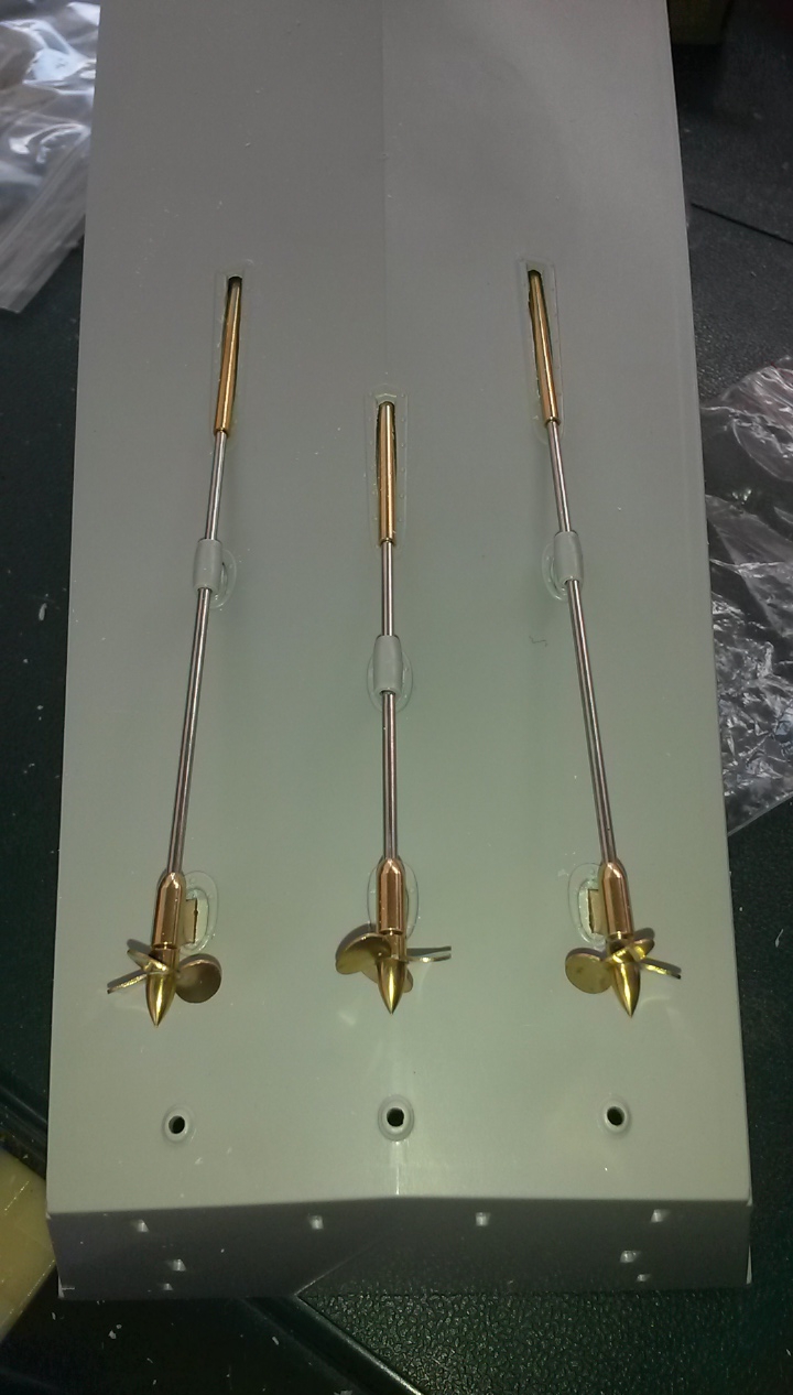

Here's a few shots of the running gear being installed...
The motors and stuffing tubes from inside the hull. The stuffing tubes have bearings installed where the shafts enter, as well as the oiling tubes already installed. Here's the underside. And a different angle. The deck is temporarily installed to check the positions for the rest of the electronics. Just a quick note on the running gear kit. All the pieces are really well made and assembled. All the machined surfaces are smooth and the fit on everything was just fantastic. It did arrive missing the stuffing tubes and control arms for the rudders, but after a couple of quick emails, the seller had replacement parts on their to me.
I also ordered a flexible push rod and some connectors for the rubbers, so I had a bit of a wait for these. I started on the deck fixtures, doing these up as sub assemblies.
Here's a picture of some of these stacked up, just to get an idea of the overall look. I ordered a couple of the Mk XIV torpedoes just to give it a different look. I had came across a couple of pictures of boats with these torpedoes and liked the look. One of the picture captions said that the crew had done some swapping with a passing submarine for the torps.
Here's the interior layout I came up with. Bill

Yeah, the running gear was extremely well made. I really had no complaints with it, other than it would have been nice to have a two armed control arm to make it easier to hook up the three rudders and the push rod. The props are held on with small grub screws as well as the control arms and motor couplings. I still have to file a flat on the shafts to make a better grab spot for the screws. I'm using thread lock on all the screws to hopefully avoid losing something.
The one piece hull is definitely a plus when doing the r/c conversion. Makes it SO much easier. I've been working on it for several days now, but just getting around to posting some pictures. It's not really going as fast as it looks!
I have tried the hull and engines in the tub a couple of times while I was waiting for the rudders. It really moves some water! Looks like it'll move along pretty good ones it gets loose on some big water. Right now I'm doing some more painting on the deck fixtures, and getting ready to paint the hull. It looks like it's going to cool off a bit this coming week, so I should be able to get out to a local lake and give the hull some proper sea trials.

Got the rudder parts in, as well as the flex push rods. Here's the interior with the rudders installed. The flex push rods just did not work out, so I had to go with plan B. Here's what I came up with. Seems to work pretty smooth, and as a plus, I managed to get full throw on the servo with no binding. Here's the full interior. And a closeup of the motors and wiring. And started some painting... And this brings us up to date. Further post will be a bit farther apart.
