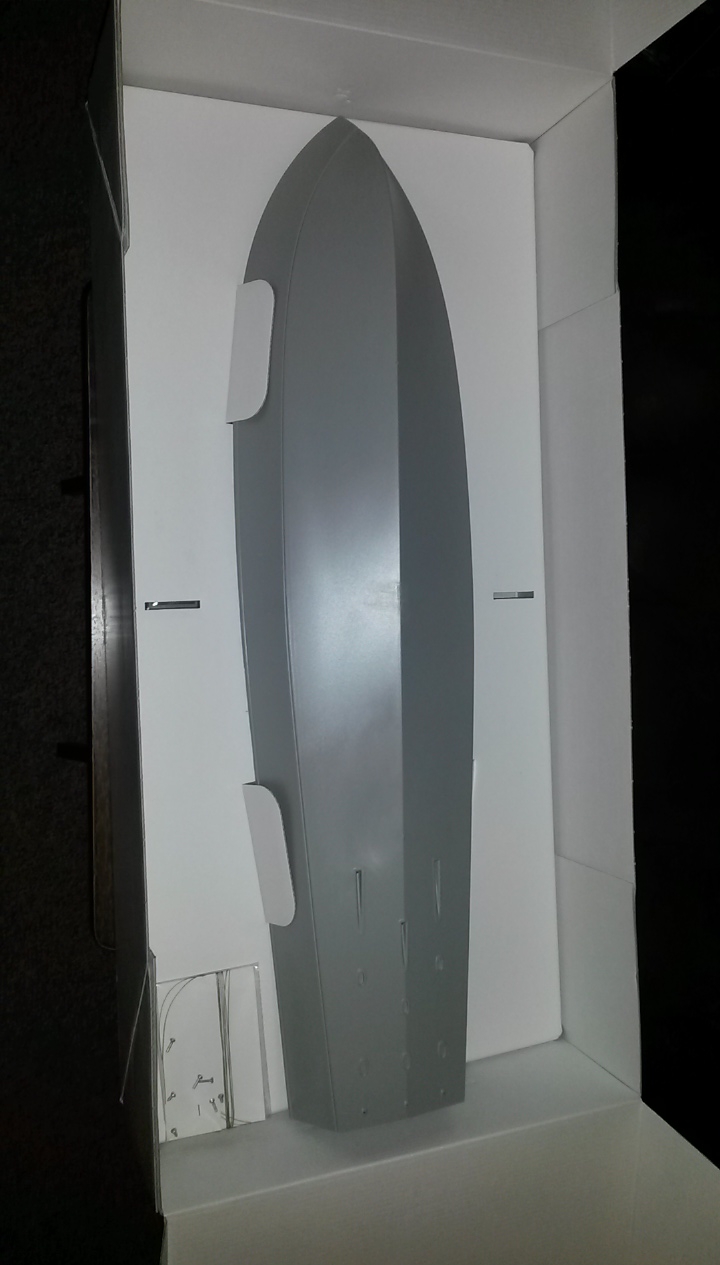

Many years back I had one of the old Lindbergh PT boat kits that I had converted to radio control, and had started thinking about doing another one. As I was looking for a kit I came across the Italeri boat model. It is about 2 inches shorter than the Lindbergh, but a lot more detailed. It is offered in early and late war versions. I decided on the later version and dropped the cash. I also ordered a brass running gear set from a vendor on ebay.
Here's the eye candy...

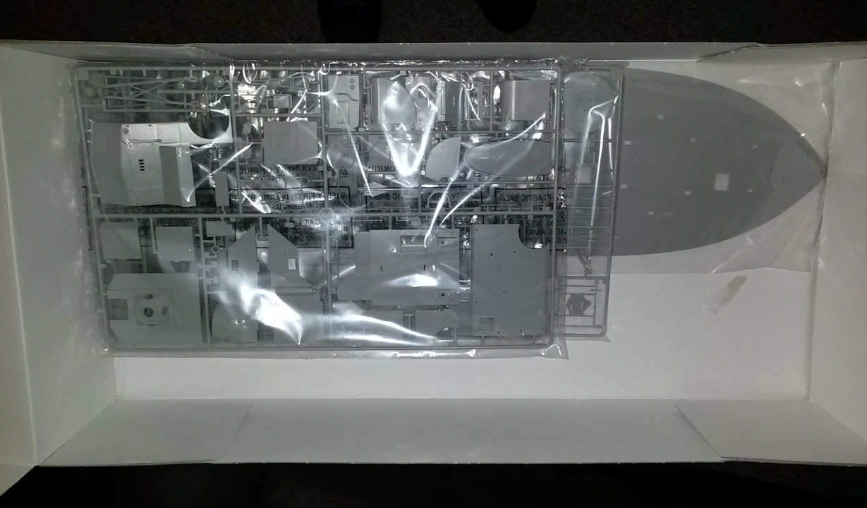

First, the unboxing.
The parts are packed really well. Included are clear parts, rigging and ropes, a photo etched fret, and metal barrels for the 40mm Bofors and the forward 20mm. The one piece hull is a big advantage for the r/c version. The deck is one piece and attaches with screws. You have to kind of flex the hull to attach the deck, but this does give the slight bowed curvature to the deck.

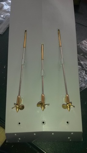

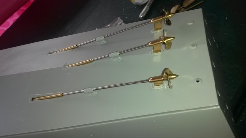

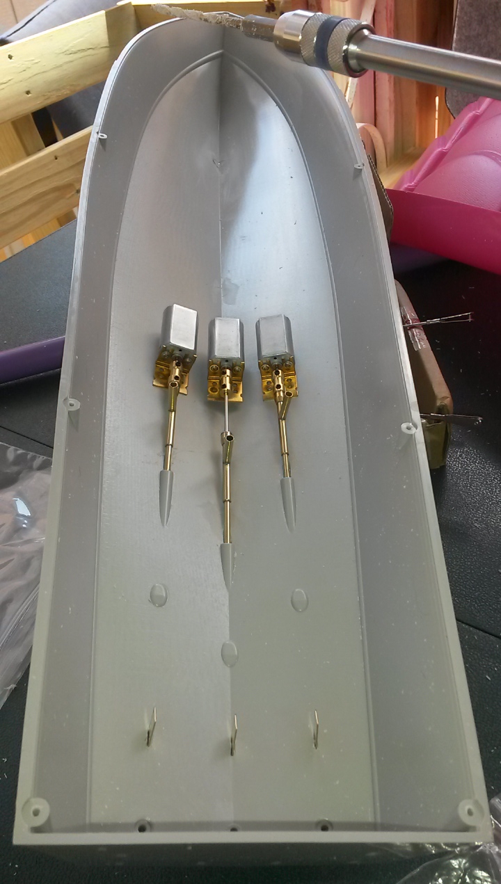

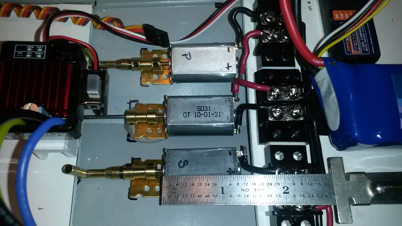

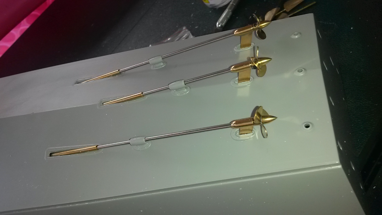

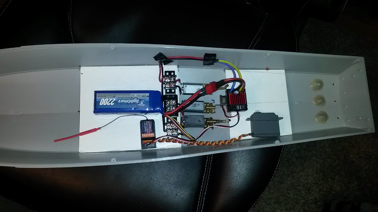

Here's a few shots of the running gear being installed...
The motors and stuffing tubes from inside the hull. The stuffing tubes have bearings installed where the shafts enter, as well as the oiling tubes already installed. Here's the underside. And a different angle. The deck is temporarily installed to check the positions for the rest of the electronics. Just a quick note on the running gear kit. All the pieces are really well made and assembled. All the machined surfaces are smooth and the fit on everything was just fantastic. It did arrive missing the stuffing tubes and control arms for the rudders, but after a couple of quick emails, the seller had replacement parts on their to me.
I also ordered a flexible push rod and some connectors for the rubbers, so I had a bit of a wait for these. I started on the deck fixtures, doing these up as sub assemblies.

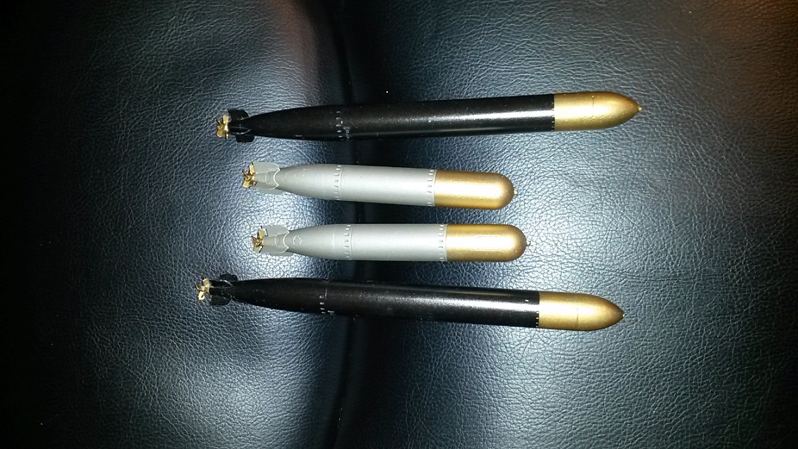

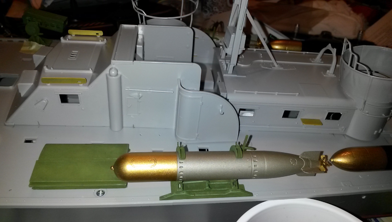

Here's a picture of some of these stacked up, just to get an idea of the overall look. I ordered a couple of the Mk XIV torpedoes just to give it a different look. I had came across a couple of pictures of boats with these torpedoes and liked the look. One of the picture captions said that the crew had done some swapping with a passing submarine for the torps.
Here's the interior layout I came up with. Bill

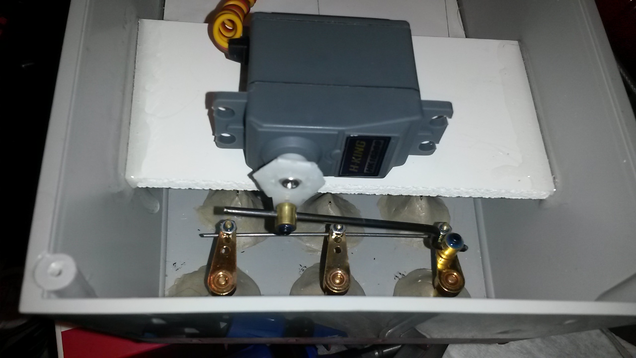

Yeah, the running gear was extremely well made. I really had no complaints with it, other than it would have been nice to have a two armed control arm to make it easier to hook up the three rudders and the push rod. The props are held on with small grub screws as well as the control arms and motor couplings.  I still have to file a flat on the shafts to make a better grab spot for the screws. I'm using thread lock on all the screws to hopefully avoid losing something.
The one piece hull is definitely a plus when doing the r/c conversion. Makes it SO much easier. I've been working on it for several days now, but just getting around to posting some pictures. It's not really going as fast as it looks!
I have tried the hull and engines in the tub a couple of times while I was waiting for the rudders. It really moves some water! Looks like it'll move along pretty good ones it gets loose on some big water. Right now I'm doing some more painting on the deck fixtures, and getting ready to paint the hull. It looks like it's going to cool off a bit this coming week, so I should be able to get out to a local lake and give the hull some proper sea trials.

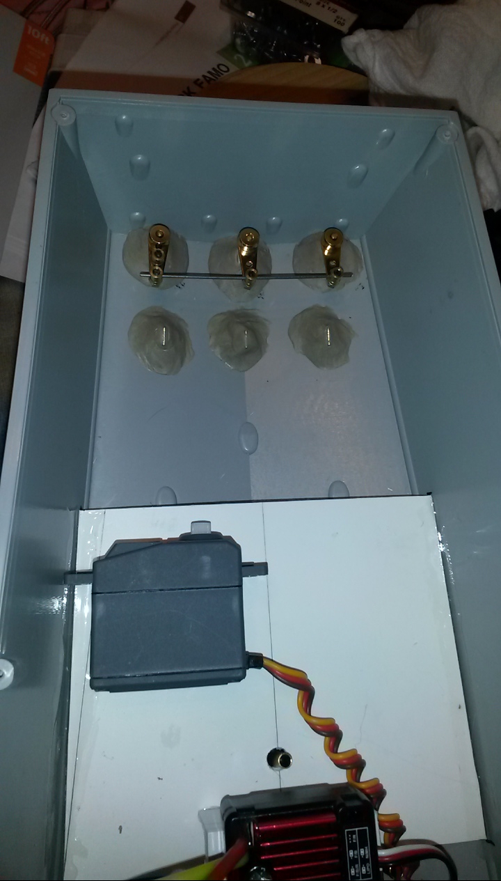

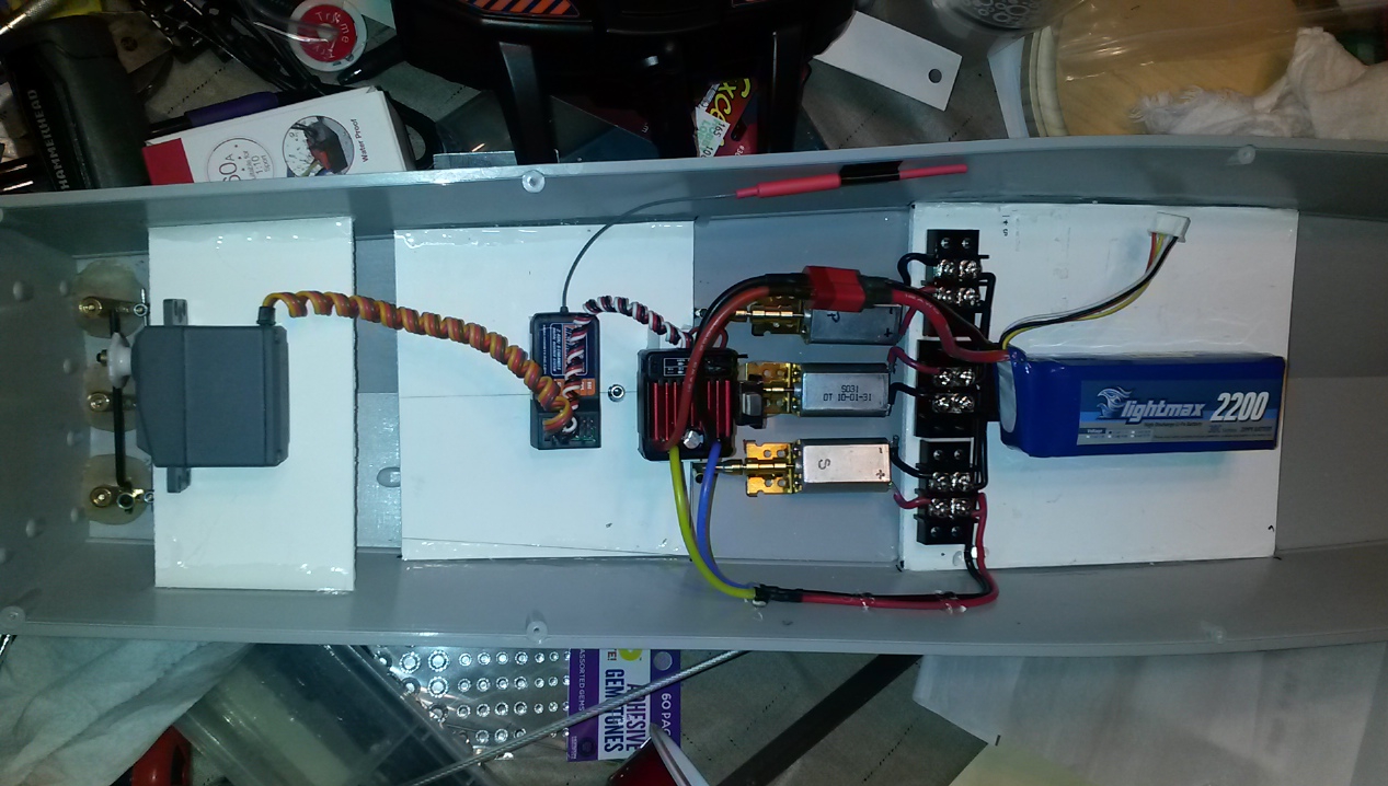

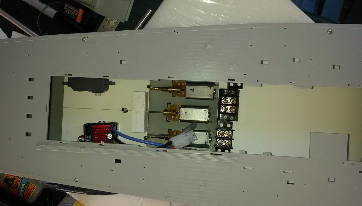

Got the rudder parts in, as well as the flex push rods. Here's the interior with the rudders installed. The flex push rods just did not work out, so I had to go with plan B. Here's what I came up with. Seems to work pretty smooth, and as a plus, I managed to get full throw on the servo with no binding. Here's the full interior. And a closeup of the motors and wiring. And started some painting... And this brings us up to date. Further post will be a bit farther apart.
Bill

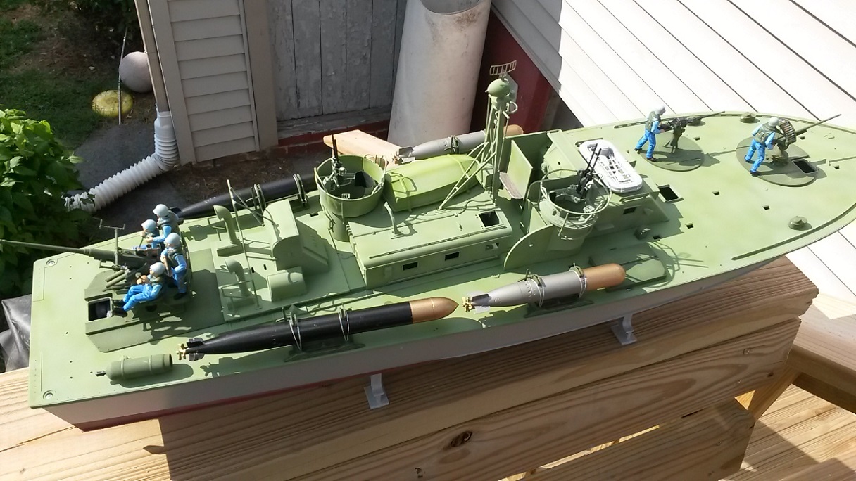

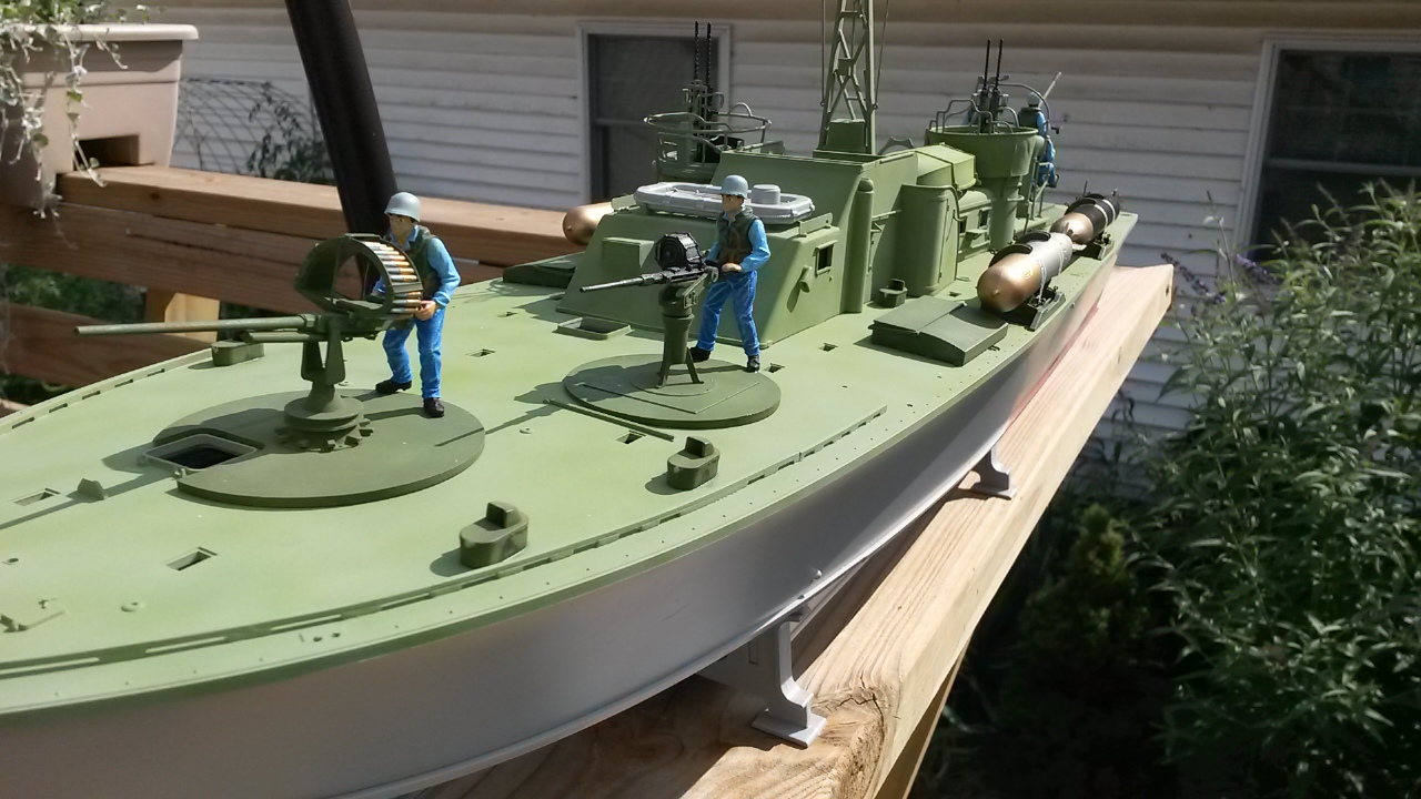

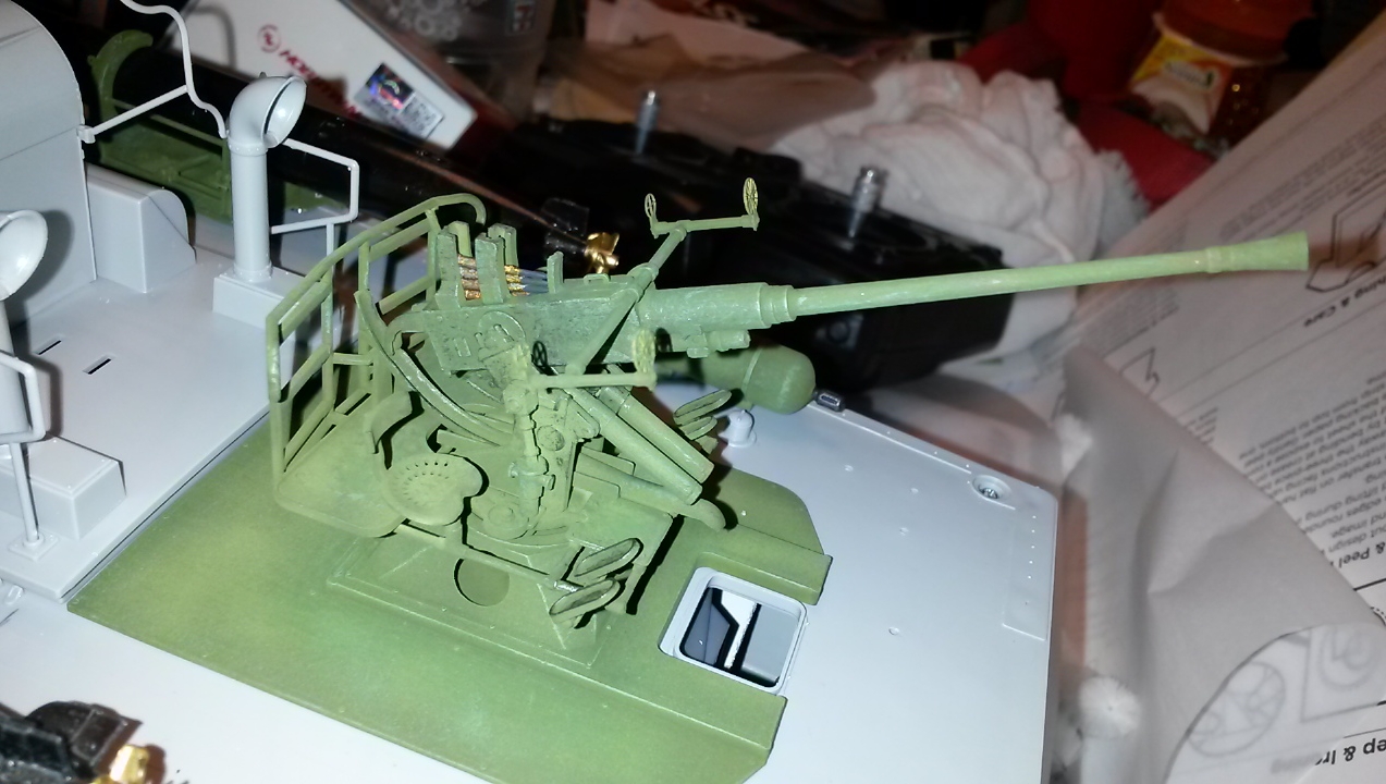

The crew figures I have are manning the weapons, so they should liven up the boat a bit. I've got a 4 channel radio for it so I did think about some motion for the 40mm. I might still do it before I close up the hull, just not sure.

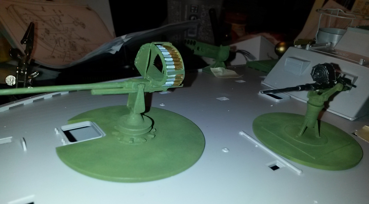

I managed to paint some of the smaller sub assemblies today, and here's the results. Not sure why, but the thumbnails are upside down, but when you click on them and enlarge them, they are right side up.
This evening I might get some of the figures mounted to the guns.

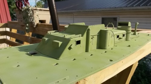

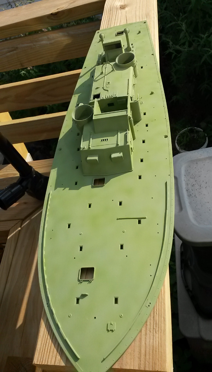

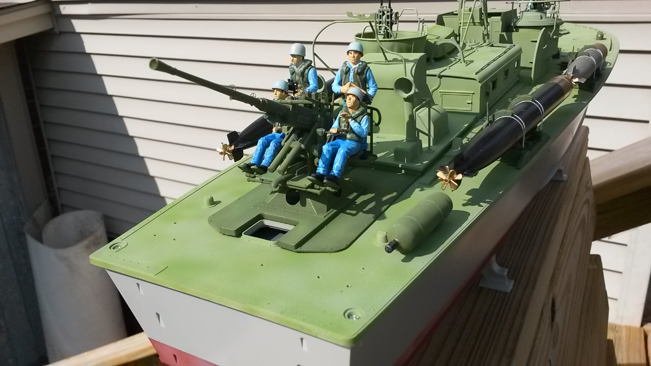

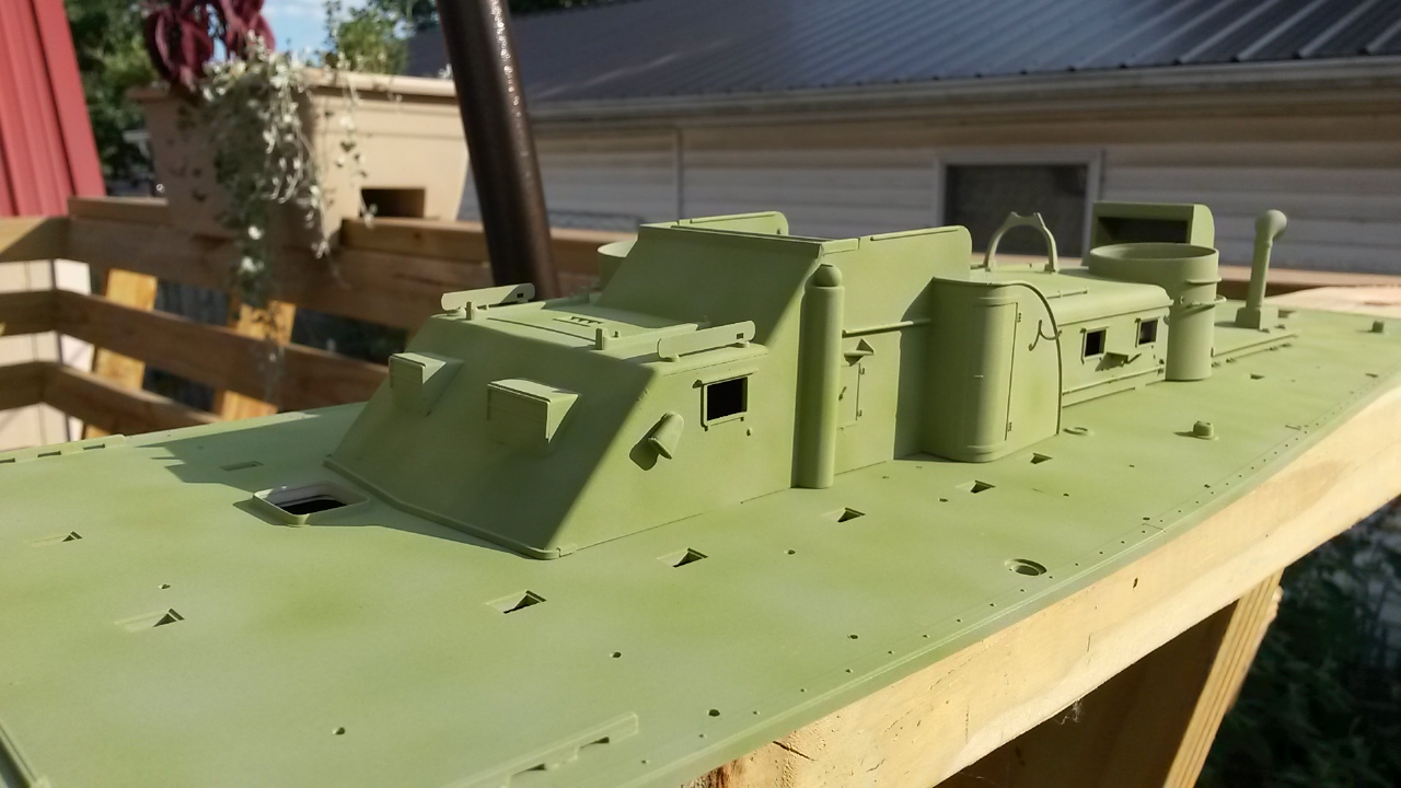

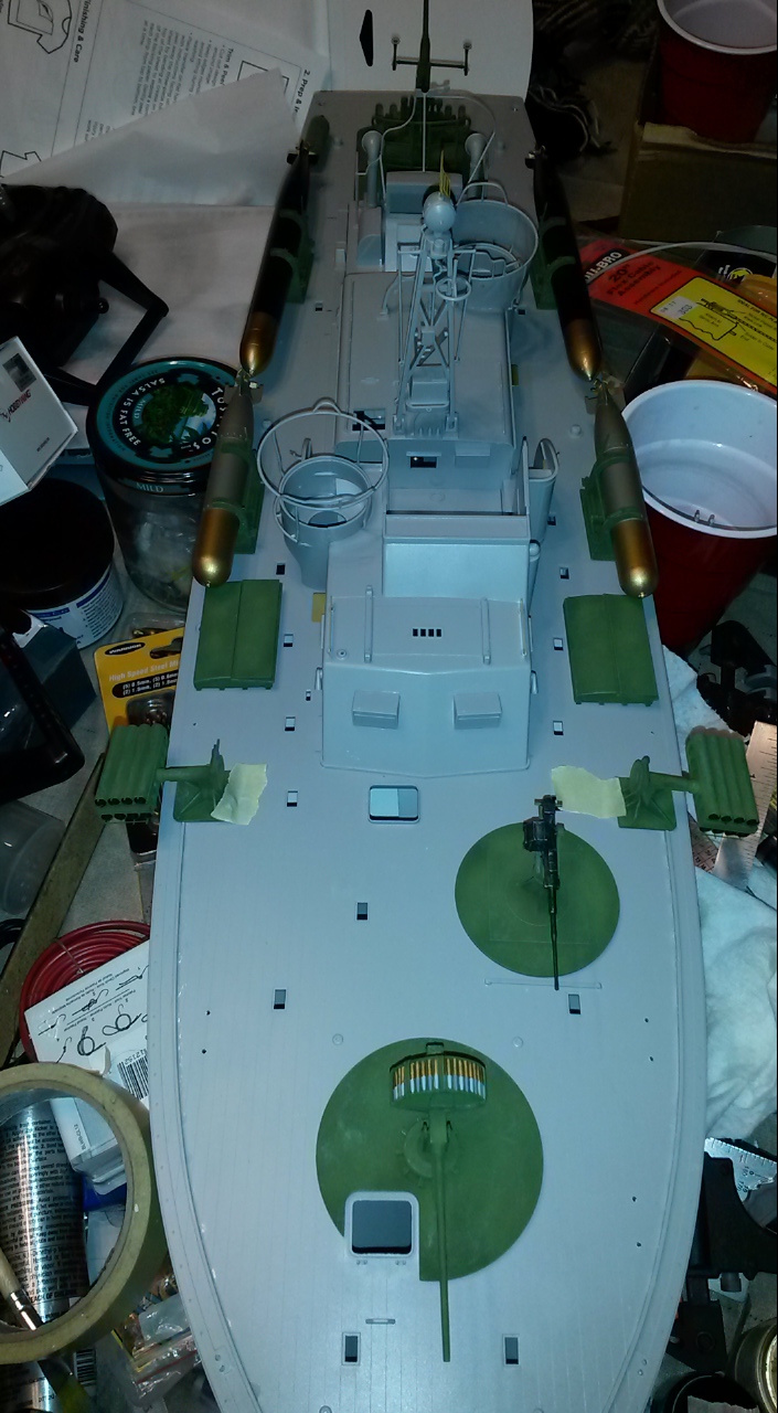

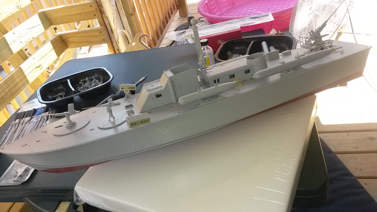

Been getting some of the painting done, slowly but surely. Here's some shots of the progress...
Here's the barre deck. This is the first time I've tried to replicate faded paint using two different colors. Didn't think it turned out too bad. And some with most of the deck fixtures temporarily attached. More to come!
Bill
