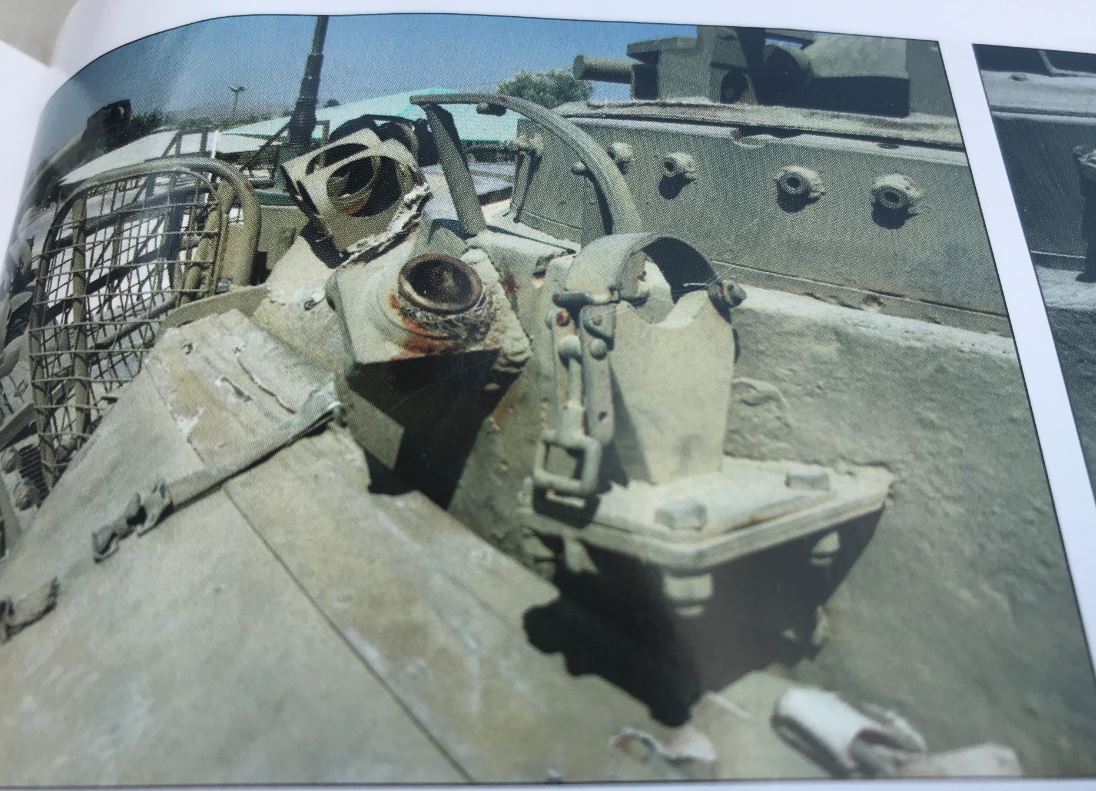

Here is the 60mm turret mortar.
Sho't Kal were given an externally mounted 60mm mortar next to the commander's cupola, likely to be used against ennemy dug-in anti-tank teams and maybe to compensate a lack of IDF infantry support. It must also have been a risky operation, requiring the commander to partially exit the turret, aim and fire the mortar while totally exposed, and doing so instead of commanding... I do not know in what level of success it was used. I am not aware of other armies doing the same.
The book "Centurion tanks of the IDF" has an extremely rare picture of the 60mm installed.
Otherwise, we only get to see the brackets. The AFV Club kit provided some measurements on key parts.
The mortal tube was scratch built mainly with 5 and 6mm brass tubes. It is not easy to build and was done on a best effort basis with quite a few compromises. But I am satisfied with the results. Here, the mortar is in locked position.
It adds an interesting feature to the turret.
Regards, Louis
Regards, Louis

Like an old Naval Volley Gun !!

Well do Louis!
Under a coat of paint it will look very convincing.
Barry
Barry
