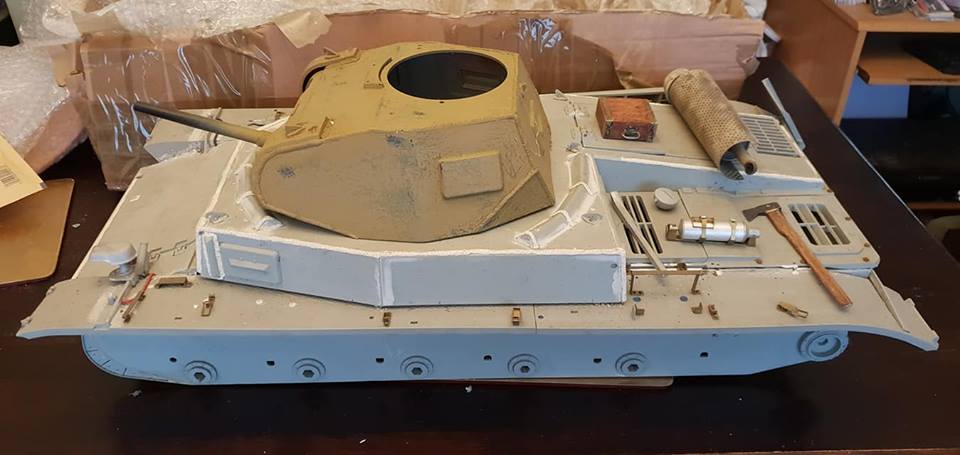

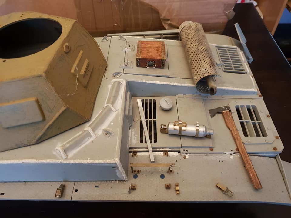

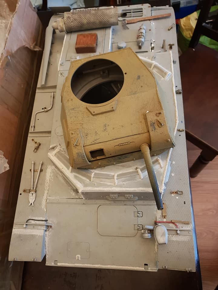

Re: Dragon 1/6 PANZER II AUSF.B to F Conversion with RC?
So,,,, this happened. I think i'll be making this one static until I work out the costs of adding RC to my other Tank. Sadly this one will also have to go into storage until after Christmas. Hopefully i'll be able to get the rest of the kit next week?
