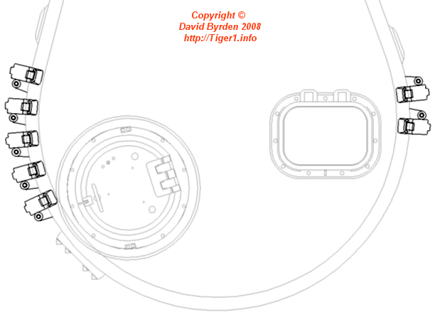

I'm going to put this spare links on the sides of the turret. How many links each side is considered enough? 4 or 5? The links were cut from a plastic PanTiger, so there can be as many links as possible.

Check my fehrmann tiger build to see numbers and positions.
It depends on your versions build period as how many and where they should go.
Tiger info site has details on precisely where and how many.
Posts: 11972
Re: Building Tiger 1 Late Production from Mato's lower hull
Try this
