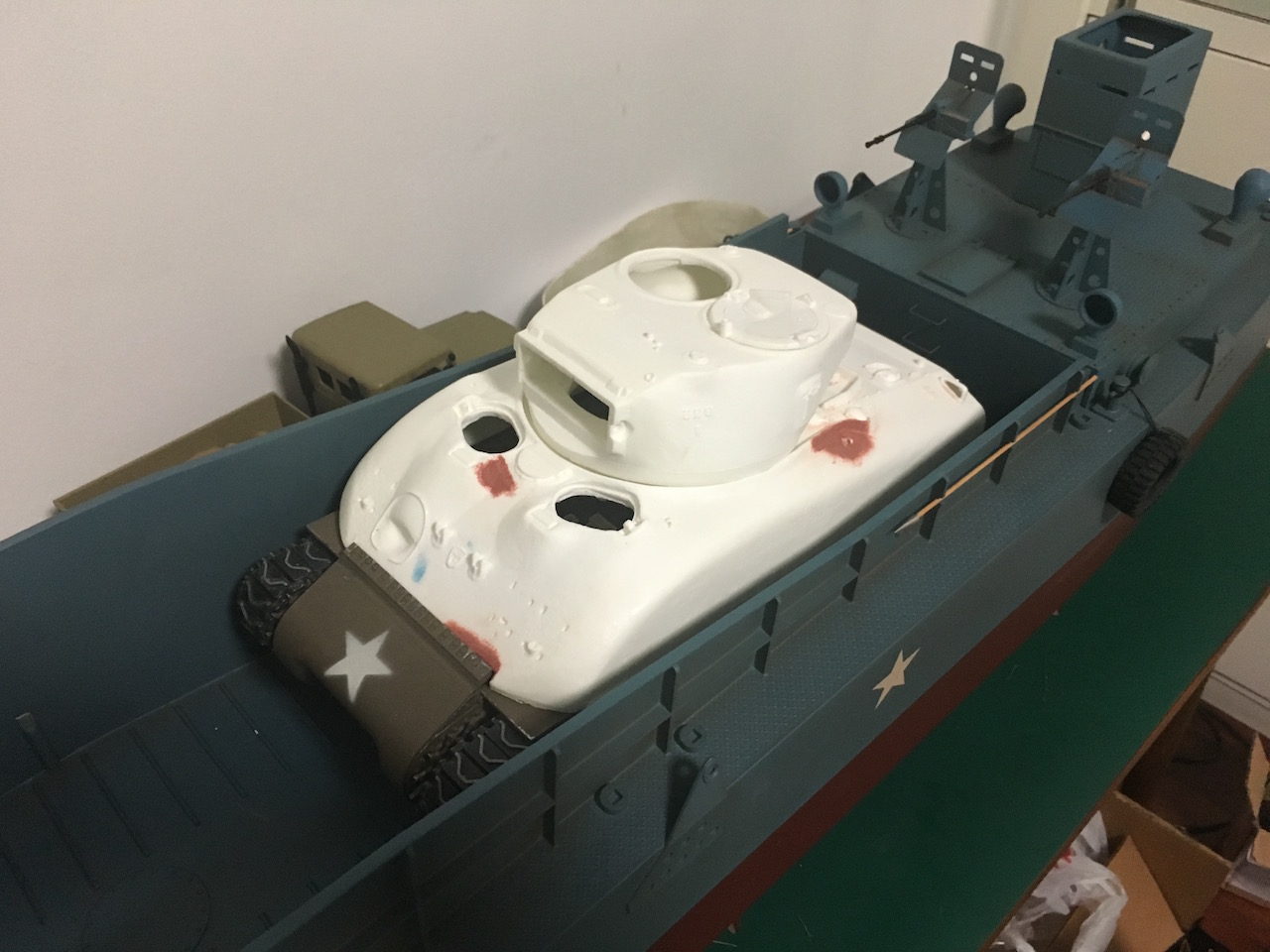

I'll be following since I'm doing similar with Nick A's M4A1 upper hull kit on the Mato M4A3.
