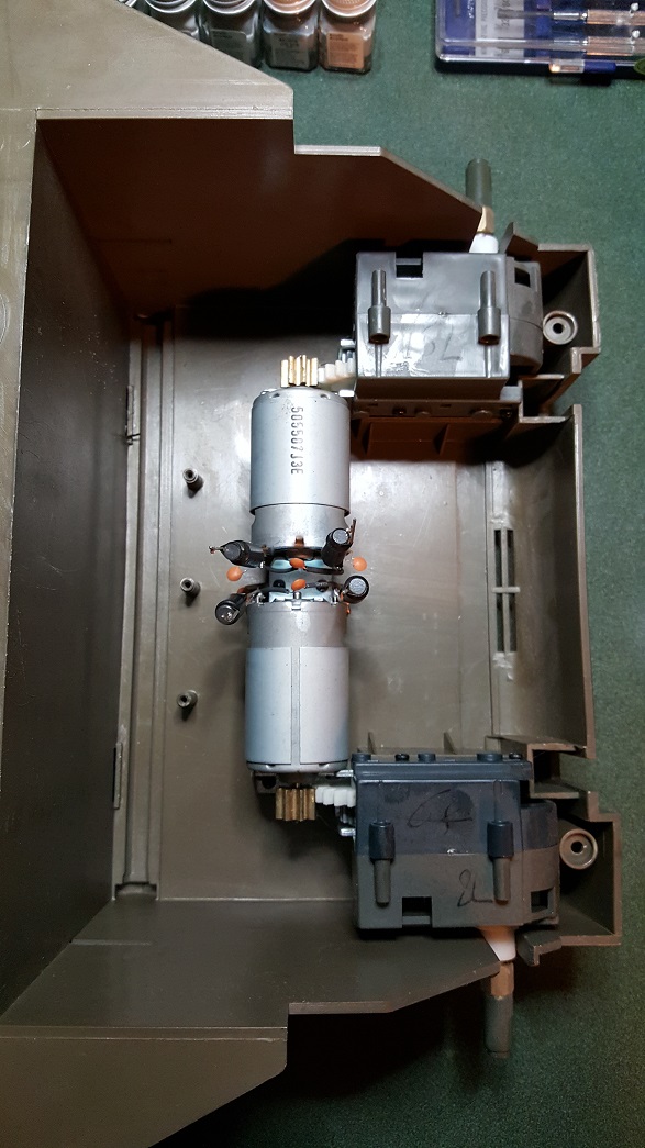

Those motors. I WANT those motors. My Leopard is slow as hell after all the upgrades. I think it's a bit too heavy for the 380/390 motors the Taigen gearboxes came with.

These are the same, just a different colour to mine.
https://www.banggood.com/Heng-Long-Brus ... rehouse=CN

Just 12000rpm under load? That’s... not impressive. Admittedly more than the +- 9000 rpm of the original Heng Long motors. But still. Must be incorrect specs... *scratching head*HammerWihoutASickle wrote:Those motors. I WANT those motors. My Leopard is slow as hell after all the upgrades. I think it's a bit too heavy for the 380/390 motors the Taigen gearboxes came with.
Sent from my Phone using Tapatalk
Give me these any time of the day : https://www.rctank.de/2-x-Taigen-390-25 ... -gearboxes
I’d say, since You are situated in the USA contact Eric at IMEX tanks. I wouldn’t be too surprised if he had that type of motor in stock. https://www.taigentanks.com/taigen-parts/

By the by, for those wondering: the 4kg T-90 in the little video in my show-off thread is using Permax 17000rpm 390/480 motors without the weak-iron mantles, nòt the 25000 Taigens.
The Taigens were a bit too much for me, ànd a tad Amp-hungry. Think 15 to 20 minutes at best on the stock 1800mah LiFe, compared to 25 to 30 minutes on the Permax motors.
On gnarly, gutted offroad terrain the Taigens would run 10 minutes at best before the voltage cutoff intervened. Motors got hot too.
I guess not a problem for a tank with a normal sized battery compartment, though.. Just pop-in a 5amp LiPo...
Just so You’d be warned when using high-rpm motors.

I now use the DKLMRC dual 550 gearboxes in my leopard. It’s reasonably fast, but there’s not much needed to be faster than the anemic white-endbell motors and pot-metal gearbox it came with
However, the increase in torque while traversing heavy, gnarled terrain is not something to snuff at. My word, it goes like the clappers. Like there’s no terrain undulations to speak of. And the IBU2Pro takes it in stride. I had to up the amps in the .ini to prevent shutdowns, though.
I like the fact that it gives me the opportunity to -finally- use some of the big 540- and 550 motors I collected over the years with my RC-Car hobby. Now all I need is the IBU 3 to be able to use some robust 45amp ESC’s. Got plenty of those. Maybe -in due time- slap-in some brushless outrunners.

Seems they aren't the same. The superfast ones I had were black with a picture of a toy train on the side. In fact they were so fast that it made the Leopard uncontrollable. I swapped them for a pair of Graupner Speed 400's, and the tank is now running at a quick but totally realistic speed, and is perfect for turns etc.wibblywobbly wrote:These are the same, just a different colour to mine.

Little tip when using the DKLMrc 550-gearboxes with their stock motors: Take off the weak-iron mantles. ( They are actually meant to increase torque by concentrating the magnetic field, but that comes at a cost in rpm, rpm’s that are needed in the high-gearing gearboxes of our tanks)
The Leo will be quite a bit faster, and I did not notice any degradation in climbing power, or rough terrain driving. Even 45°hills are no problem. It barely loses speed, if any. I was quite surprised.
It also runs forever on 4000mah, despite the humongous 550-motors (no idea what wind. I guess 21 to 25 turn or something.) They are frugal. Which is kinda logical, since they don’t have to work as hard as little 400/480 motors.
Shame they are quite expensive, these 550 gearboxes, or I would put them in every tank I got...
Thanks to the (rather expensive) hybrid metal/plastic and rubber Tamiya Leopard tracks -that coincidentally fit the HL metal sprocket and runners like a glove- it has only thrown a track once, and that was on grass.. super-spinning is not advisable with high-grip tracks
