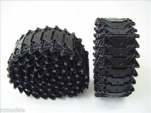

Re: HL Leopard 2A6 Gearbox options?
These are the different tracks
- bulldog
- bulldog.jpg (26.85 KiB) Viewed 8572 times
- Pershing
- pershing.jpg (10.25 KiB) Viewed 8572 times
- Leopard
- leopard.jpeg (12.58 KiB) Viewed 8572 times
