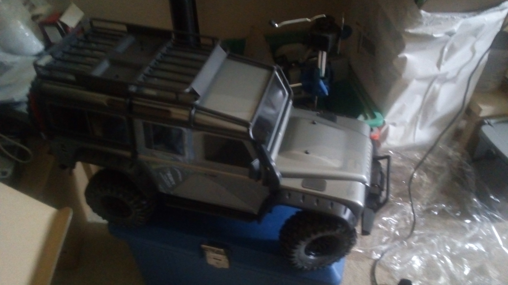

I did buy a TRX4, lol, here it is sat awaiting various mods. I am impressed with the programming on these, takes RC trucks to a whole new level. I am toying with the idea of installing clear windows at the front, and installing an interior, and stripping the shell for a repaint. Wheel weights will also be on the cards.
My mate Simon, who owns the model shop has a wealth of knowledge, and more RC models than I can shake a stick at. I was wondering about the Lipo/Nimh choice but he advised me that they will run perfectly on an Nimh battery, a 2S Lipo is plenty good enough, and a 3S is too much for a trail truck. That was good news.
The Mars buggy is based on an FTX Mauler, which is a bargain priced crawler, it does the job really well.
