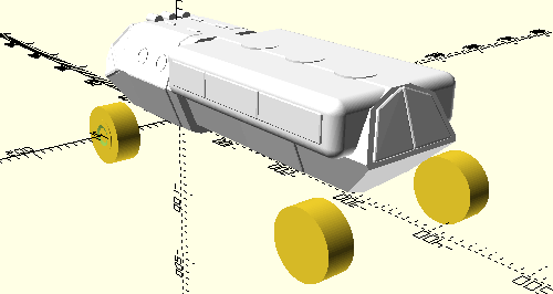

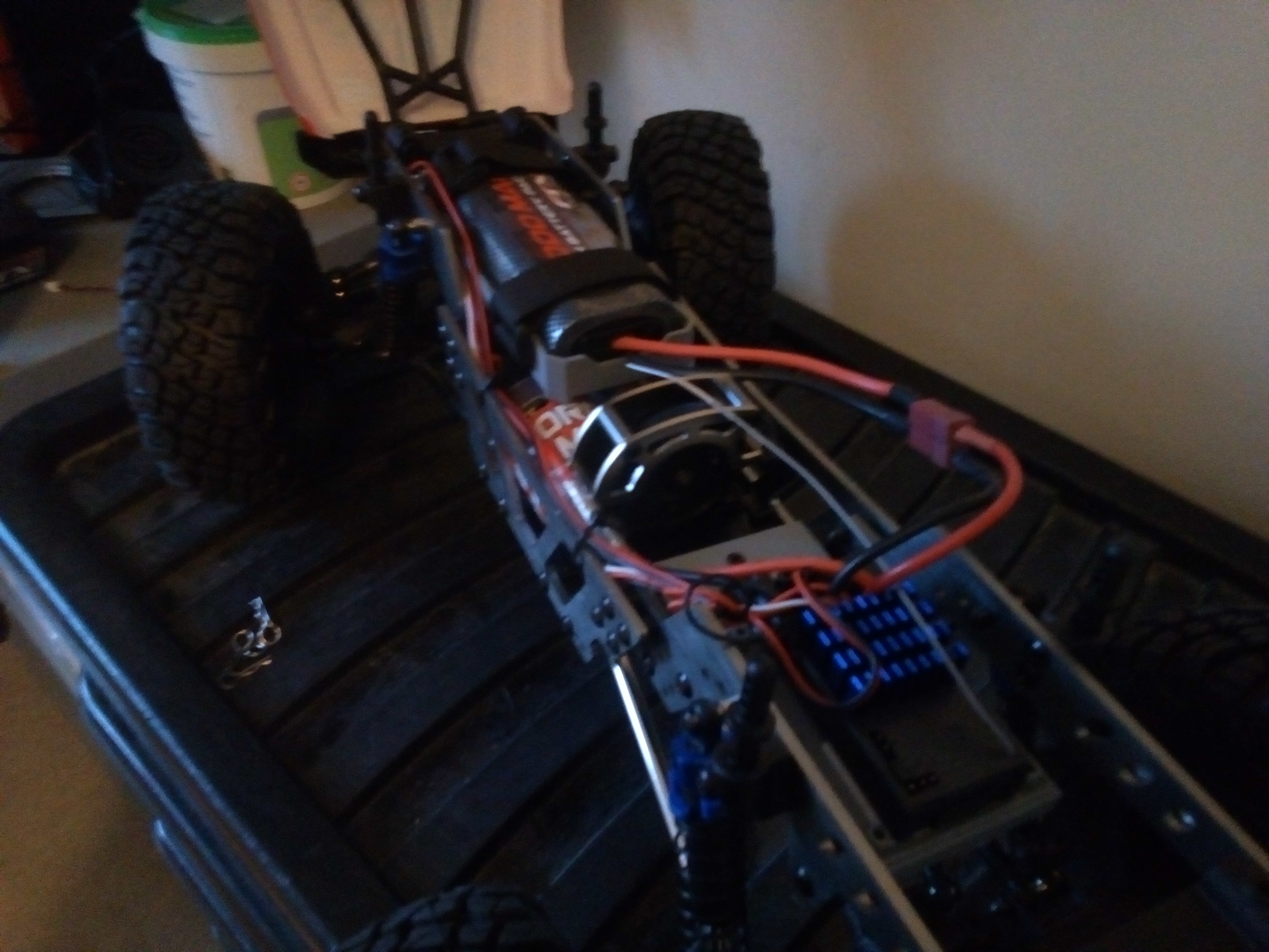

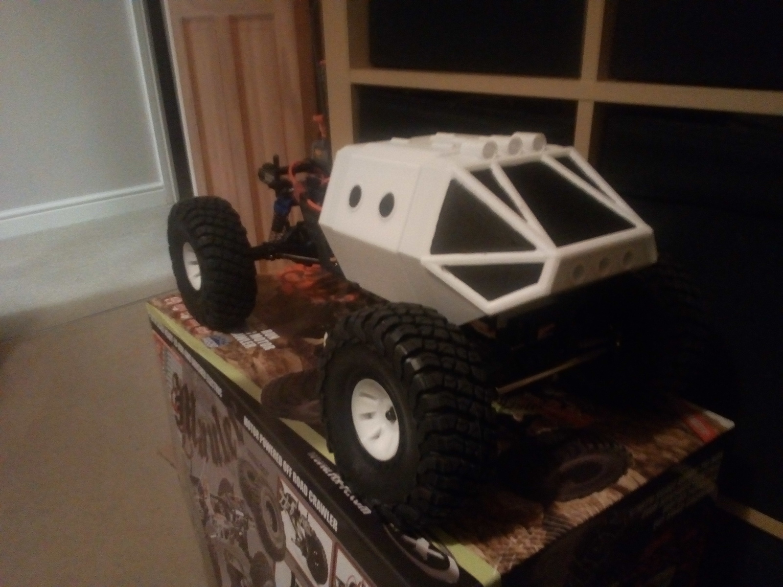

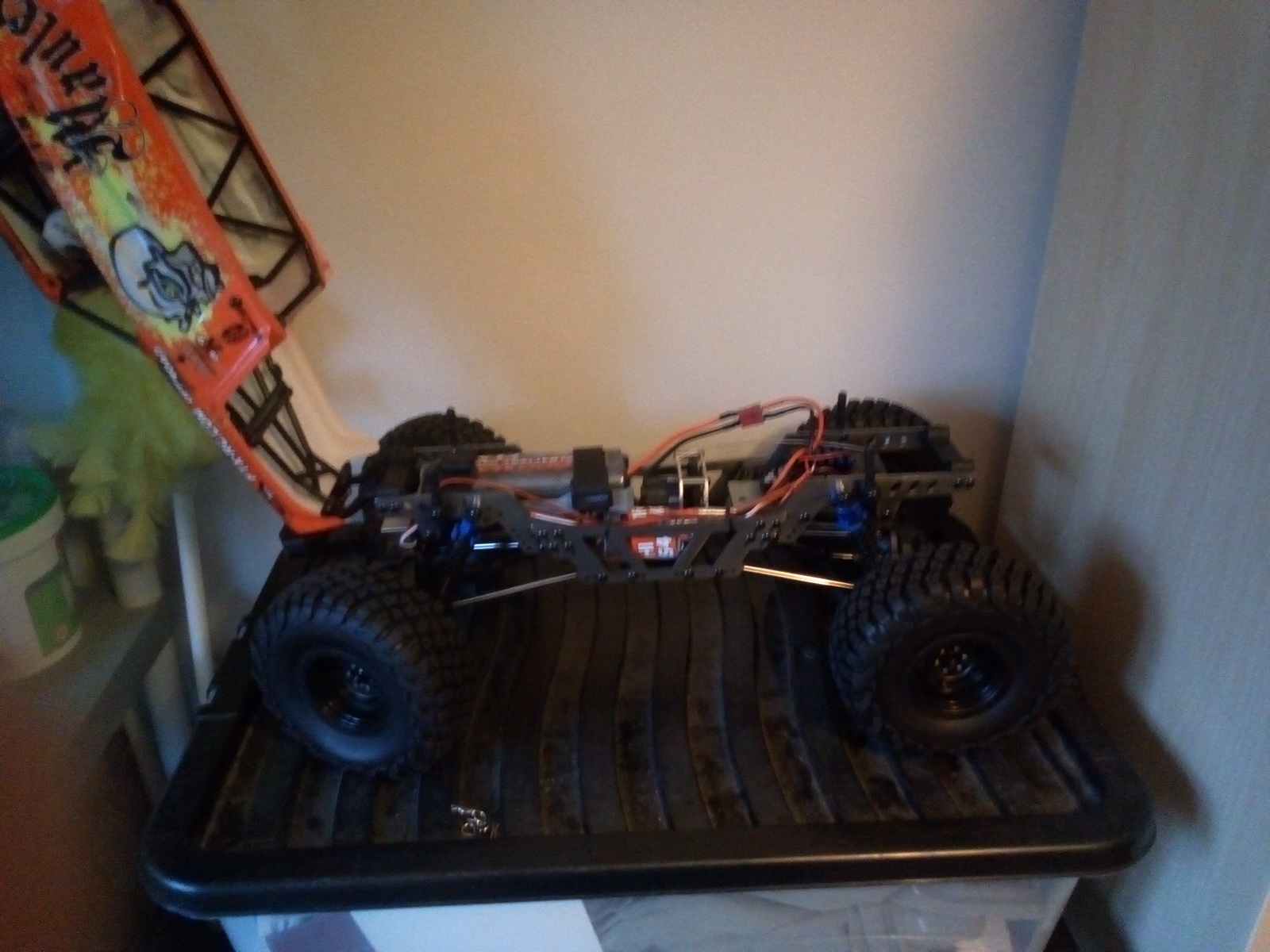

After looking around for something to build I have ordered an FTX rock crawler. I wanted something that I can do a unique bodyshell for, and after a quick bit of playing on Openscad, I knocked this up. It's 1/10 scale, so huge, but I reckon a Mars explorer suits the chassis etc.

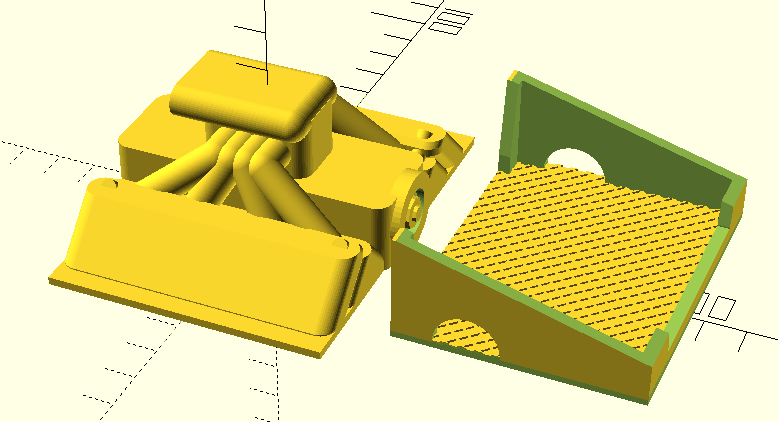

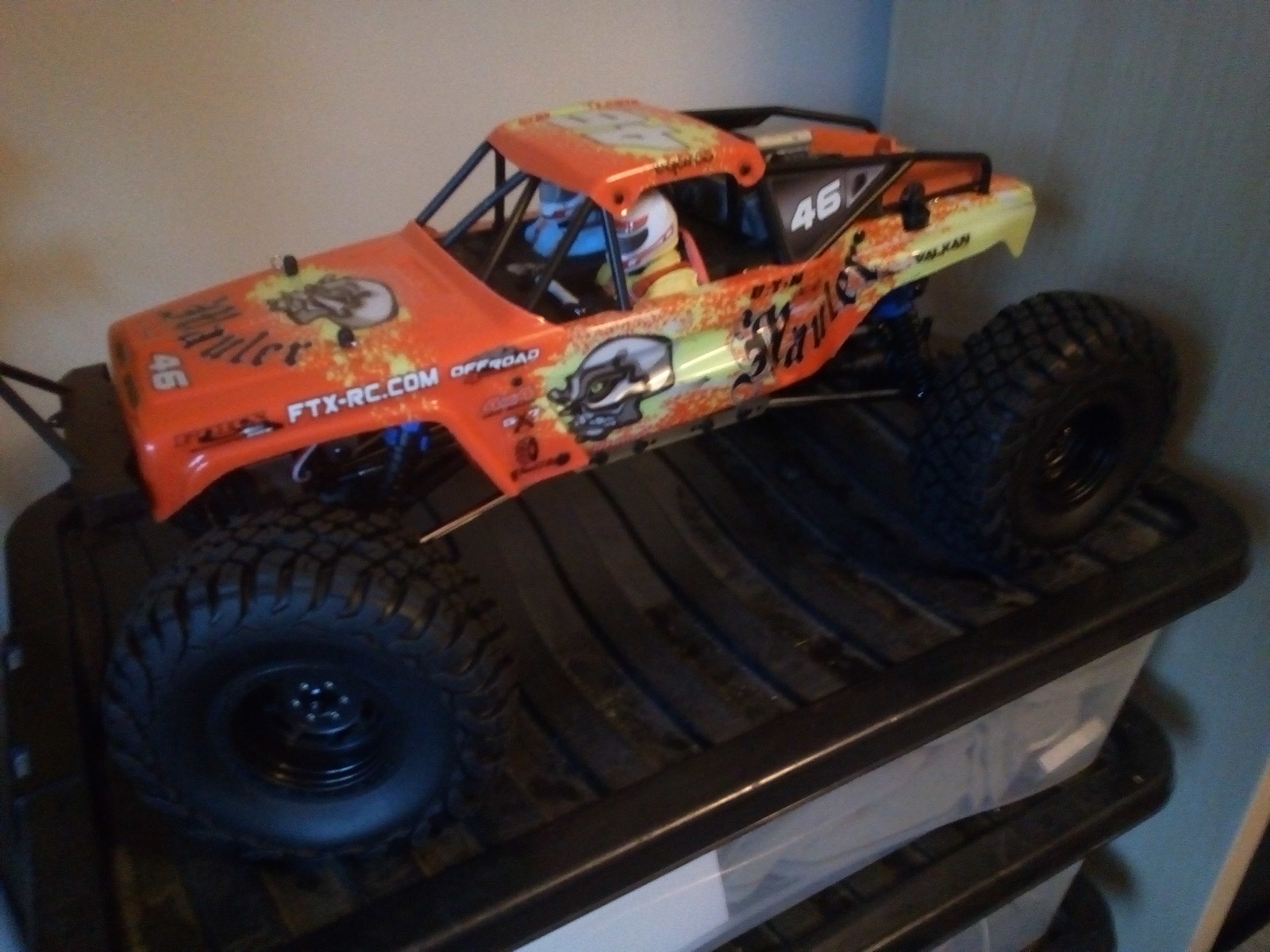

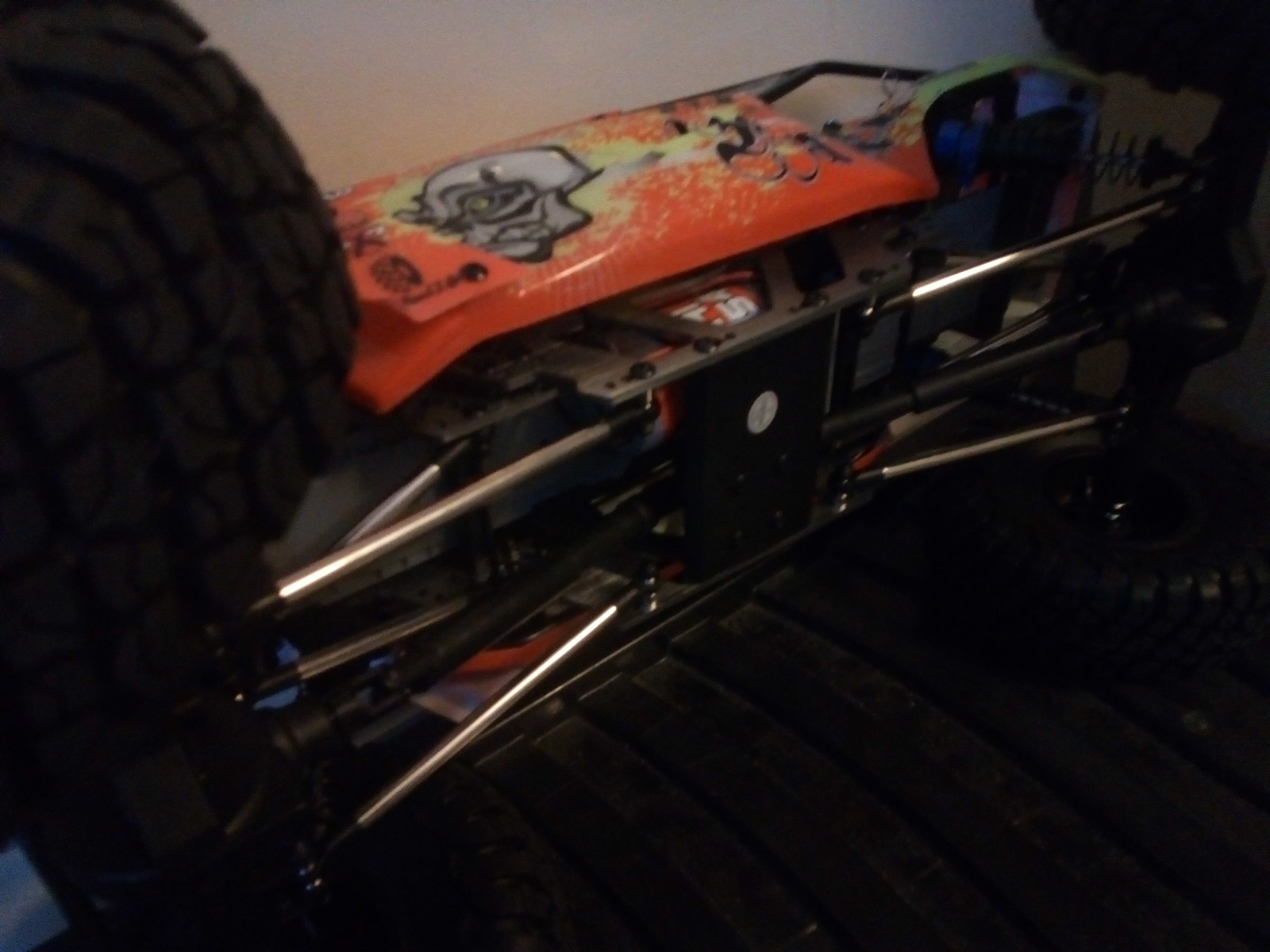

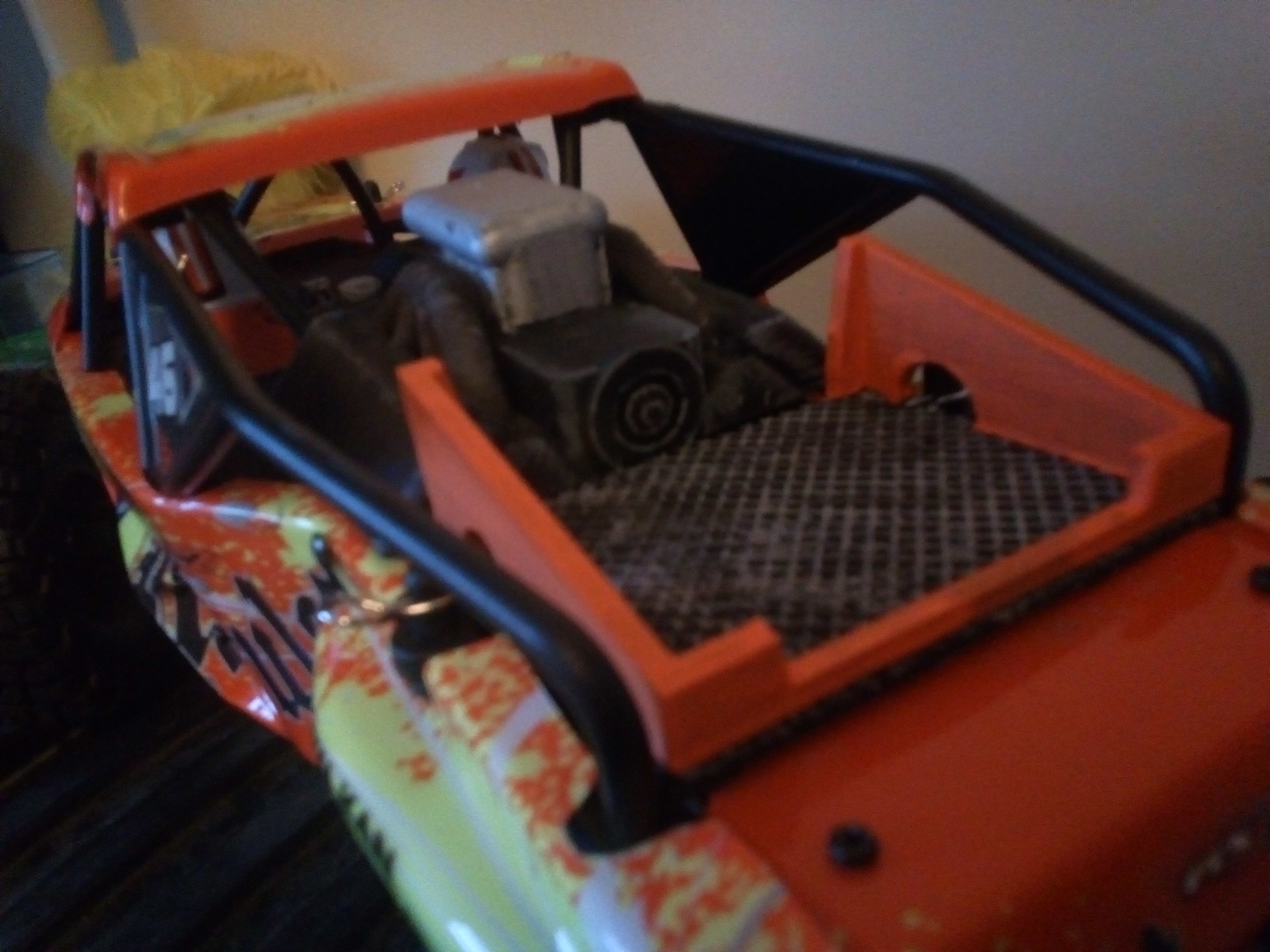

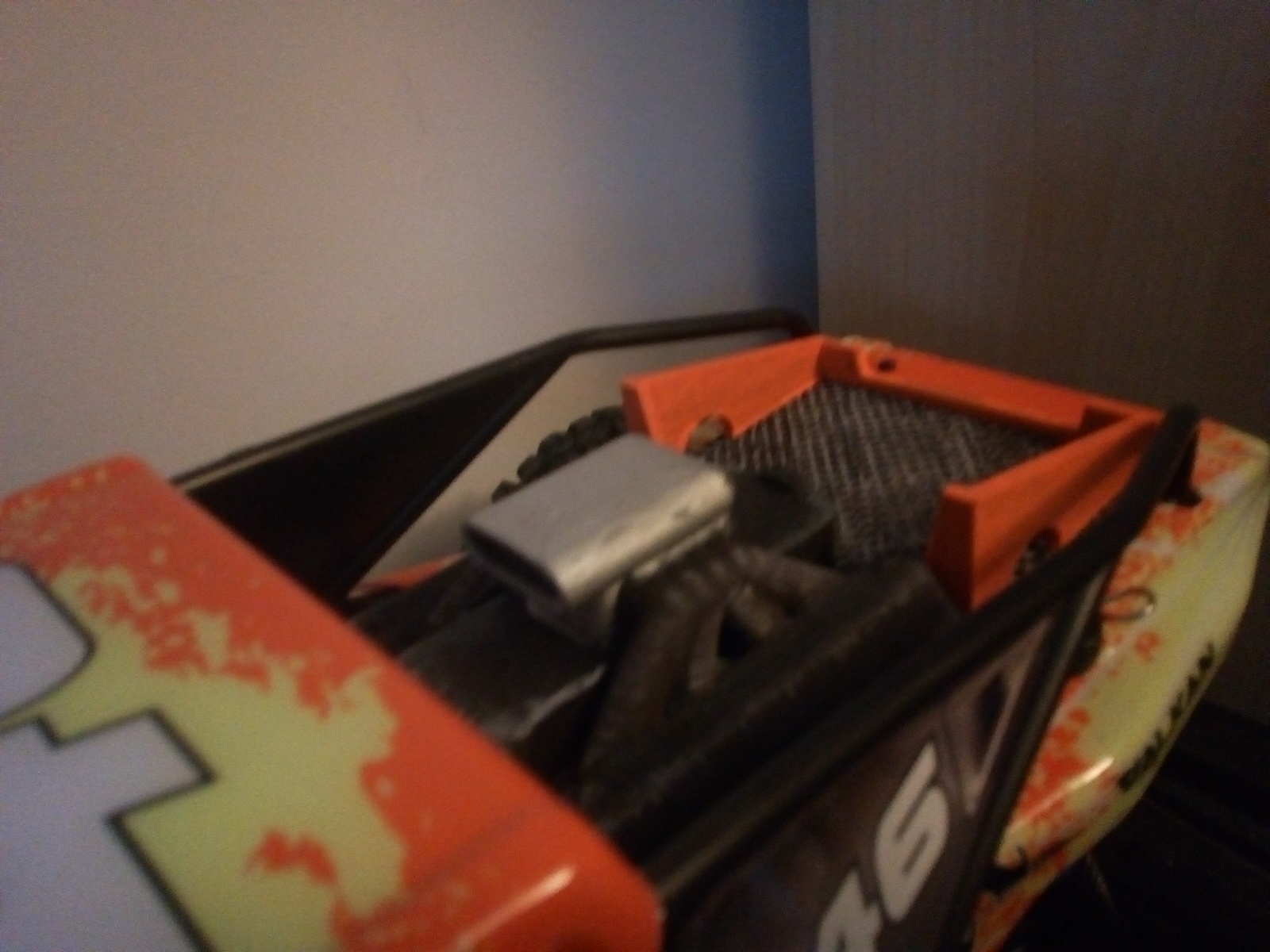

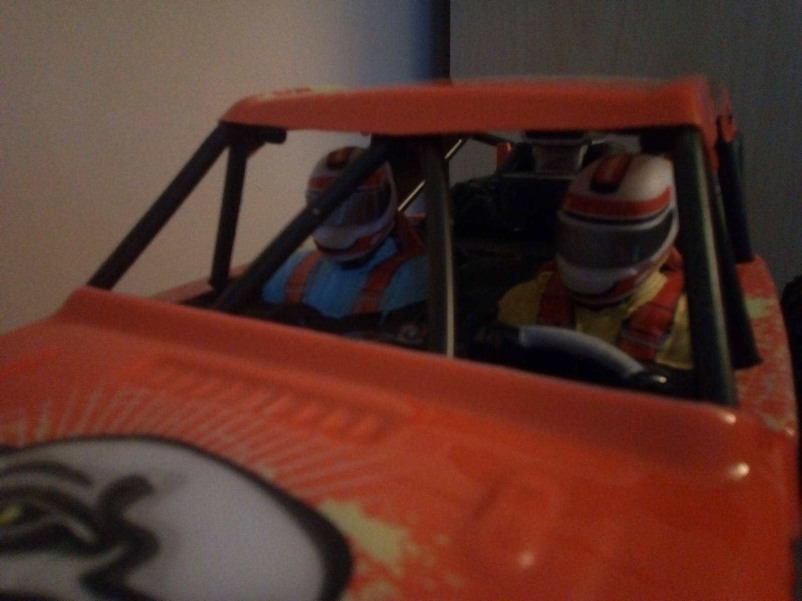

The crawler is on my bench, but the white filament that I ordered to print a new shell hasn't arrived yet, so I set about adding a bit of detail to the original bodyshell.
The interior, drivers and rear deck are all a one piece injection moulded sheet. which look a bit 'blobby'. I decided to cut the engine out, paint the the drivers jackets, and re-do the engine and deck.
Then it was just print it, paint it, and attach it all. Looks a bit better now.

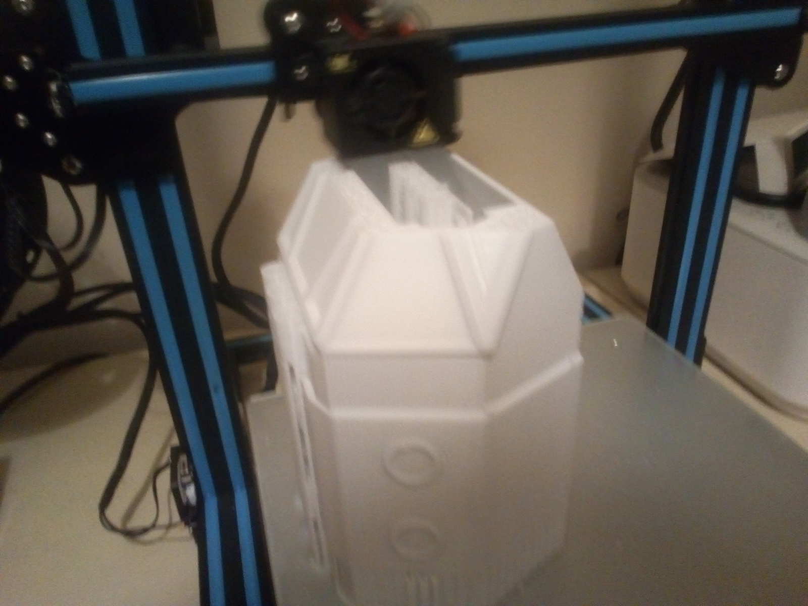

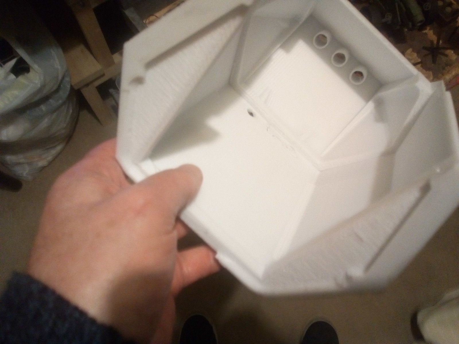

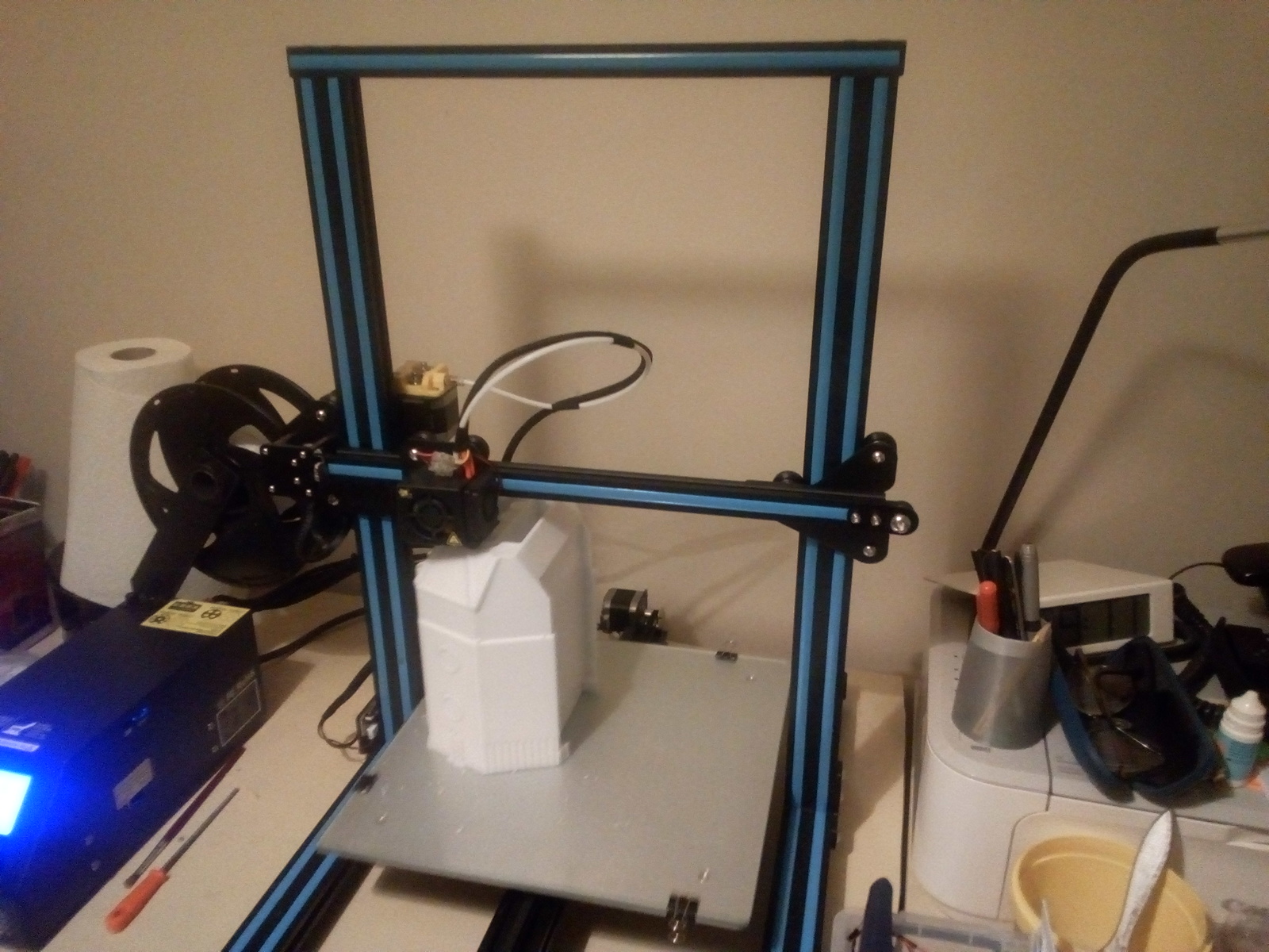

A reel of white filament landed on my doorstep so yesterday I started printing the Mars Rover bodyshell. Jeez...36 hours have elapsed, its printing at 140% speed, and it still isn't finished. It's going to use up the entire 1kg reel, so I have had to order another reel to print the rear bed. The CR10 has operated flawlessly, and Cura 3 is producing an excellent finish. I will have stacks of support filament to pull off, but the latest Cura now prints it so perfectly that it brushes off without leaving a trace of where it was attached to the structure.

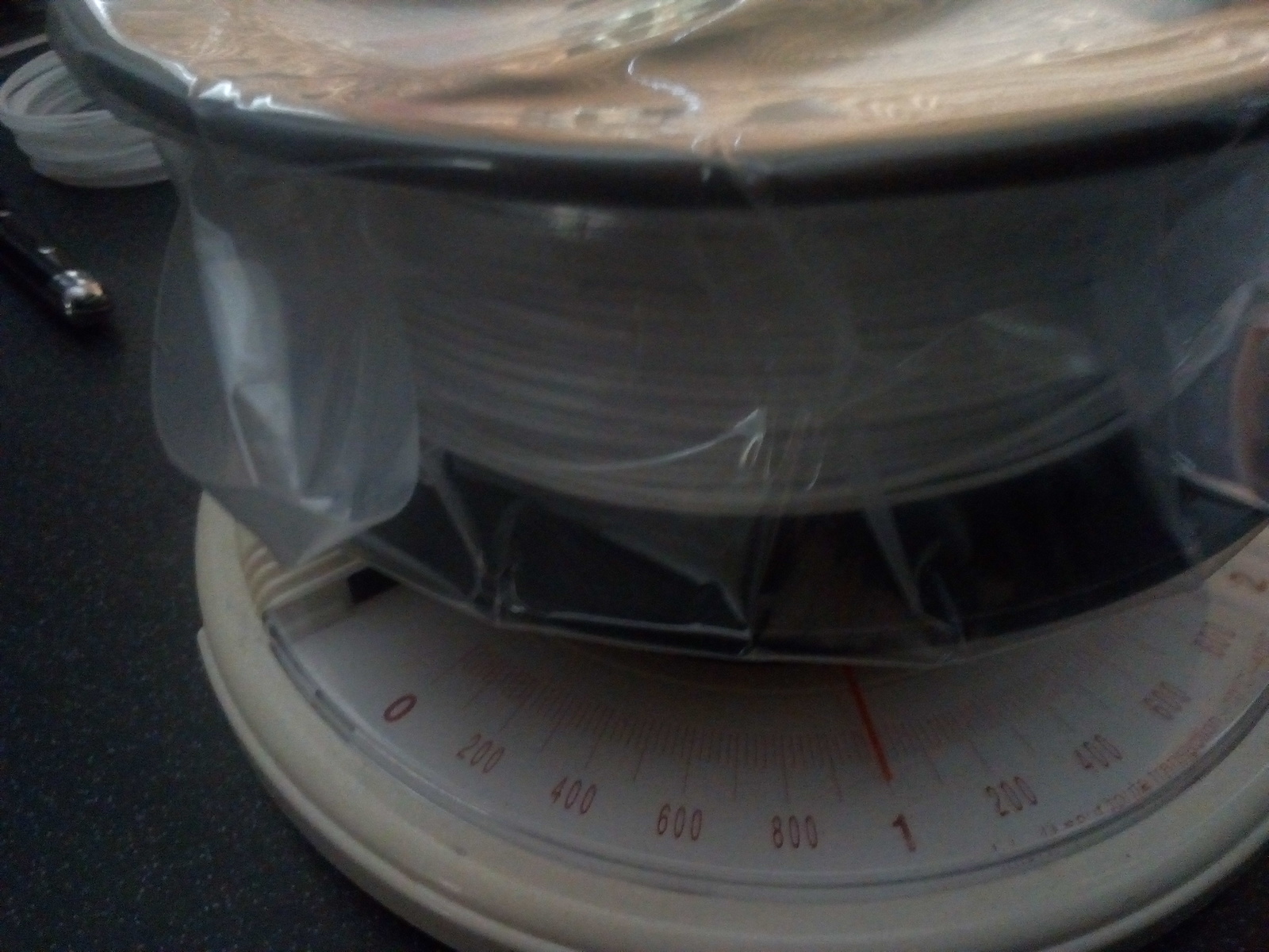

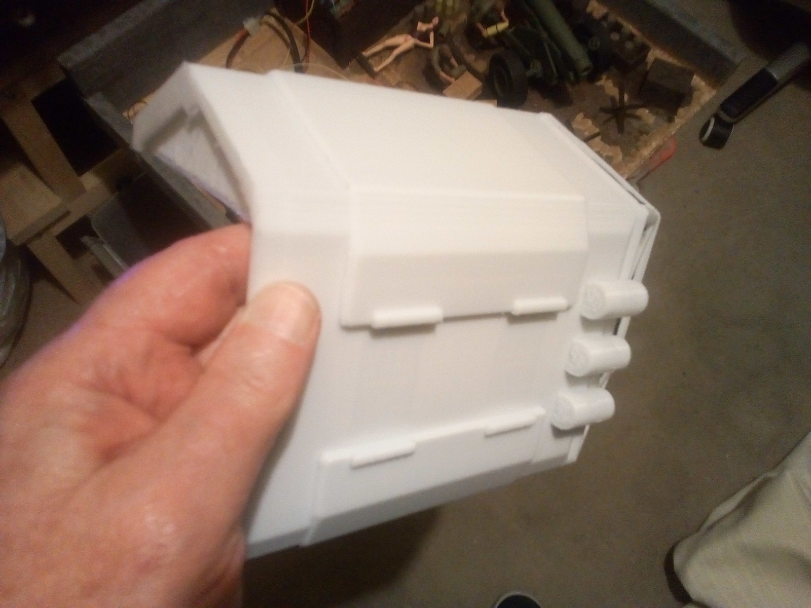

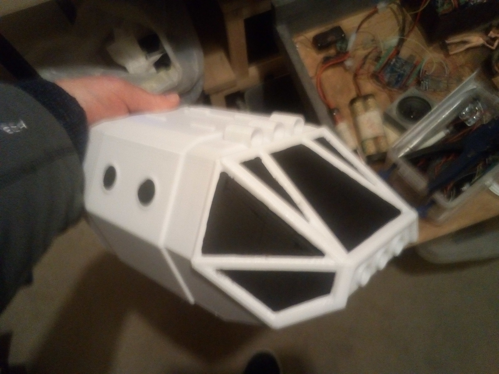

Well that was a marathon, around 42 hours even with increasing the speed by 50%. It almost all went badly wrong, filament comes on 1kg reels, Cura told me it was an 850 gram print. So, I loaded a new reel on when I started this print, so that I had plenty of spare filament on the reel. I get to 11pm last night, the print is 90% done....but looking at the reel there was very little filament left on it? I had to stay up till 2am to make sure that it didn't run out before it finished, it was close, maybe around 1 metre left on the reel.
This means that either Cura isn't calculating filament use very accurately, or that the 1kg reels I am buying only hold around 850 grams of filament. I ordered another reel, and will deduct the weight of my empty reel from the weight of the full one...if the answer isn't 1kg then the company selling it will get a shirty message from me.
Anyway....this is the front cab and wheel inserts, and all in flawless quality.

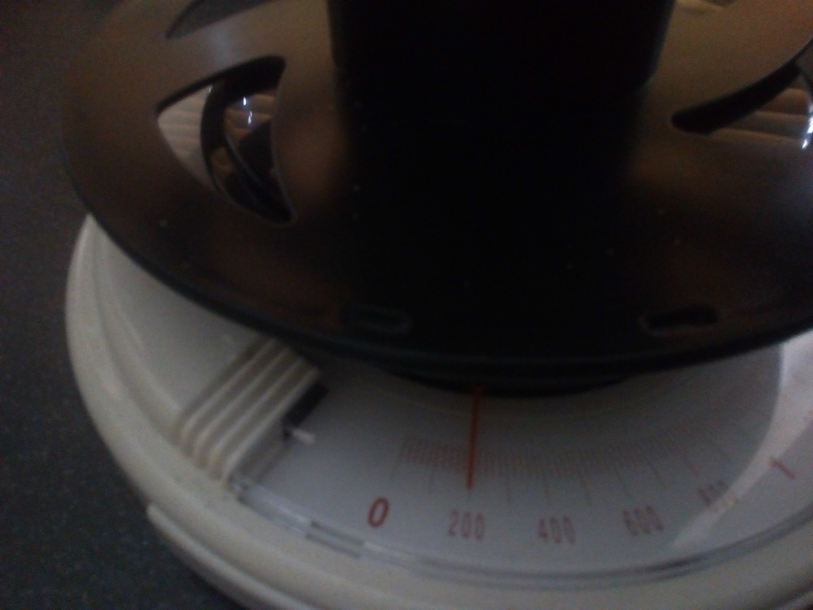

For those that have 3D printers and look for cheap filament off Ebay, beware of this outfit.
http://www.ebay.co.uk/itm/3D-Printer-Fi ... 580902628?
They are advertising standard 1kg reels of filament but there is only 800grams on the reel, the plastic reel and packaging weigh 200 grams. That's a 20% shortfall, so not only not the bargain that it looks, it can spell disaster if you are going to print something that requires 850 grams, load in a new reel and leave it running a oouple of days. The filament will run out and the 40-50 hour print will be wrecked.
I wish I had read their negative feedback before ordering...jeeeez....and Ebay allows them to continue operating?
