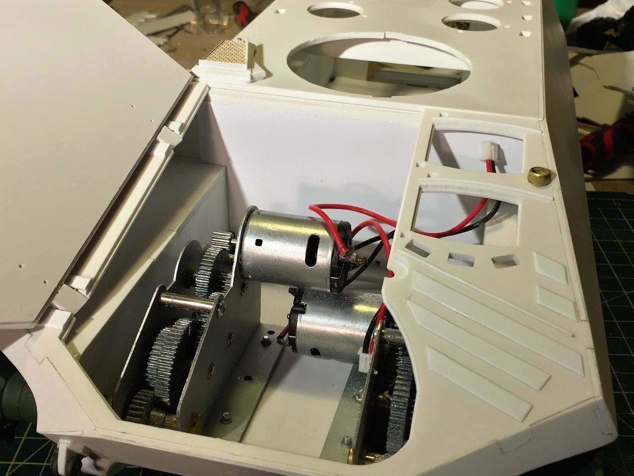

The front section is spacious and all the electronics and battery can still fit in, except maybe the smoker that I always dislike and never turn on. This is a big vehicle, just a bit smaller than a Leopard 2, and a big 13cm longer than a M113, wider too.

The next step is to create the rear ramp servo mechanism. It is annoying to have the ramp opening every time I moved the vehicle so this will be useful at this time. From my experience with the M113, it is also very important to pre-wire all the cables needed at the back before adding items to the fighting compartment.

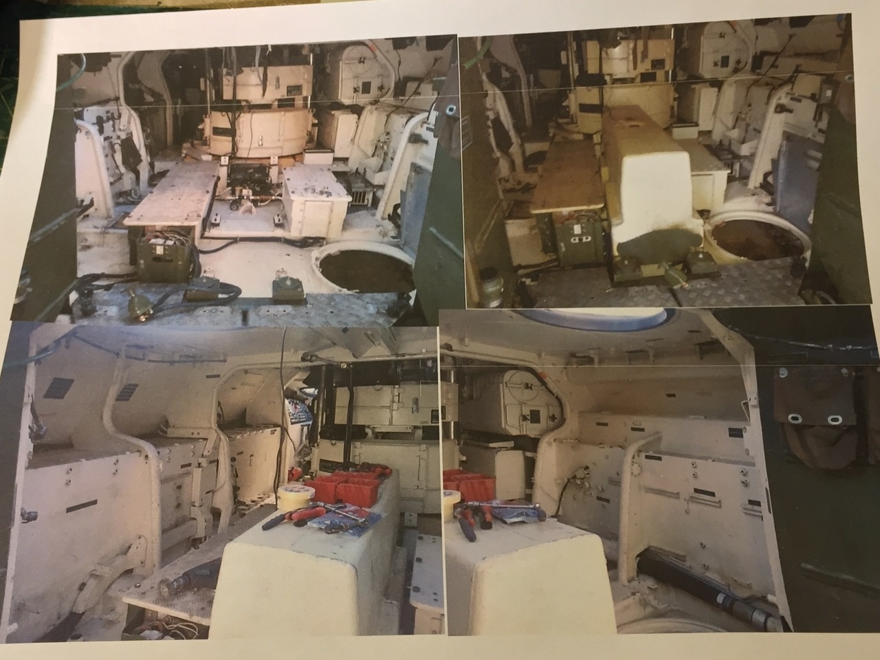

This is the general interior view I am looking for when the rear ramp will open, although my interior will not get so detailed. The complexity is intimidating. The M113 interior for comparison was so simple. It takes quite a bit of analysis to figure out the general layout of the interior and the various areas, equipment, metal plates and braces sticking out in all directions. The method is to take one item at a time.

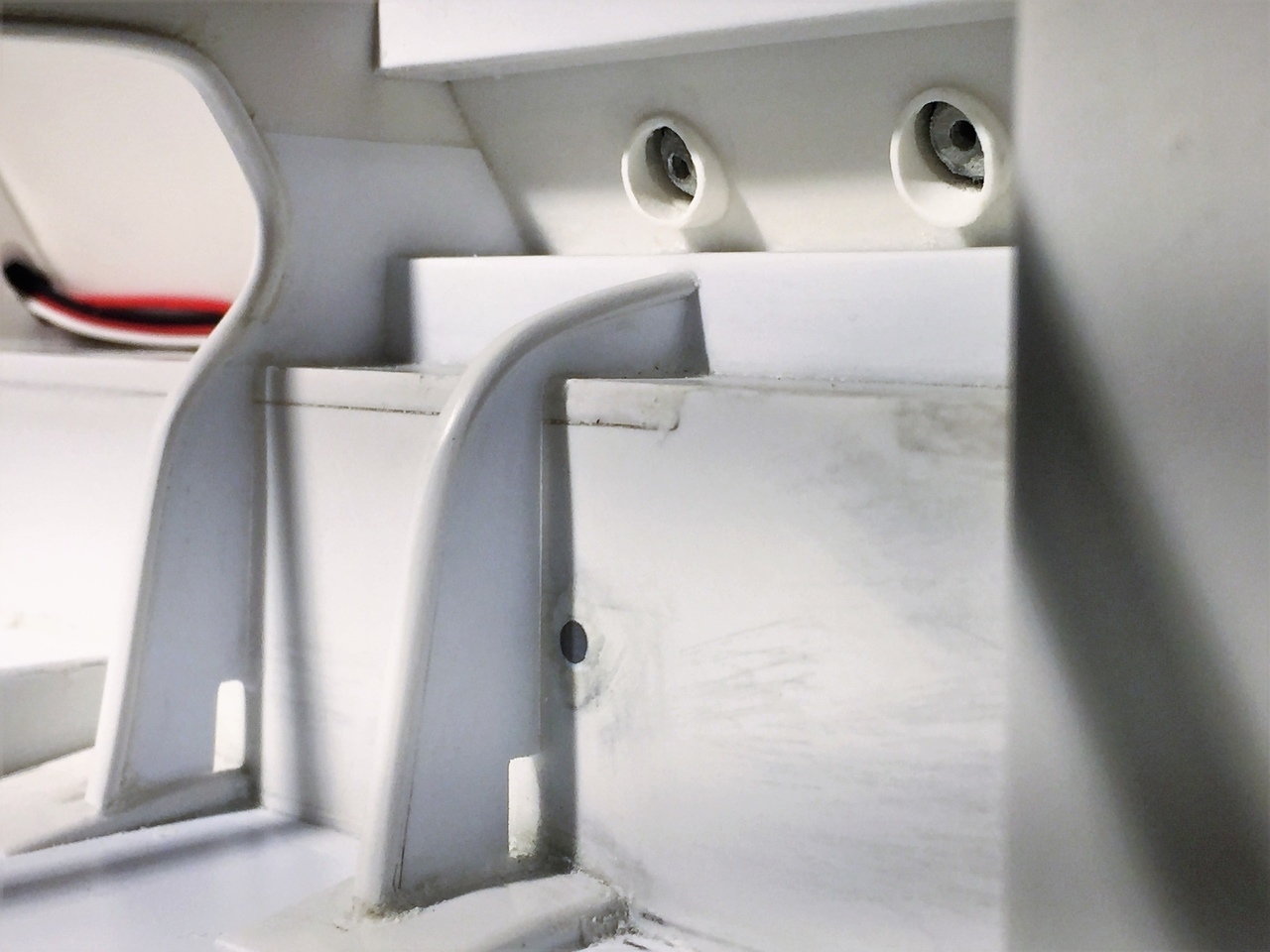

The gun ports were added first in order to ensure their accurate placement in regards to the rest of the interior. I initially took measurement and positions from my 1/35 Tamiya kit but the Ludwigs parts are bigger than scale so I had to make some adjustments to represent a realistic distance between the 2 ports. The wiring of the ramp servo is positioned to mimic actual wiring of the Marder interior. The connector for the cable extension on the right compartment will be hidden behind the radio.
Ludwigs Marder 1A1
Ludwigs Marder 1A1
It may not look like much but those braces on each sides took me a long time to build. They are an important feature of the interior and i tried my best to show them as they appeared to me in pictures.

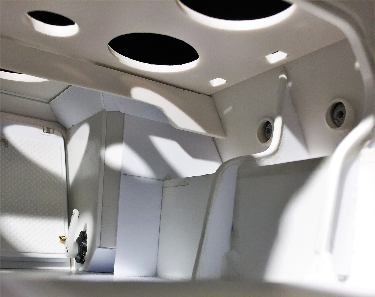

The interior was build primarily to be seen from the ramp but It also looks ok from the front as I want it to be generally accurate to a certain level because it can be seen when the top is lifted.

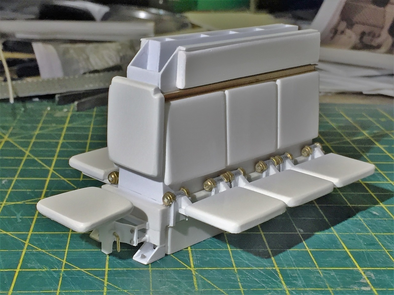

Here is the central seating module.
I am grateful to Geronimo at http://www.multi-board.com/board/index. ... /?pageNo=3 who listed pictures of his Marder under restoration. Looking at the disassembled interior, it was really helpful for the analysis. Although it is a 1A3 version, i can see that it is a modernized model of an earlier version and the seat arrangement has not changed. Also see interior pictures at http://www.simplissimo.de/kompanie/html ... nen_9.html
I was amazed to see that the fuel tank is within the central seating module. The infantry is actually sitting on top of 652 litres of Diesel fuel. I can imagine this being an issue for soldiers thinking about mines and IED. I was also surprised to see that although the seats can be made to fold (to normally facilitate the exit), there are fixed bins with equipment under the seats, rendering the seat folding somewhat useless in my view. I will need to build these bins as well. Notice the turret basked in the background.

The building has started. Dimensions and size were visually extrapolated the best I could from available pictures. At first, I wanted the seats to fold and I made hinges for them, but it became complicated later on and i just glued them down to speed up the building. The bins under the seats are not that great looking...better to keep the seat down.
Ludwigs Marder 1A1 1/16
This is the completed central module. It took 8 hours to build. It required a lot of analysis of pictures to get a sense of its shape and size. I tried my best to be as close as possible with the time that I decided to allocate to it.

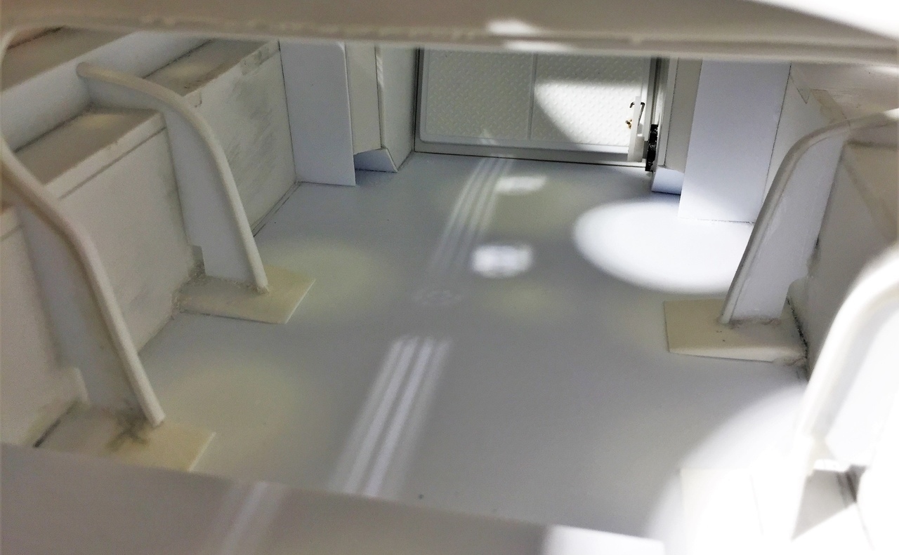

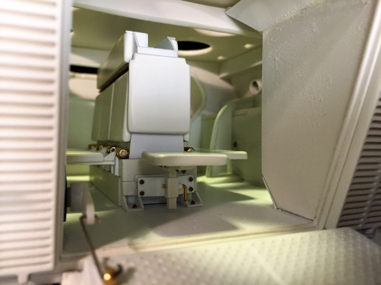

And here is the view from the rear ramp with the unit temporarily placed where it will be fixed later. I think the interior will look good and realistic once I put on the other details, tread plates, bins, periscopes, etc.

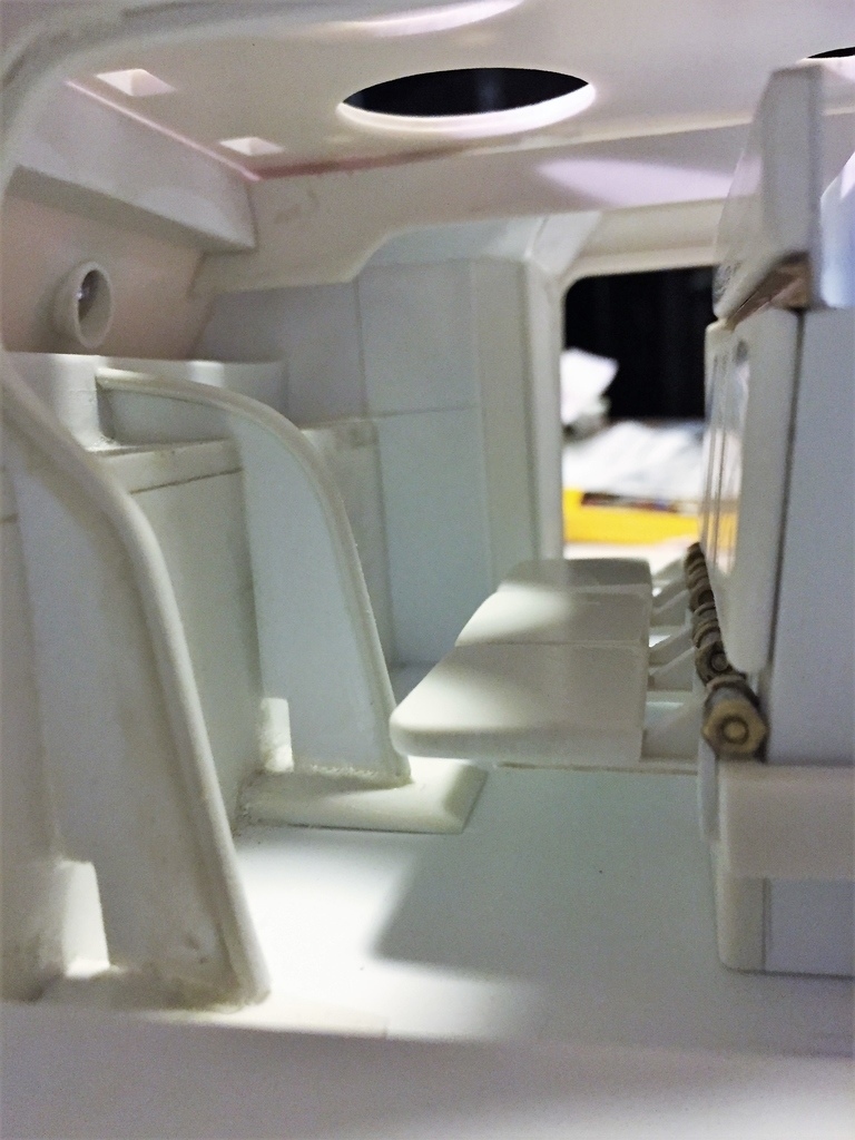

Other views. I was anxious to get this component done with and move on to something more exciting to build.
