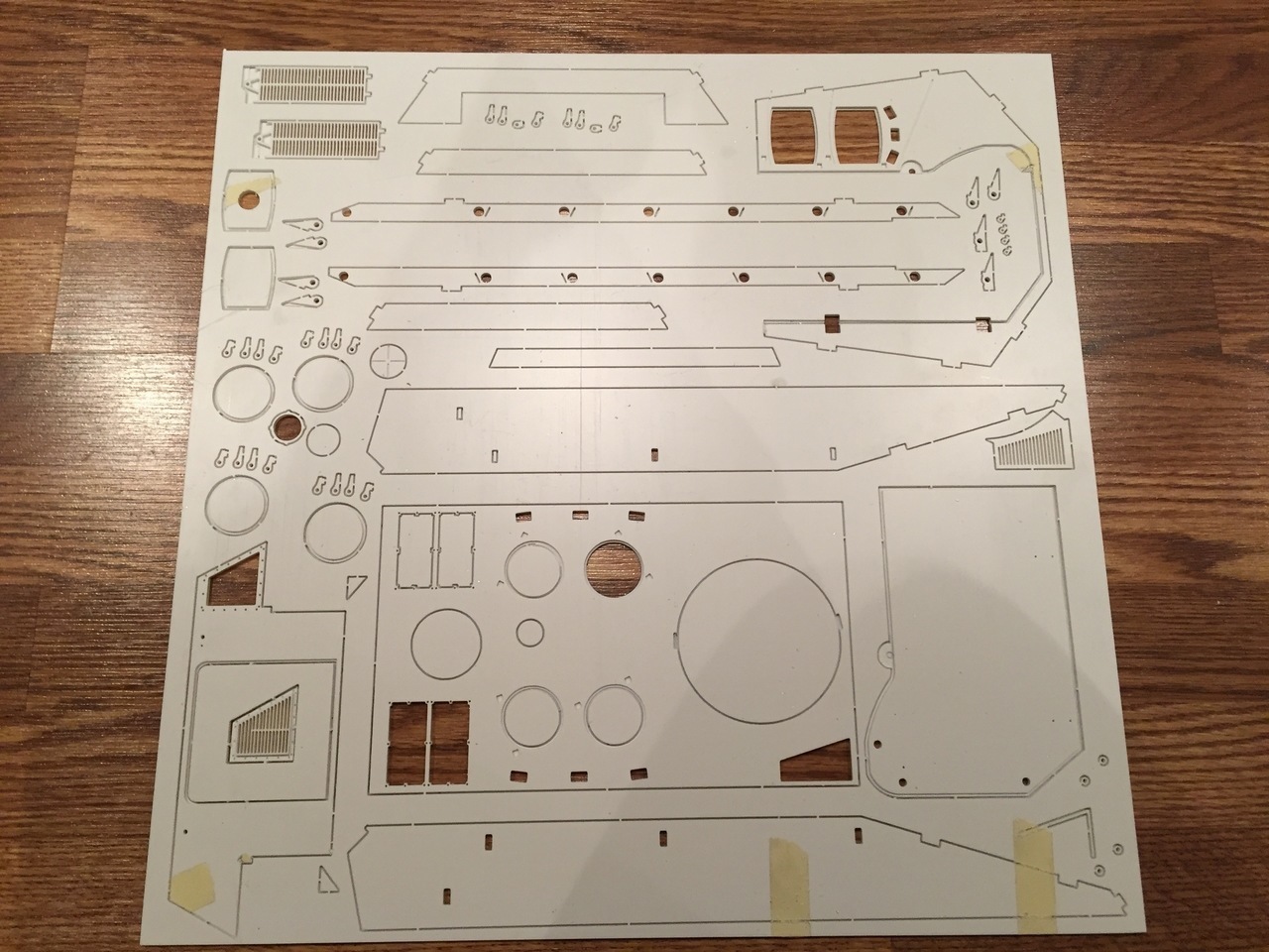

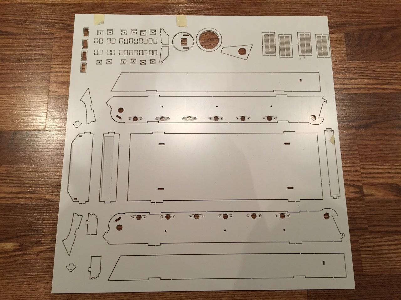

The core of the model is the Christian Ludwig basic kit of the Marder 1A1, below are the main hull parts. Although intimidating at first, I have learned to appreciate the good quality and measurements of Ludwigs kits on 2 of my previous projects (the M-113 and V-100). Hope this is the same for the Marder, i will see. You need to be a "builder" to truly enjoy a basic kit like this. The building challenges are obvious, potential and critical major mistakes lurking at every corner.

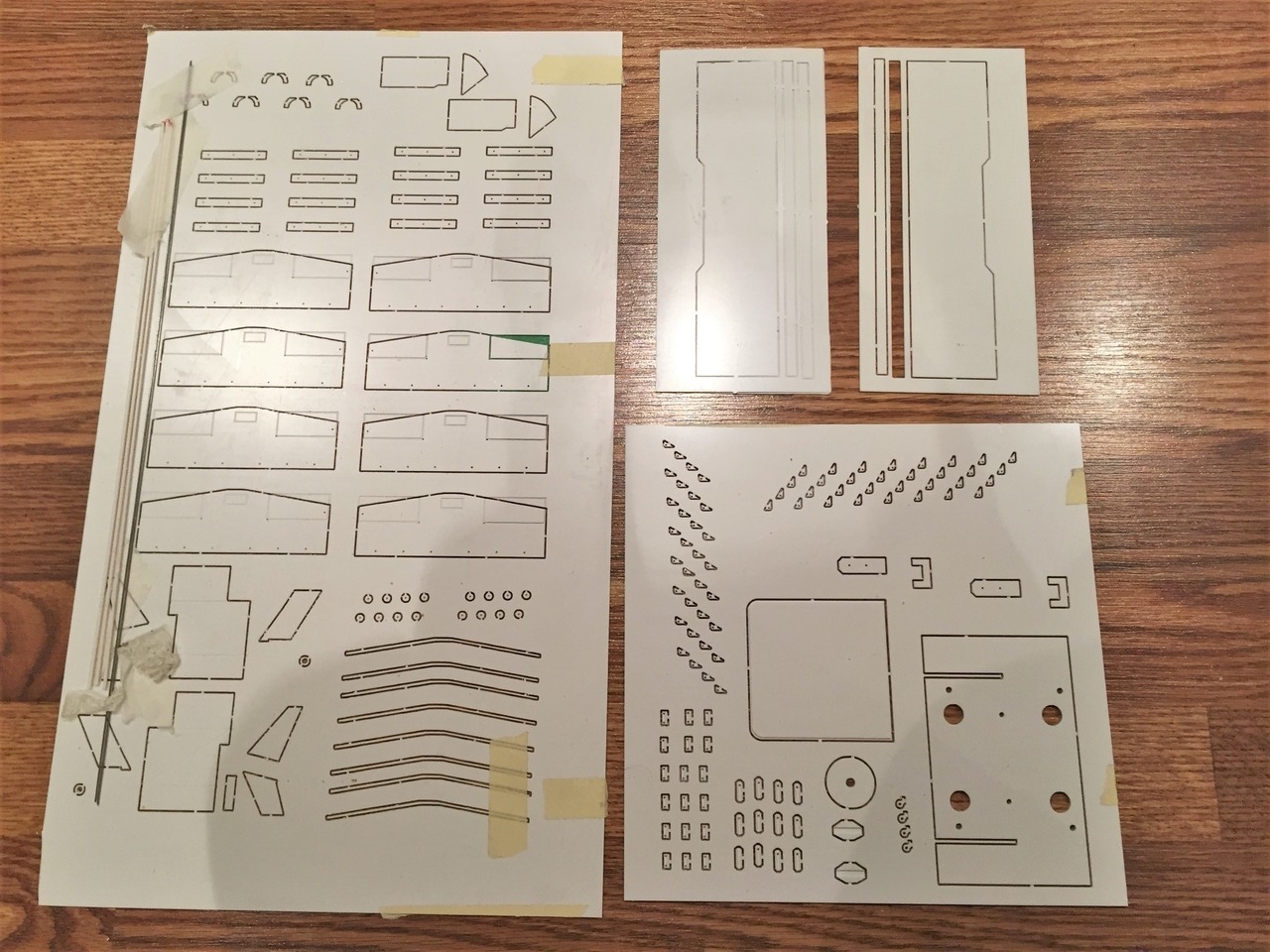

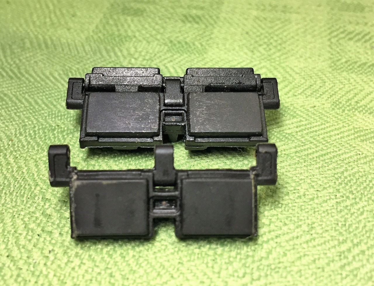

These are the schurzens (skirts) and the many hinges among other parts.

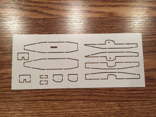

This is the rear machine gun section

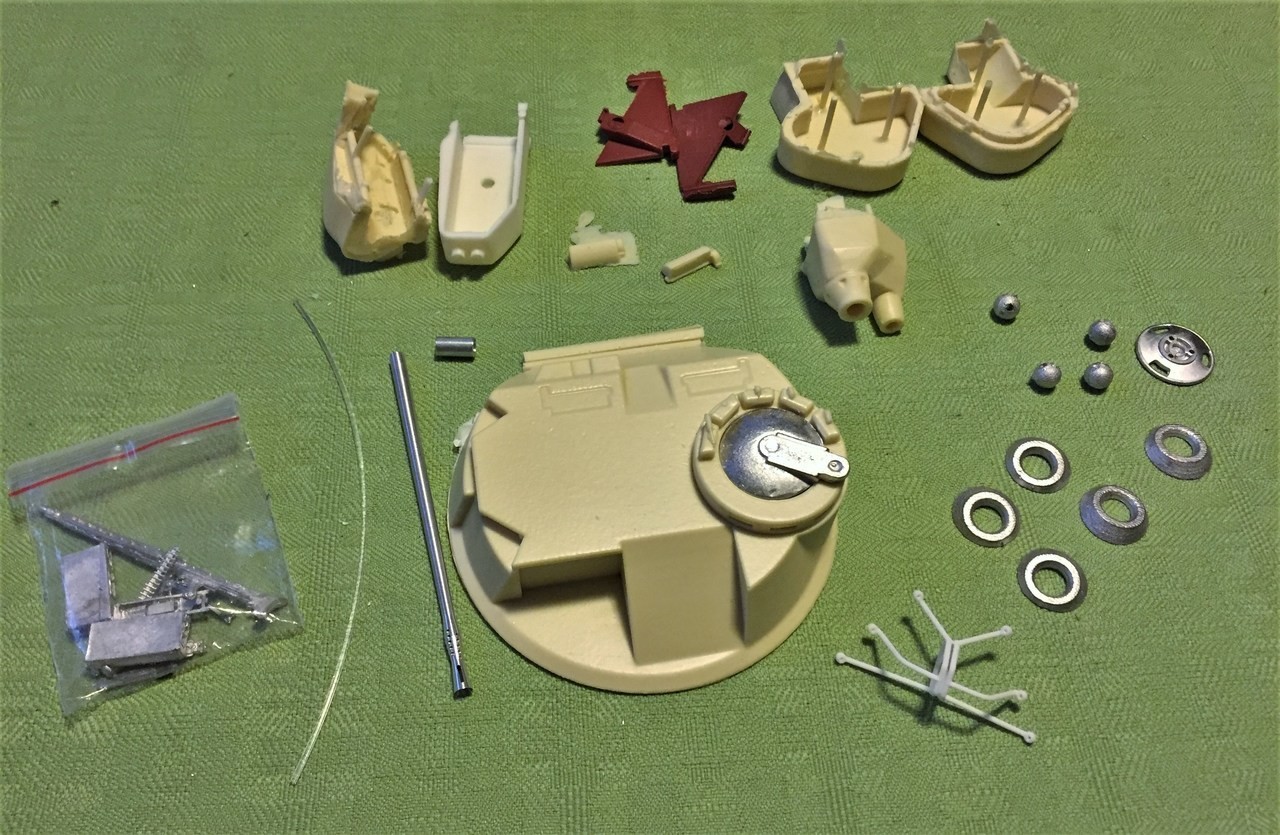

And this is the resin turret, 20mm metal gun and other Ludwigs parts to help me build the kit. Other items commercially available like headlights will be purchased separately. The rest will need to be scratch built.

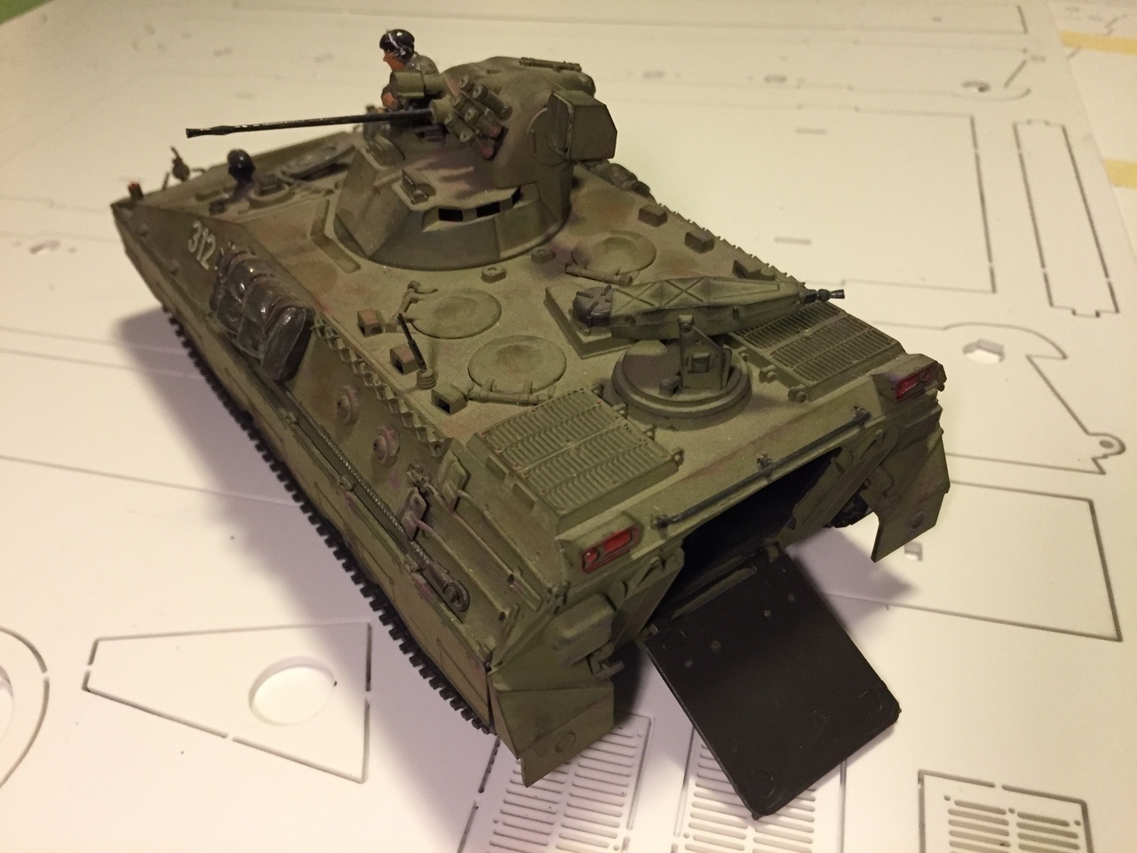

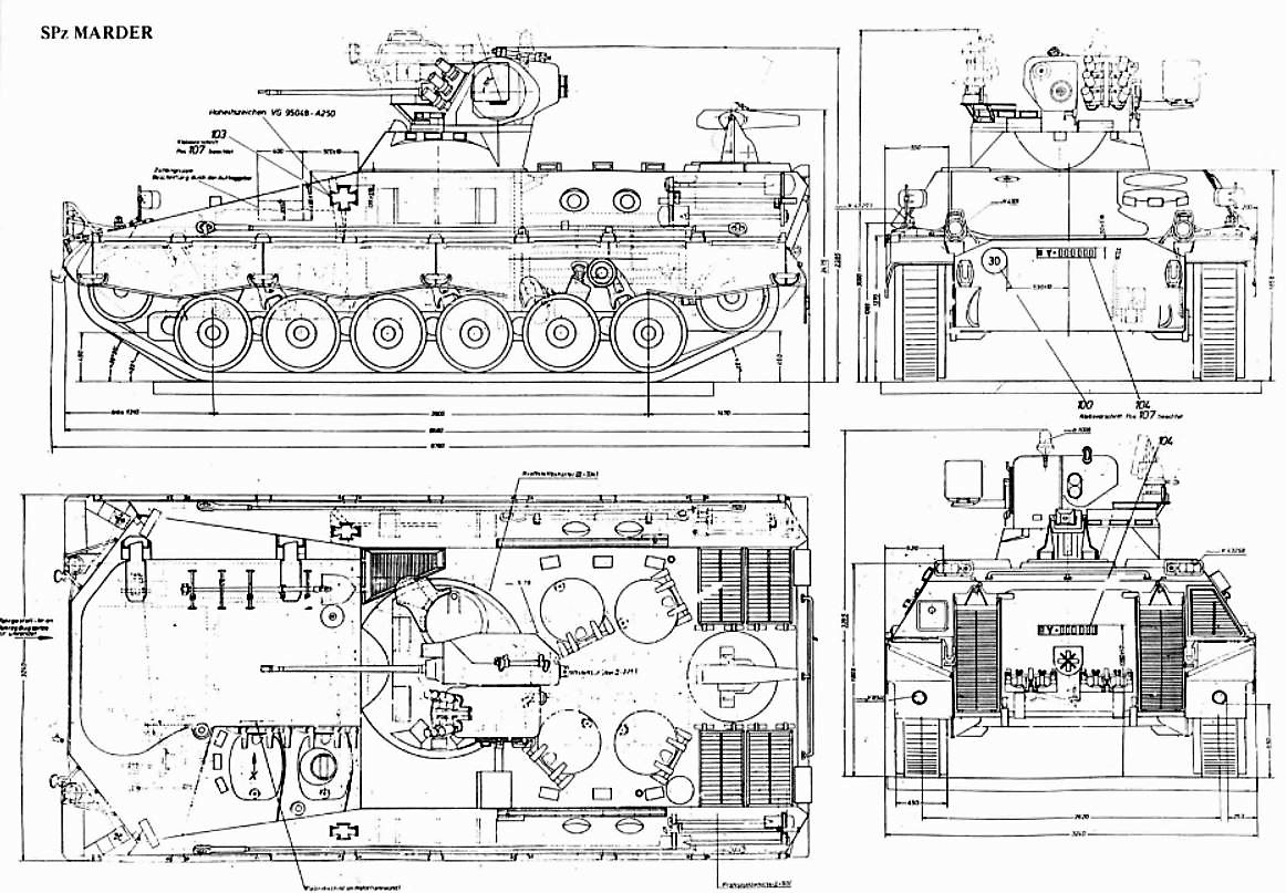

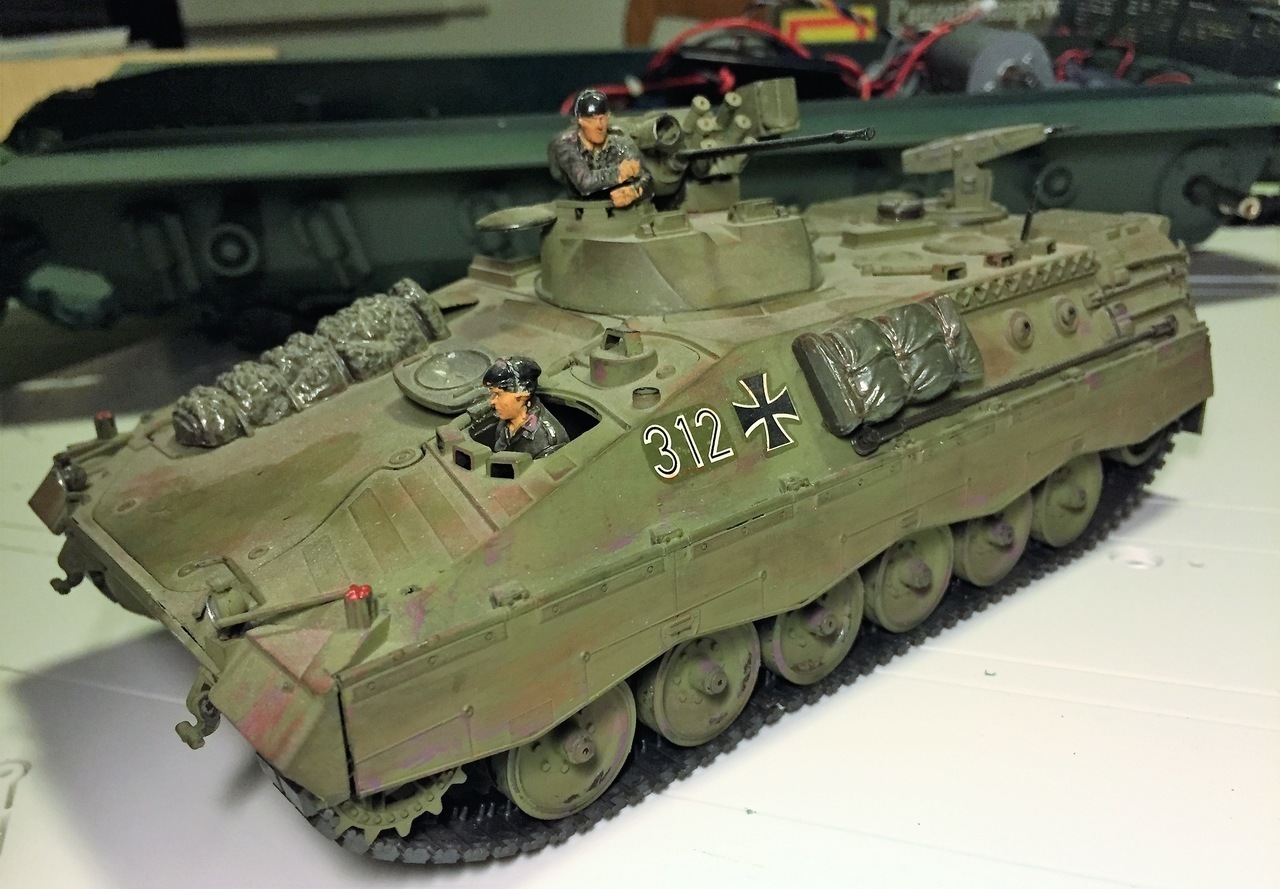

For the build, mainly for checking dimensions and 3D positioning of parts, I will be helped by my old 1/35 Tamiya Marder 1 that I built as a young kid in the 1970s. The formula (Tamiya part dimension divided by 1/35 and then divided by 16) provides much needed reassurances on such build.
Tamiya 1/35 Marder 1

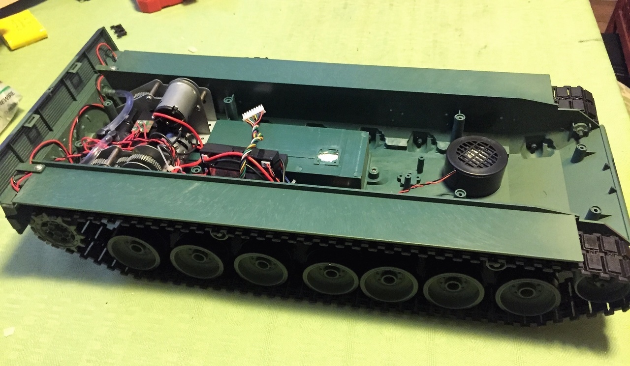

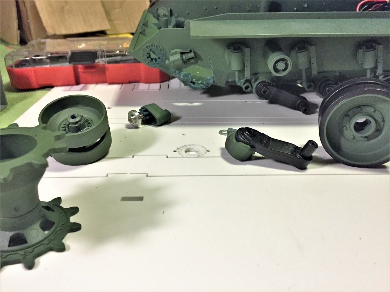

The plan is for Heng Long suspension to cut out of the Leopard 2 chassis and implanted on the Marder lower hull
Ludwigs Marder 1A1
Ludwigs Marder 1A1
The HL chassis provides a lot of basic materiel for the build:
- Roadwheels
- Sprockets
- Idlers and adjustable mounting
- Tracks
- Suspension arms, springs and mounting

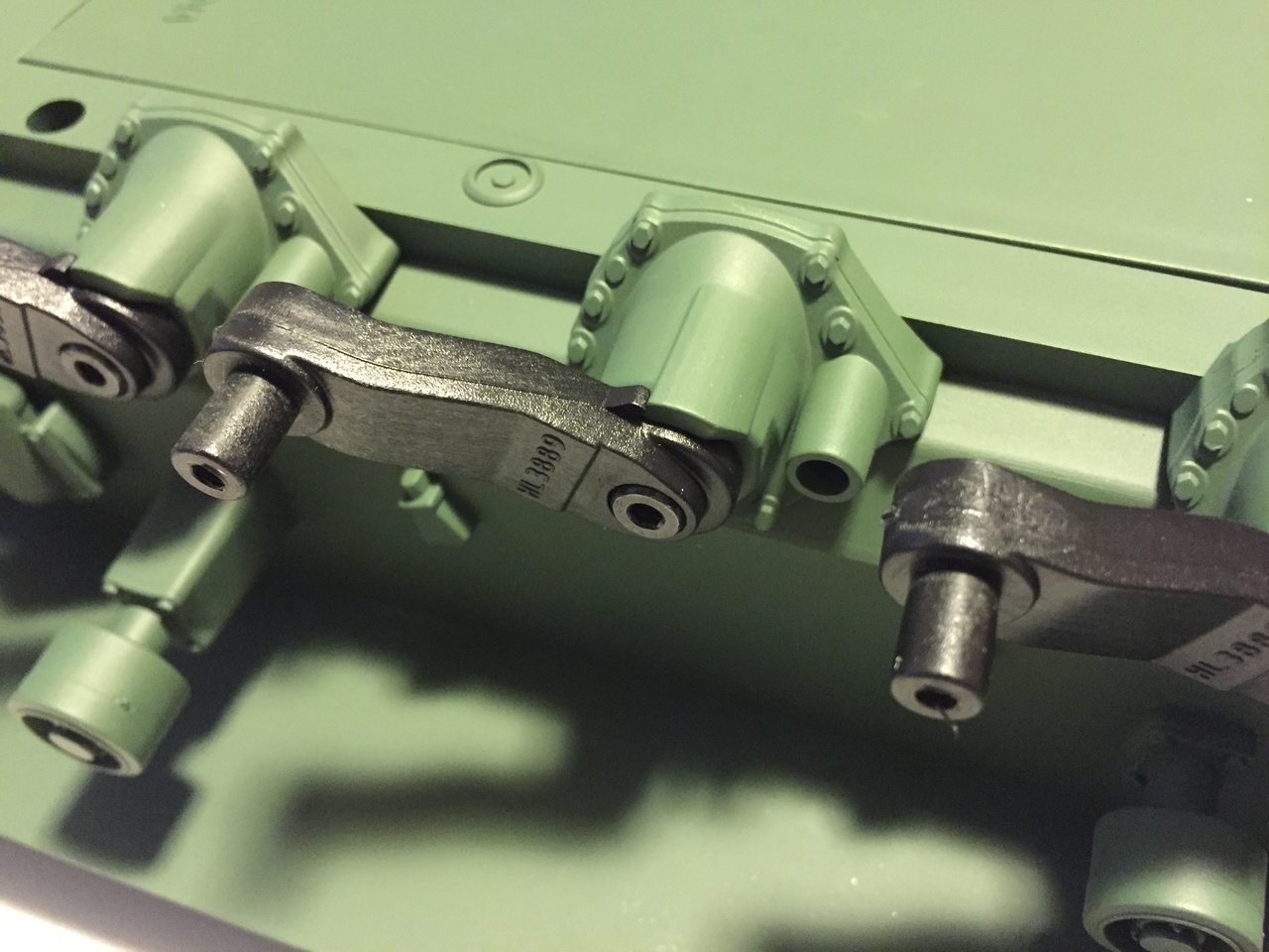

The HL self contained spring suspension units are really smooth and should work better than torsion bars. The model will be very light so no need for heavy metal parts here in my views. Individual suspension units will be cut out of the Leopard 2 hull, trimmed and inserted on the Ludwig hull after a bigger hole is drilled for each. Positioning them properly will be a key success factor, too much inside or outside will create issues for the tracks. So, lots of planning and checking required. Other items around the main suspension will be figured out later. That's the plan...

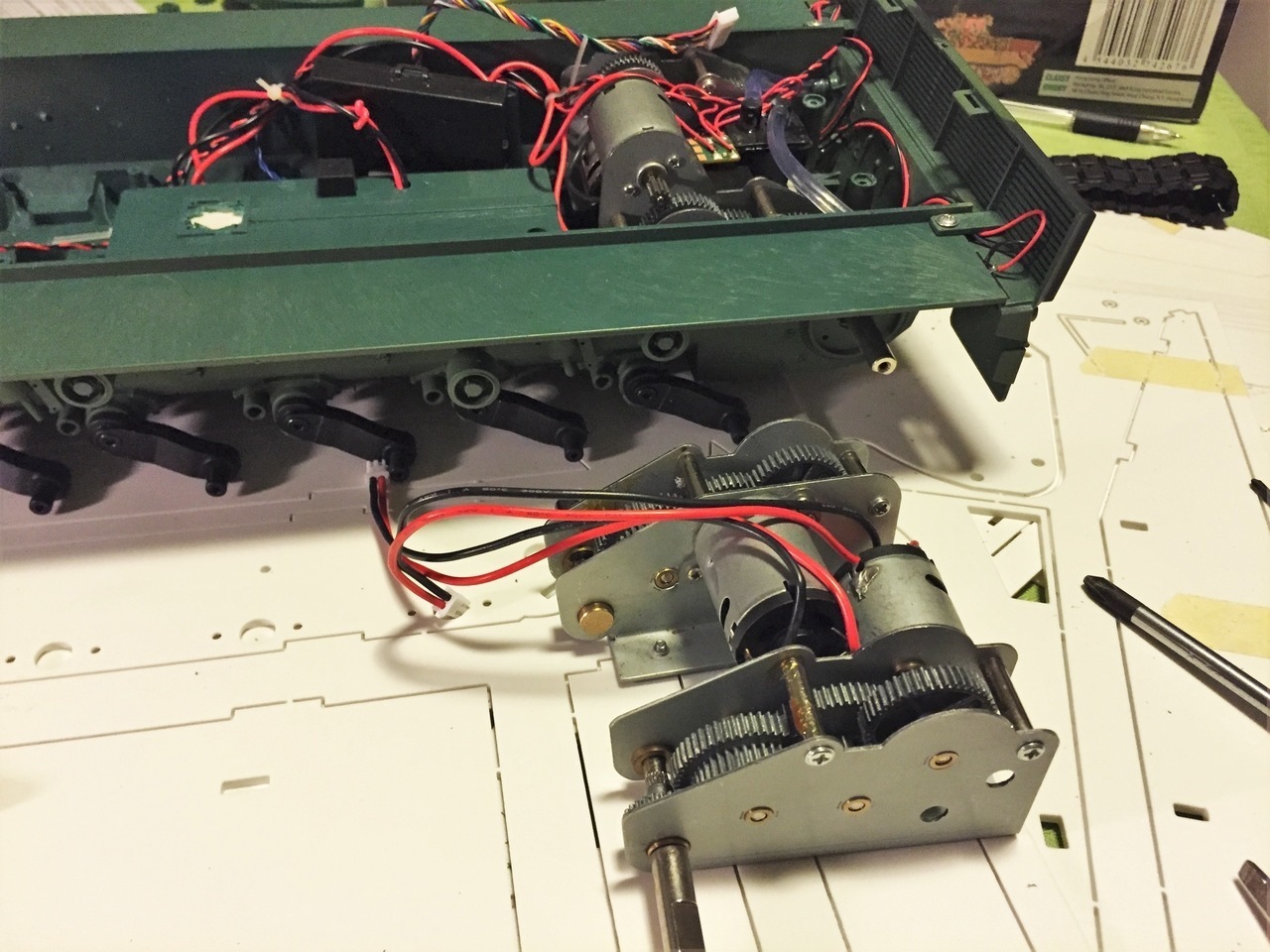

Although I am hoping to use the HL Leopard 2 metal gearbox, it could be tight. So, a Panzer IV gearbox is kept in reserve just in case.

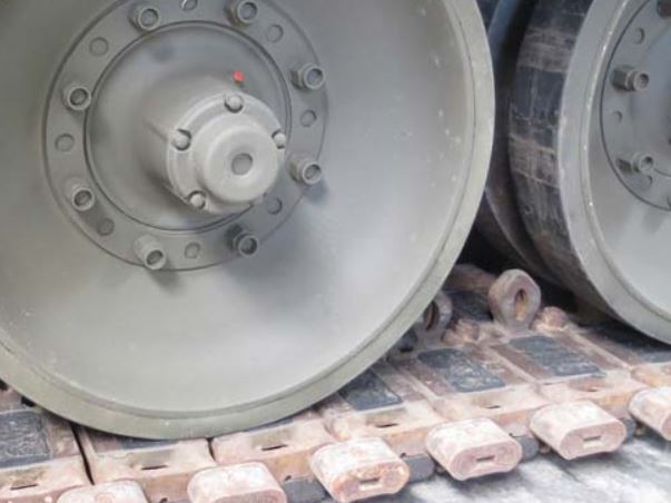

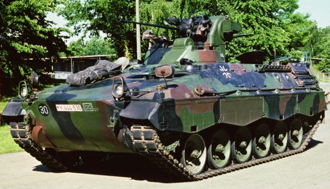

The tracks are very important for look and feel. All 1/16 Marder models I have seen have M-26 Pershing tracks. I want Diehl tracks on my Marder, as shown below;
Ludwigs Marder 1A1
Ludwigs Marder 1A1

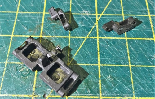

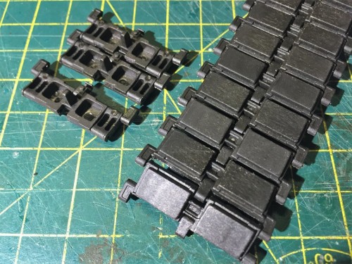

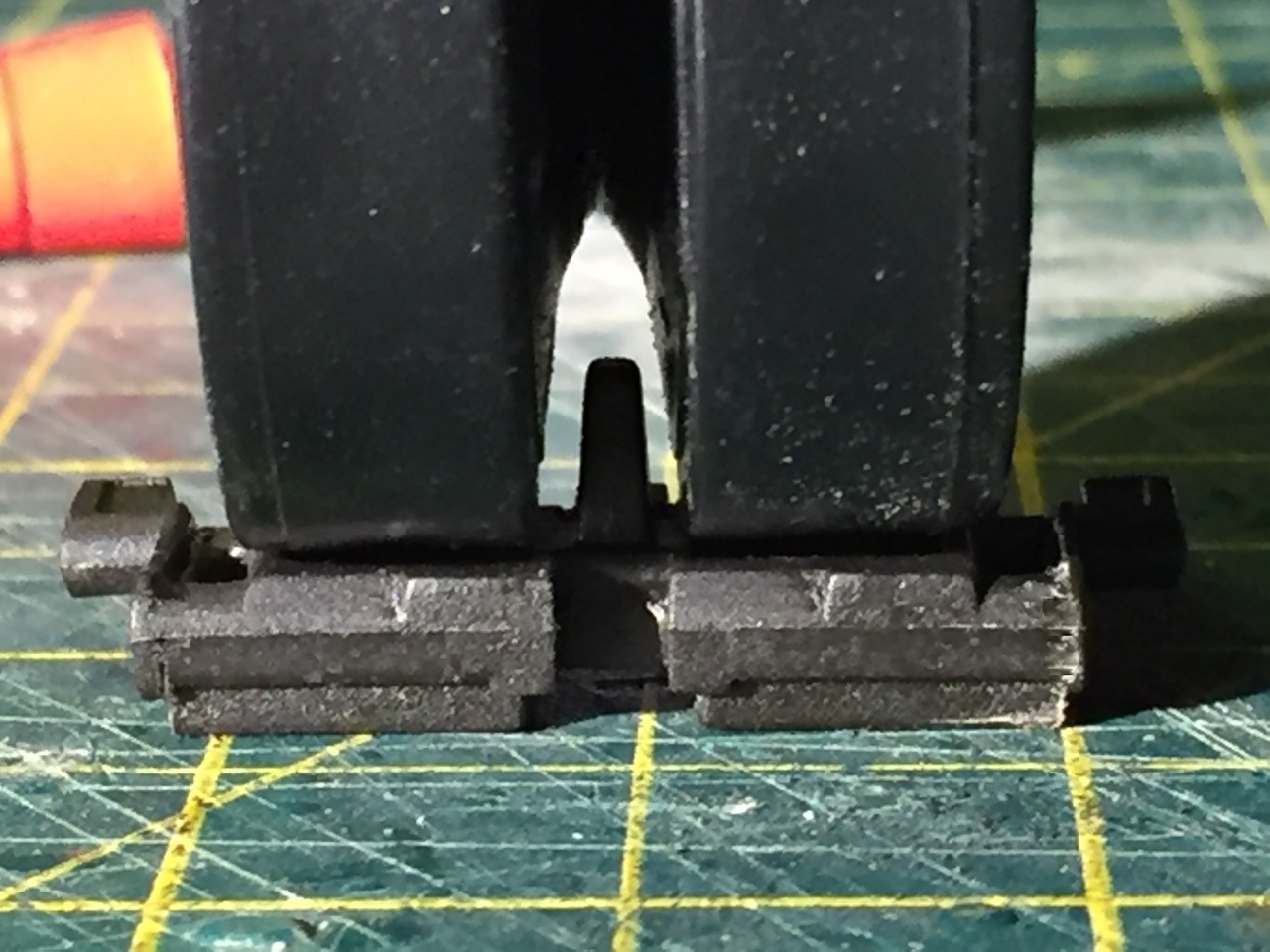

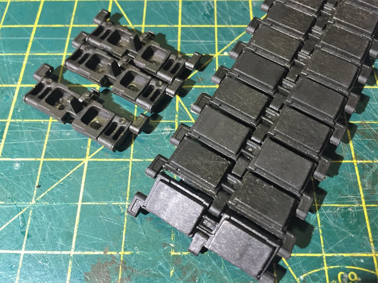

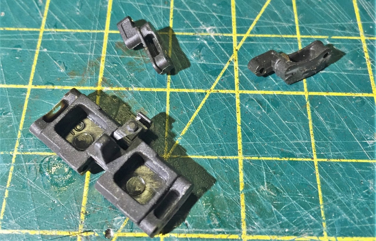

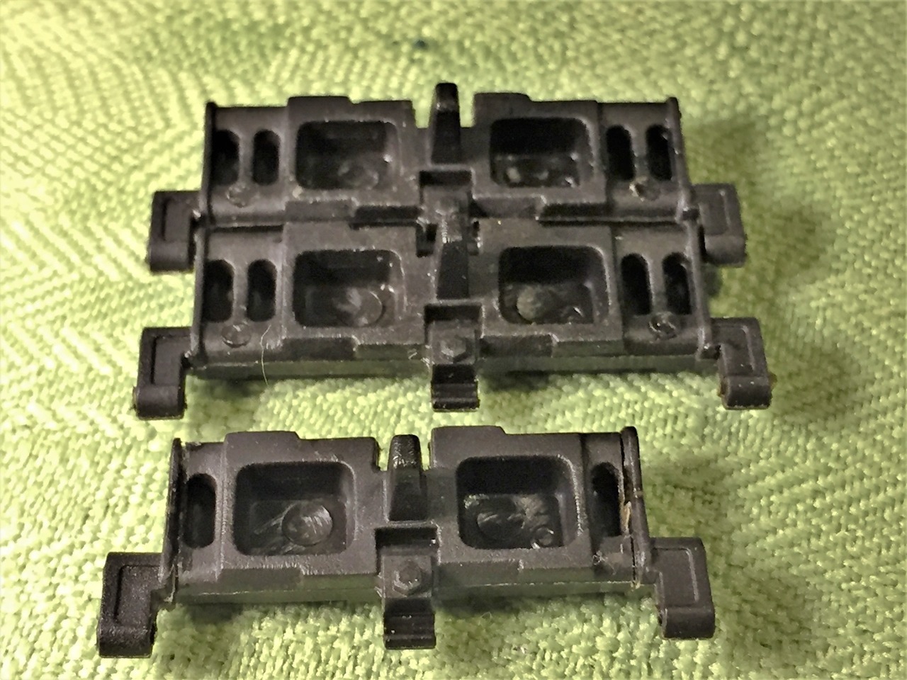

The Leopard 2 tracks are of the right type but at 40mm in width, the Leopard 2 tracks are too wide for the Marder so the plan is to reduce them in size.
Ludwigs Marder 1A1
Ludwigs Marder 1A1
Leopard 2 tracks are 2 extender sections on each side, the Marder has one as shown below
Ludwigs Marder 1A1
Ludwigs Marder 1A1
Need to remove at least 5mm in width so removing one of the 2 extender on both ends of each track link provides the required reduction for size and accuracy.
Ludwigs Marder 1A1
Ludwigs Marder 1A1
Track ends are reduced and glued back to each track. Before (top) and after (below). Track width are now 35mm, which I think will be acceptable. Yes, it will take a few hours to cover the approx 150 links needed.

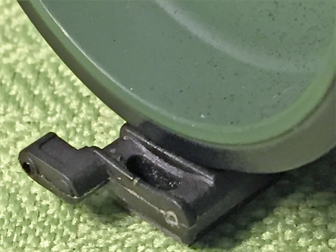

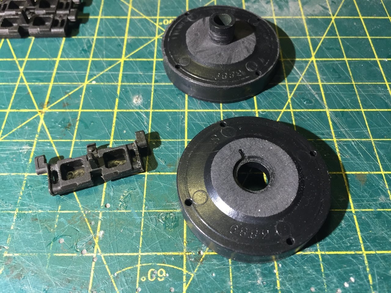

The road wheels are also a bit too wide in my views so I removed a bit of the spacer between the 2 wheels, it helps without altering the wheels themselves.

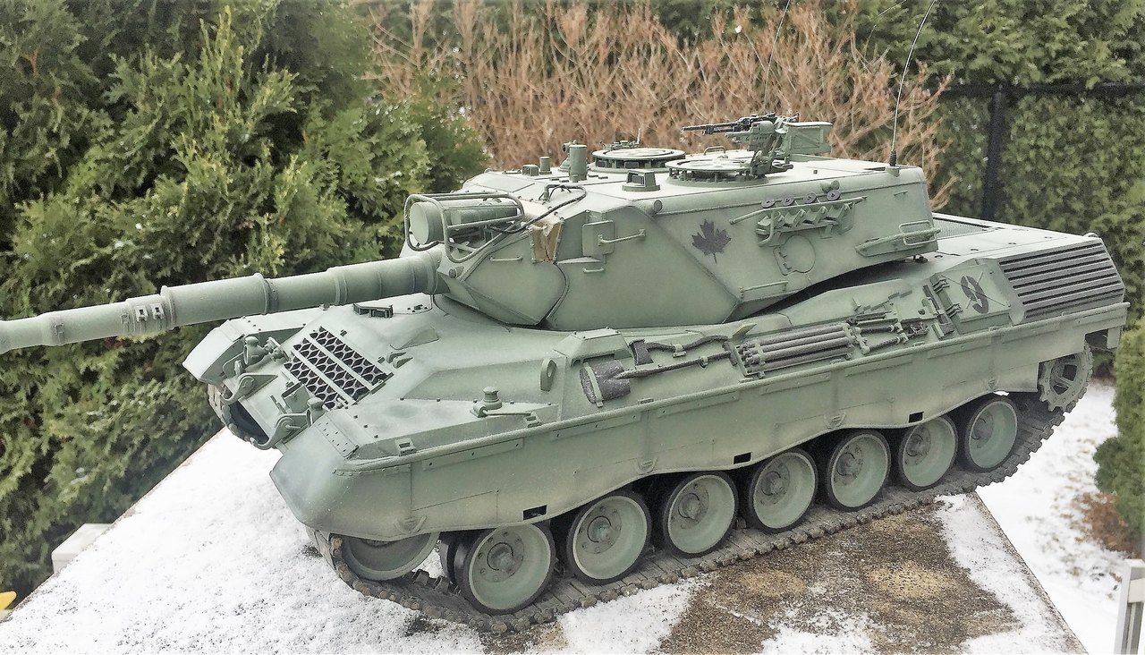

Raminator wrote: You'll need a Leopard or MBT-70 to go with it, next.

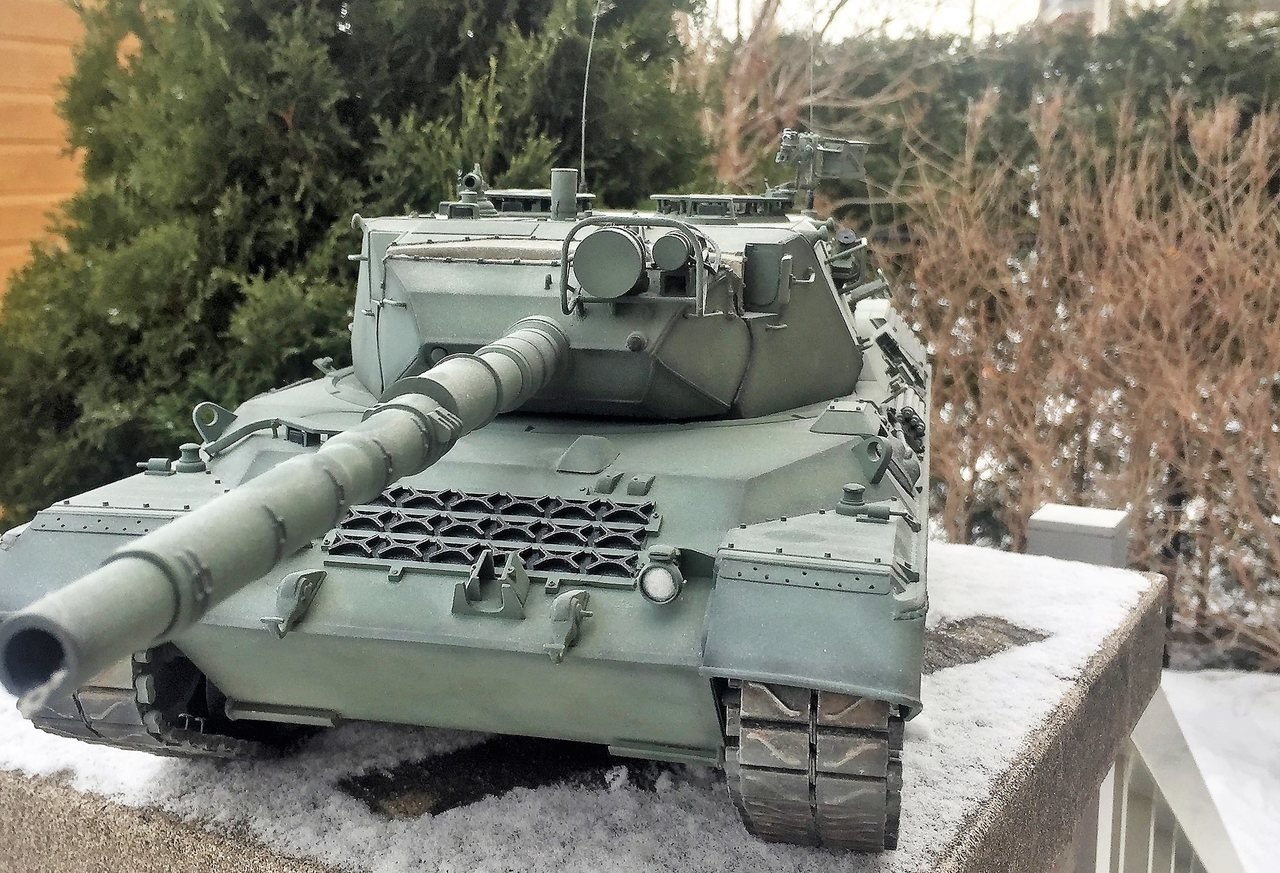

Yes, here is my old 1/16 Tamiya Leopard in Canadian C1 Late version that I converted 10 years ago, a rebuilt of the first 70s RC release that came with gearbox but pretty much nothing else. It is in much need of a complete overhaul now to bring it to latest standards with control board, new gearbox, new tracks, sound, gun recoil, elevation... everything. Another project in the plans and a good cold war partner to the Marder.
