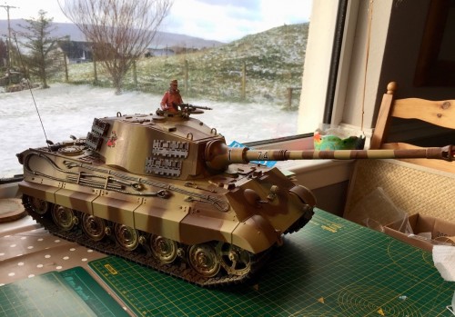

A final bit of tidying up, and here's the final update pic. I'm going to experiment with Tamiya's own weathering kits but, for the moment, this represents tank recently arrived to its unit on the Eastern Front from the production line.
Of course, it's first commander would not have been pink, but painting him will probably be better placed in another section...where he can compete with Painless's infamous scary Joe. Thus, he's not part of this build..as such.
- Tamiya KT blitz build update pic.
