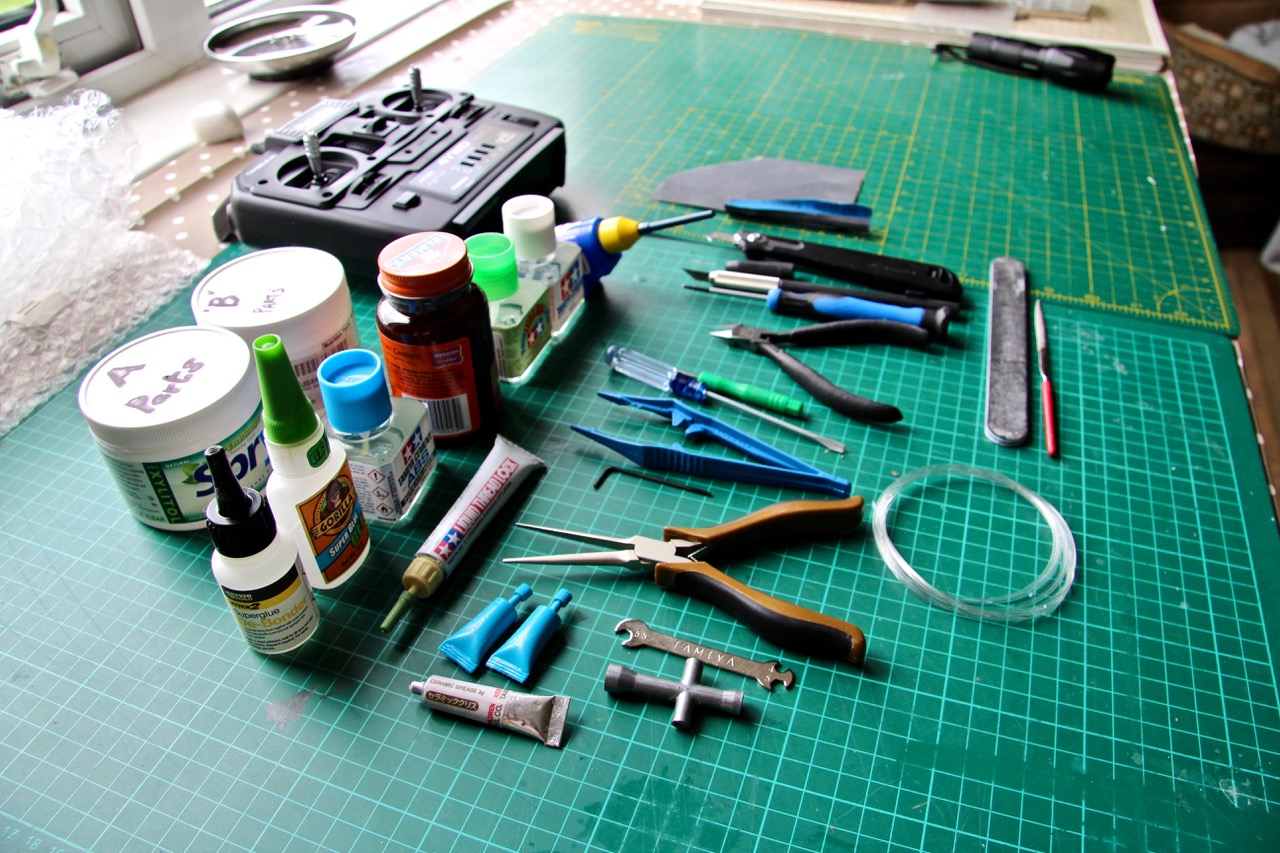

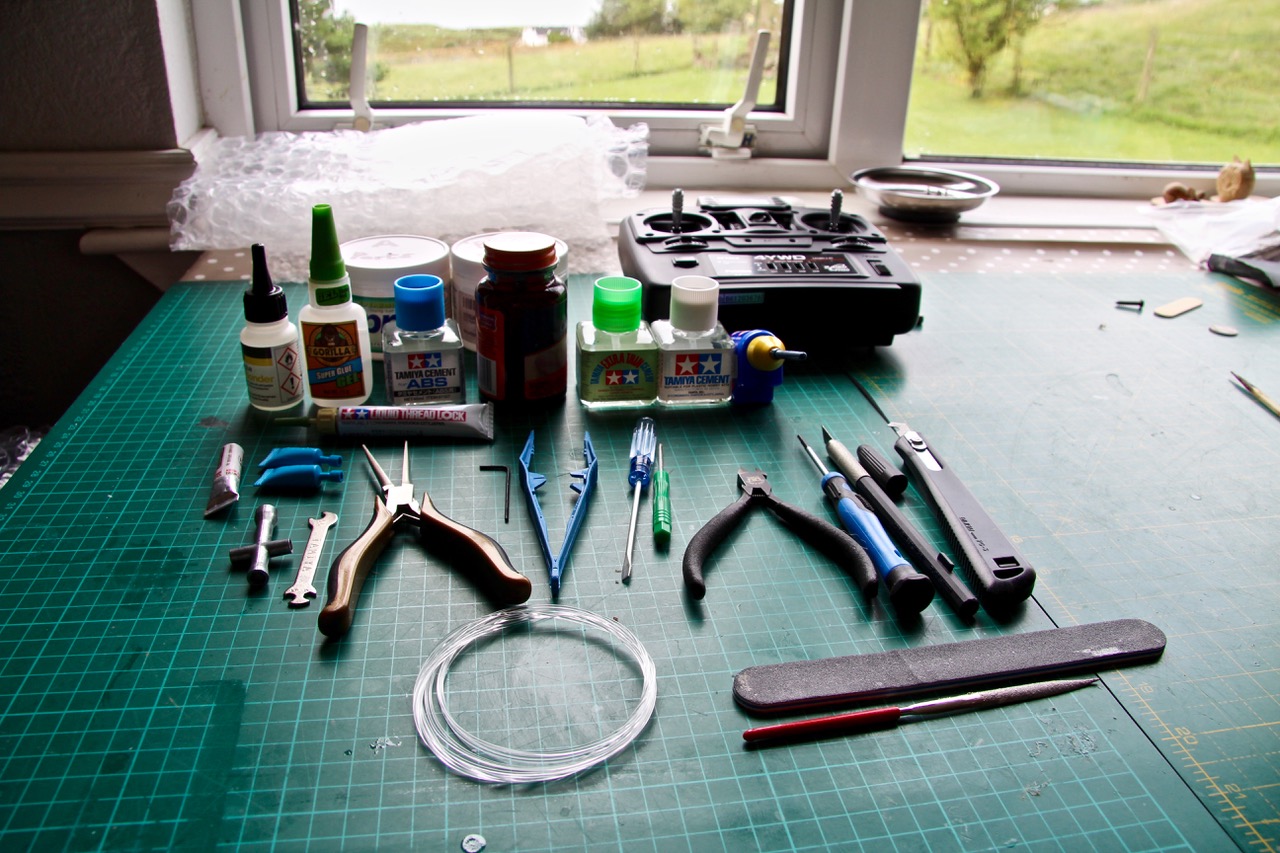

Next, the tools. I already had some choice ones from previous builds (Trumpeter razor saw and many more), but I really wanted to follow the instruction manual to the letter. That meant acquiring specific products, such as the mysterious
'rubber cement', as well as Tamiya metal primer etc. After the build, I'll see what needs upgrading. For the moment though, I want to see how good or bad the Tamiya KT is in bog standard form. :|
The Tools:
The right tools for the job- probably a bit of overkill
Another angle on the tools
A problem with backlighting, and so I've added a few different shots.
Emergency tool- when all others fail
Water of Life tool: an essential in any model Tanker's toolbox :haha: 8O 8O

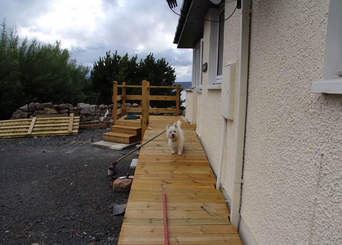

In preparation for the Cromwell's 'field trials' (no joke in my case, as my garden's surrounded by fields :haha: ), and for access to the KT and other tanks, I've been building a ramp to enable my Tanks to get in and out of the house under their own steam- so to speak. It's almost complete. But here my sternest critic is telling me how it should be done. She's a Backseat builder: a four-legged one at that .. :haha:
So, here's the Tank-ramp:
Tank-ramp under construction
This is the sort of trouble you go to, when the addiction is uncontrolled :-< :haha:
On a positive note though, the next time I break my ankle and find myself in a wheelchair again; I'll be properly prepared :thumbup:

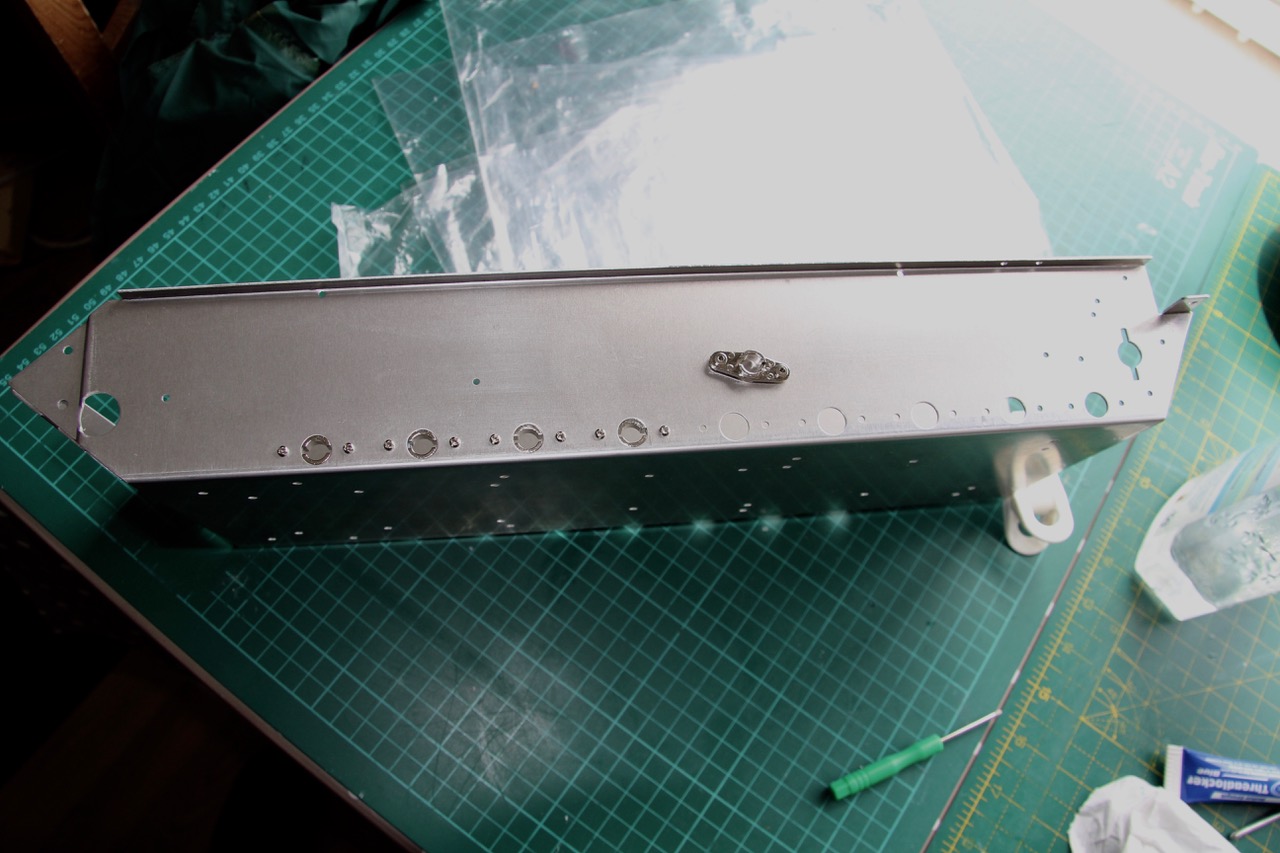

The package contents:

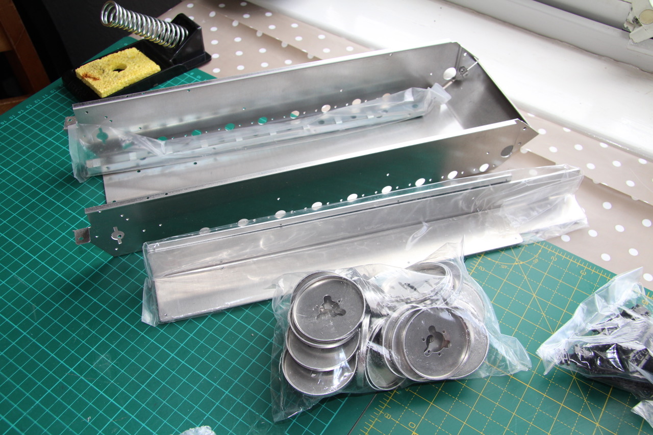

First, the metal bits. I'm going to clean them and spray them with Tamiya metal Primer. Them they'll get a coat of Humbrol primer from a rattle can.
KT metal bits
KT metal bits
I have to say the hull and rolling gear bits have an encouraging precision feel. That's just as well, considering the arm and a leg that Tamiya products cost! ;) I'll clean them up with some acrylic thinner, in readiness for the metal primer.

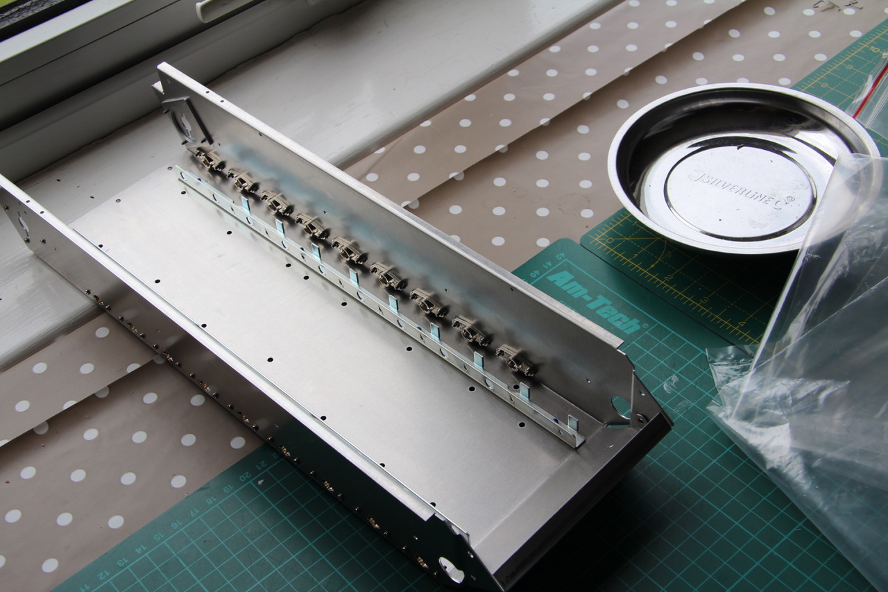

Fitting Tamiya suspension housings after priming
Having primed the hull, I started fitting the suspension housings, being careful to fit them the right way round. Luckily, the illustrations in the build manual are clear and logical :thumbup: (unlike me sometimes :haha: )

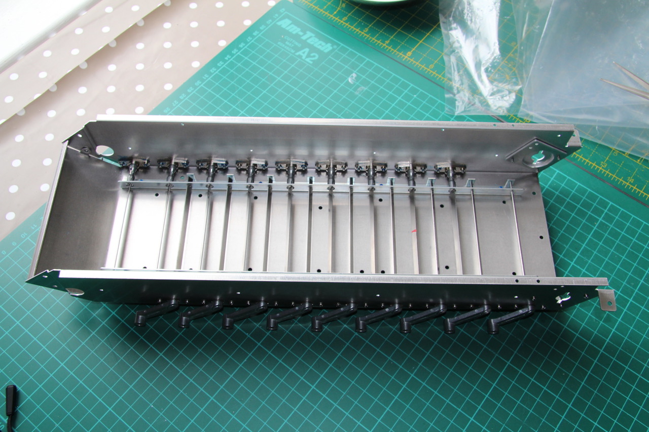

Now, it's time to fit the torsion bar stays. They're a bit fiddly for ageing fingers, and require a little dexterity and care to fit, but fit well when you have the knack. :think:
Fitting the Torsion bar stays
Torsion bars fitted
Torsion bars fitted
The torsion bars won't fit if you're a millimetre or two out when pushing them in. They also require a tricky twist to lock them in. After a few successful inserts, the rest go in with increasing ease, without the need to resort to the Malt Whiskey
'special tool' and choice expletives :lolno: :haha:

Now, can I ask a favour please. Out of curiosity, what is the diameter of those tortion bars?
Mick.
The tamiya ones (unlike taigen) are flat not round

Son of a gun-ner wrote: Now, can I ask a favour please. Out of curiosity, what is the diameter of those tortion bars?
Mick.
Oh, ok, thank you Tom.
Yep, if you click on the pic to enlarge it, Mick, you'll see that the bars are actually flat. They're probably about 8mm across I'd guess, but never thought to measure them. The key thing here is that they make for a precise fit. Almost too
precise to fit :D

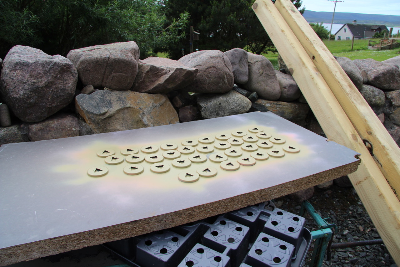

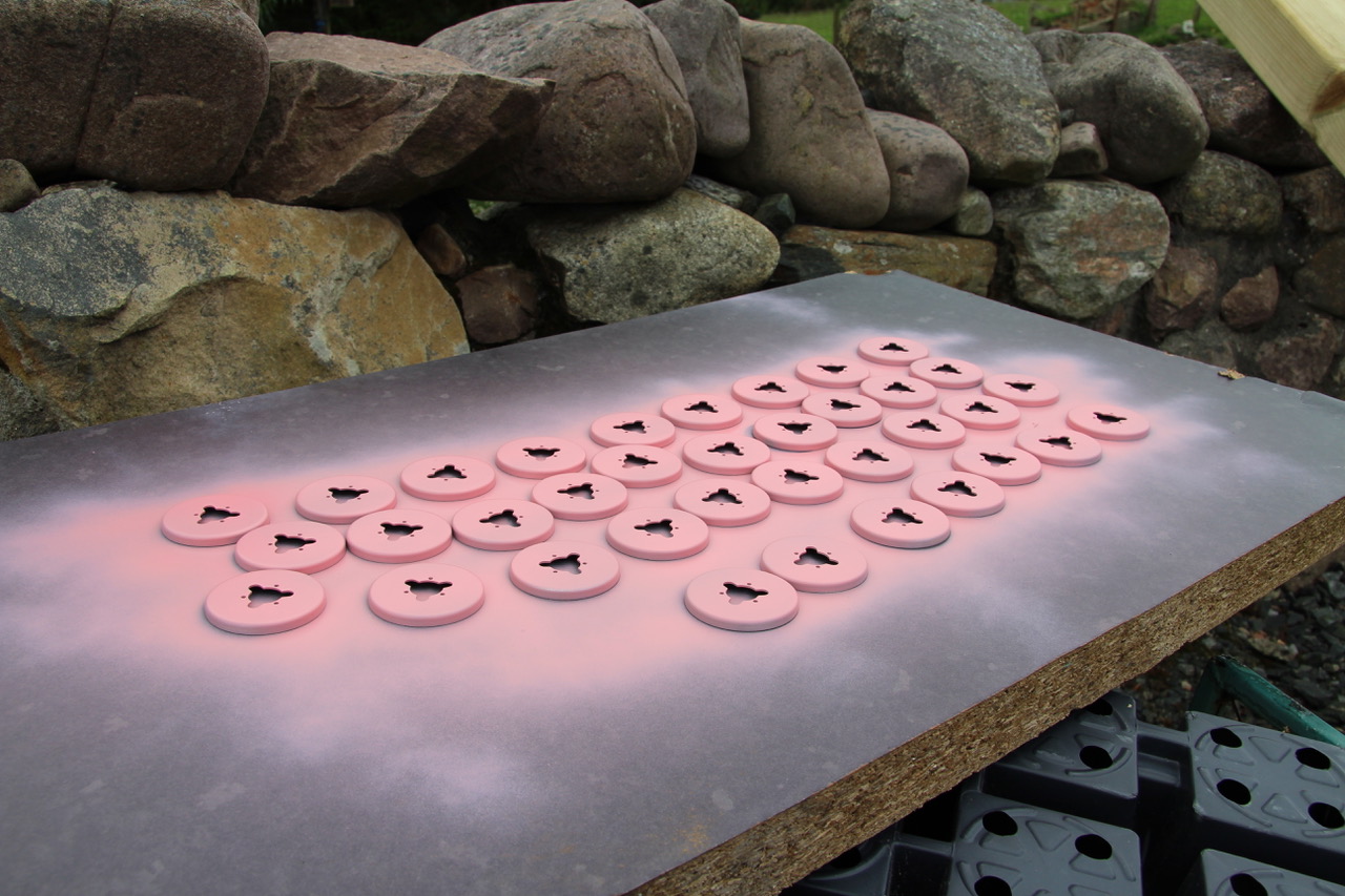

Now for the wheels...
Priming metal wheel parts
I don't happen to have a decent rattle can of red-oxide primer hanging around, so after using Tamiya metal primer, I opted for this fetching shade of pink primer (Tamiya surface primer) :P
Pretty in Pink
Pretty in Pink

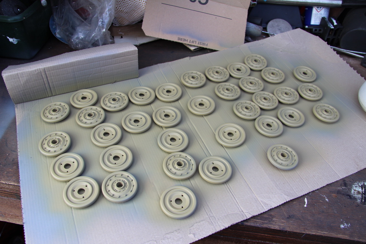

After priming the plastic parts of the running gear, I painted them with Tamiya Dunkelgelb:
A dose of dunkelgelb..
