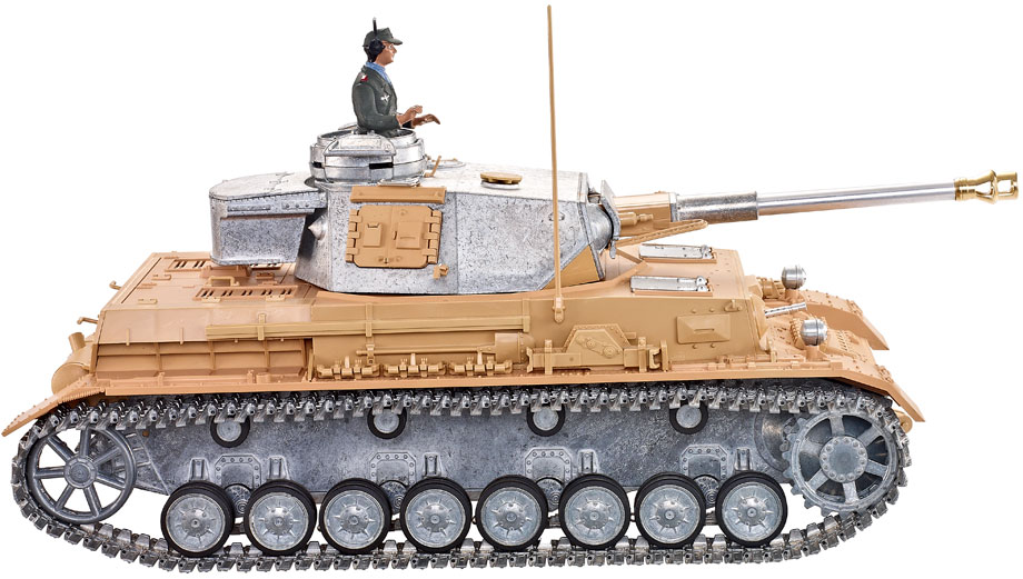

Here the Heng Long (L) and Taigen (R) ausf. F2s reveal how the storage bin stands quite proud of the Turret roof. While this allows HL/Taigen models to retain the standard HL elevation unit, it the rivet-counter's refined ideas of authenticity and accuracy!.

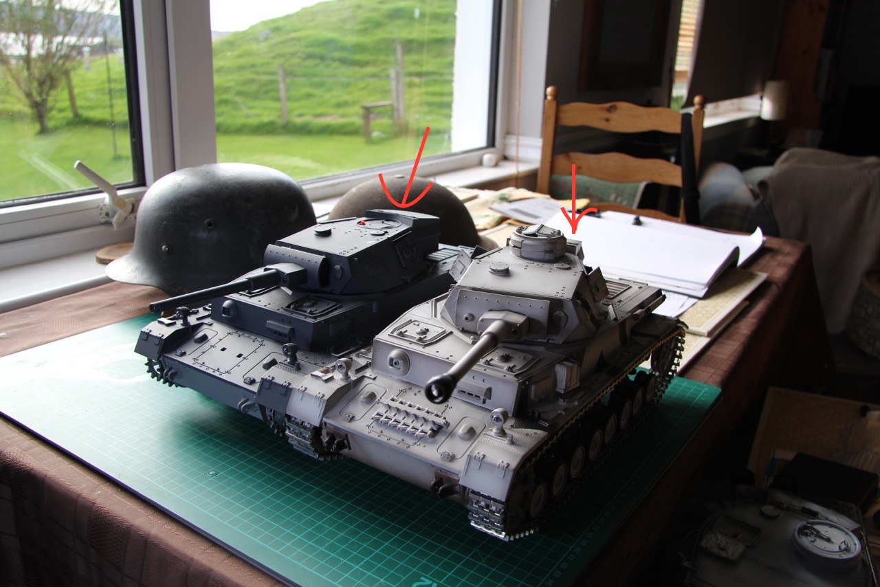

Then.... these are a few pointers to watch out for. They're areas on the tank that HL and Taigen have erred on badly.
The engine deck behind the turret, should slope away from the Turret. much as the frontal area does. The top of the storage bin on the turret should be (in most instances) flush with the top of the turret roof, and not obscure, or encroach at all on the Commander's Cupola.
  It's a glaring error. Incidentally, the Taigen upper hull is identical to the Heng  Long version, and so they are both guilty of poisoning the tank's profile. Trumpeter produce Panzer IVs (G and J models) with the correct bin shape and orientation, and so do Tamiya with their ausf, J.

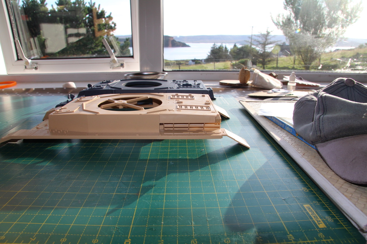

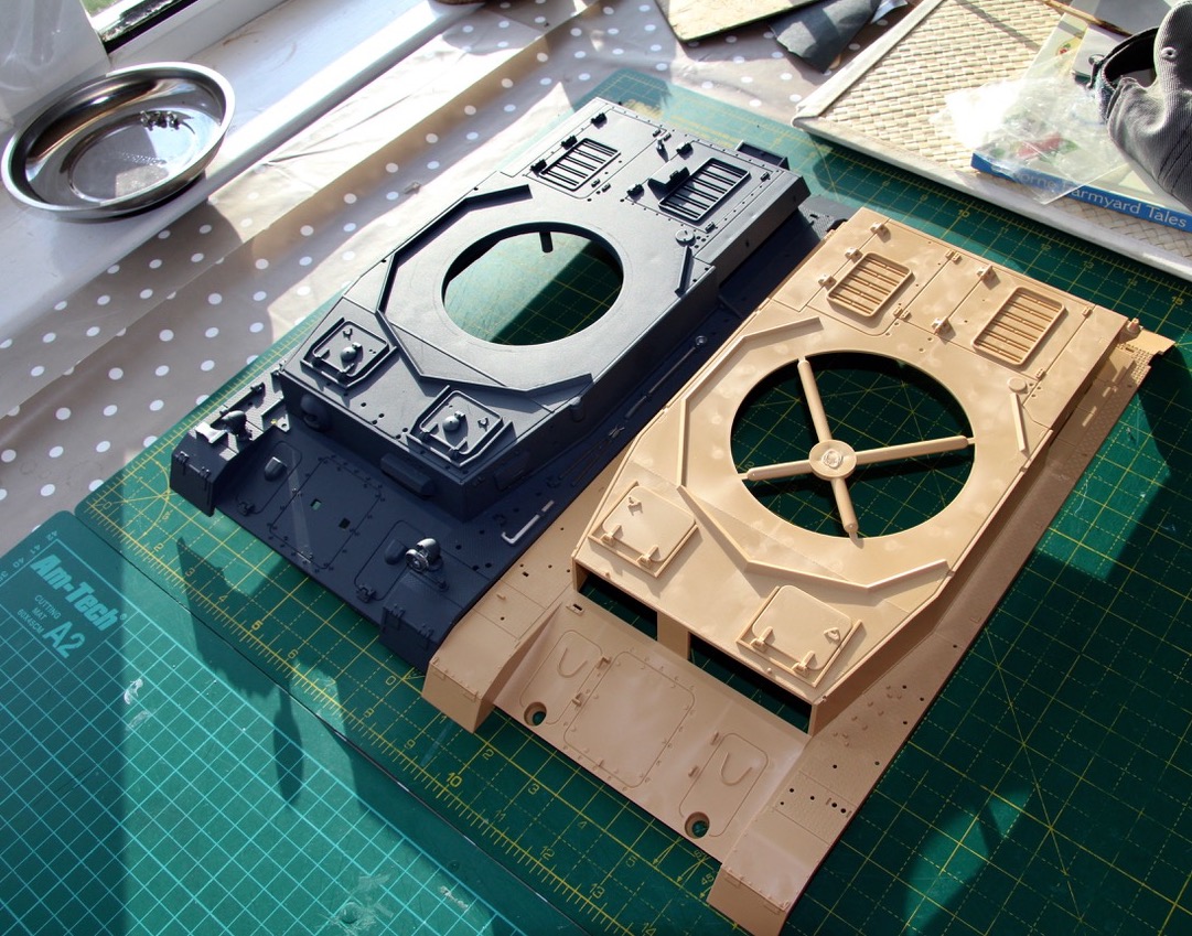

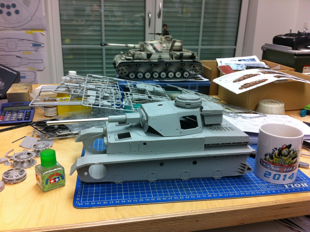

...now for that slope. For comparative purposes, I've set a Tamiya ausf. J upper hull  (fawn- foreground) beside a Heng Long (grey) offering. Ignore the detail differences between F2/G and J models. The basic shapes  and outlines should be broadly the same.
The Tamiya version has the correct shape. The HL (also Taigen) unit has a level engine deck, and that's plainly wrong

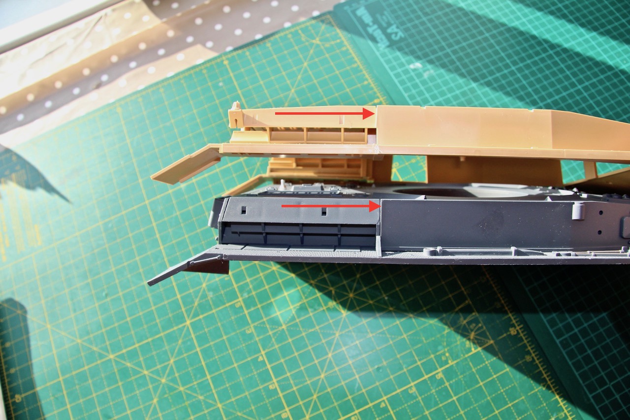

The arrows serve to indicate the degree of slope: none on the Taigen HL and a few degrees on the Tamiya. Click to enlarge the pics

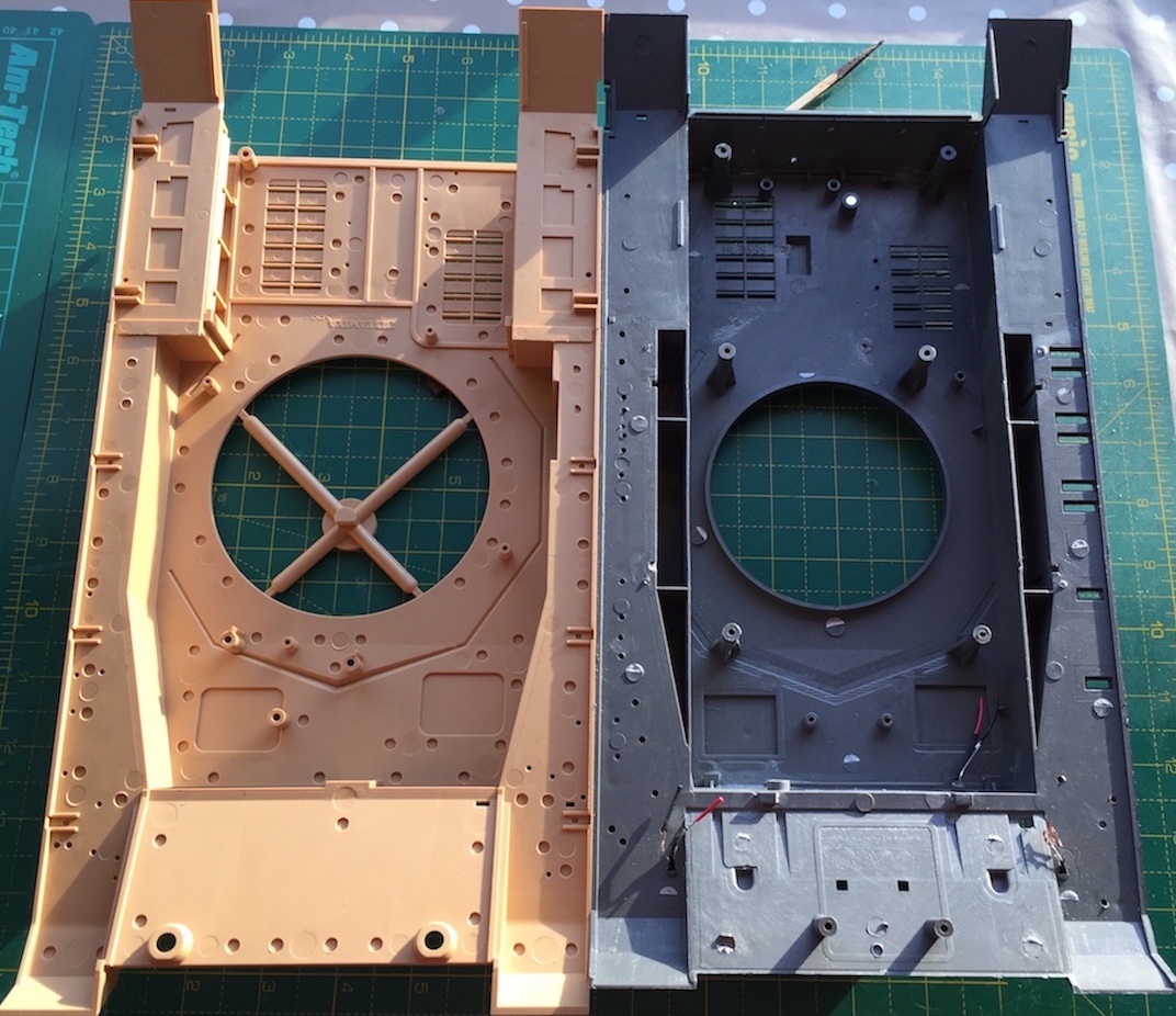

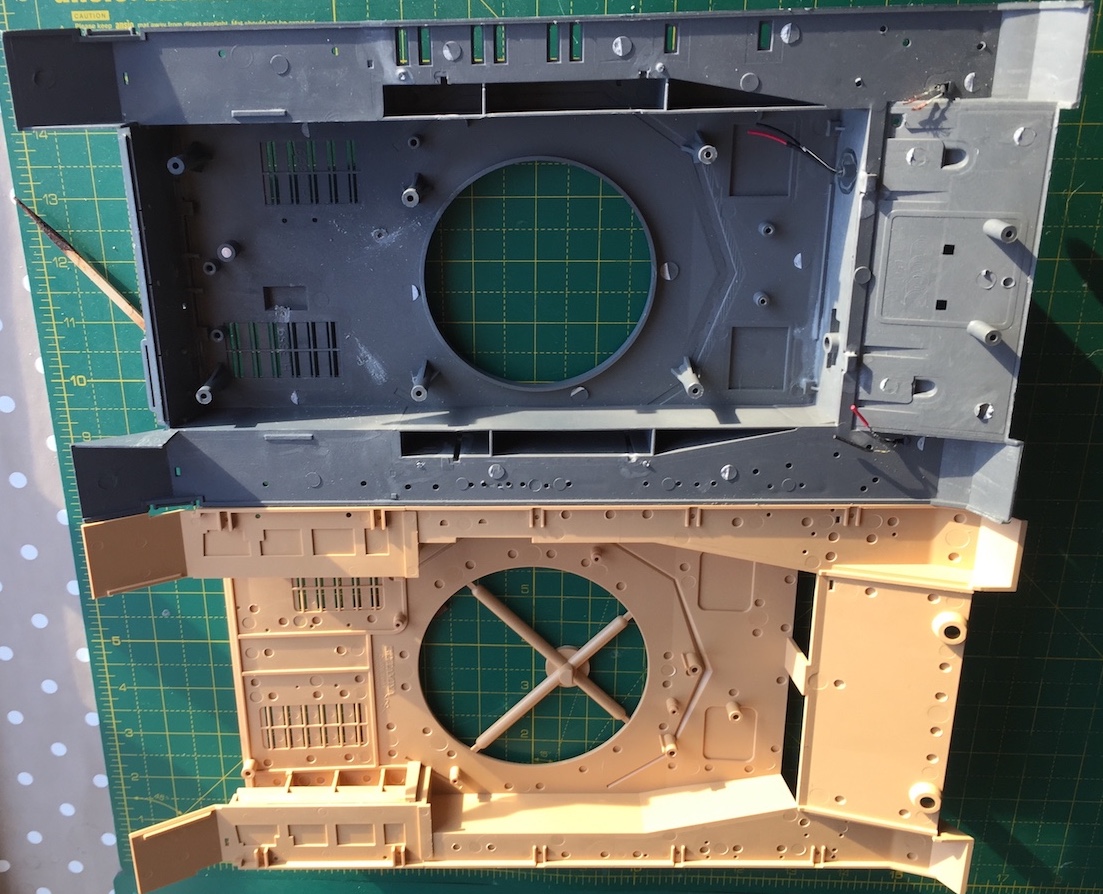

Although the general dimensions, and proportions, of the two are roughly the same using a Tamiya upper hull with a Taigen Turret would be a major challenge, as would transplanting HL internals (elevation unit/ turret rotation unit etc) into the Tamiya upper. If you'd like to see how they're arranged, and how they differ, have a peek:
and again:
If you're wondering why I've had a good look at the two, it's because my Pz IV project stalled when I tried to marry the HL upper hull to the Asiatam metal chassis/lower hull. Having sawn a fair chunk off the Asiatam lower hull to make it line up properly with the HL top, I began to notice just how inaccurate the HL part was. This made me think that the Tamiya offering might be a better option; but then on closer inspection that seemed likely to be a world of pain and modding too.
