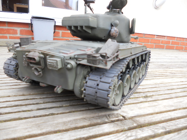

I built one, the tubes are attached to the mantlet and rotate up and down when the barrel elevates and depresses. They look like hydraulic dampers but its springs inside on the real thing.
