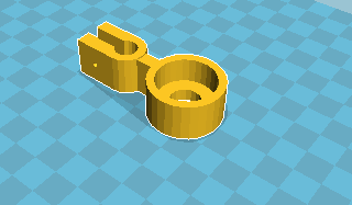

Printer part 1:
- Screenshot from 2017-01-31 09-09-42.png (8.01 KiB) Viewed 823 times

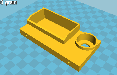

Printer part 2
- Screenshot from 2017-01-31 09-10-12.png (11.34 KiB) Viewed 823 times

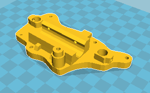

New part above:
- Screenshot from 2017-01-31 09-08-55.png (11.54 KiB) Viewed 823 times

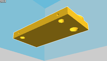

New part underneath:
- under.png (3.95 KiB) Viewed 823 times
