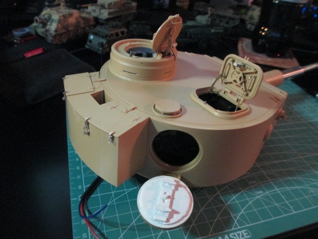

It was a very busy weekend with a couple of days of driving so I was very happy to be home and back to working on the Tiger. Thank you, C.R.73! I just do what I can do to add a little pop to the kit. I painted the hatch and mounted it to the turret. It works well and there is enough of a friction 'clip' into place that magnets will not be needed. Pics:
Closeup
Closeup
Installed
Installed
and a couple of coats of interior flats and some edging in Dunkelgelb
Some putty to mould the edges...
Some putty to mould the edges....JPG (96.41 KiB) Viewed 3911 times

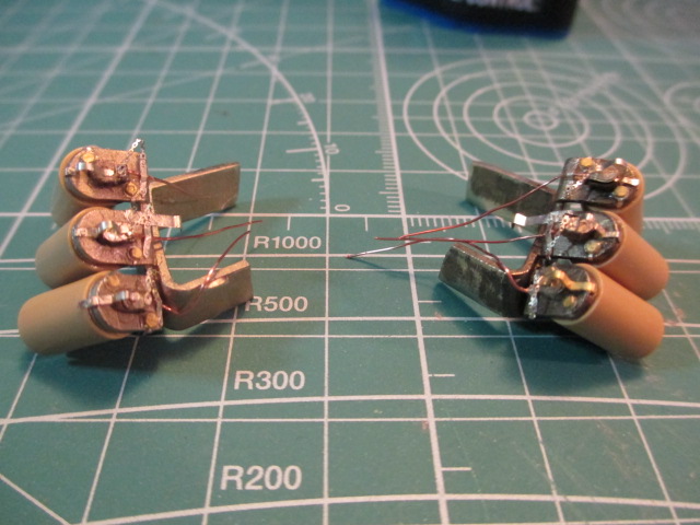

I've been dealing with a bad head cold for a week or so now but surprisingly enough, work on the Tiger did not suffer unduly. My concentration was on small and fiddly and not on how miserable I was physically. ;o) Tamiya RC Steps 41, 42 and 43 have all the assemblies complete. All that remains is the Commander, plugging in the electronics for final mount and painting the turret to add these last assemblies. Pics:
These see all the major assembly steps in the Tamiya kit complete.
Both sides complete
Both sides complete
Another view
Another view
Another view.JPG (95.68 KiB) Viewed 3846 times
and add the ABER bits to get this
and add the ABER bits to get this.JPG (97.64 KiB) Viewed 3846 times
Start with these Tamiya and Wecohe parts...
Start with these Tamiya and Wecohe parts....JPG (98.08 KiB) Viewed 3846 times
ABER instructions for the turret smoke launchers
ABER instructions for the turret smoke launchers.JPG (95.82 KiB) Viewed 3846 times

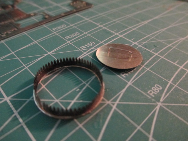

Adding the solder ring and a little putty really smoothed it out.  I'll be using magnets (if possible) to attach this so Mike can remove it to show the actual vent underneath.
Adding the solder ring and a little putty really smoothed it out. I'll be using magnets (if possible) to attach this so Mike can remove it to show the actual vent underneath..JPG (79.41 KiB) Viewed 3846 times
The ABER turret vent armored cover in paint
The ABER turret vent armored cover in paint.JPG (76.49 KiB) Viewed 3846 times
