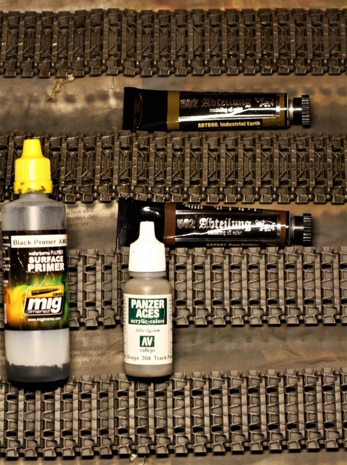

Started on the tracks.
Primed in Mig Black Primer, followed with nice thinned down Vallejo Panzer Aces Track Primer (pair below) and washed with thinned Abt 502 Industrial Earth with stippled in Raw Umber (top pair). Painted last evening the oils still need to dry.
