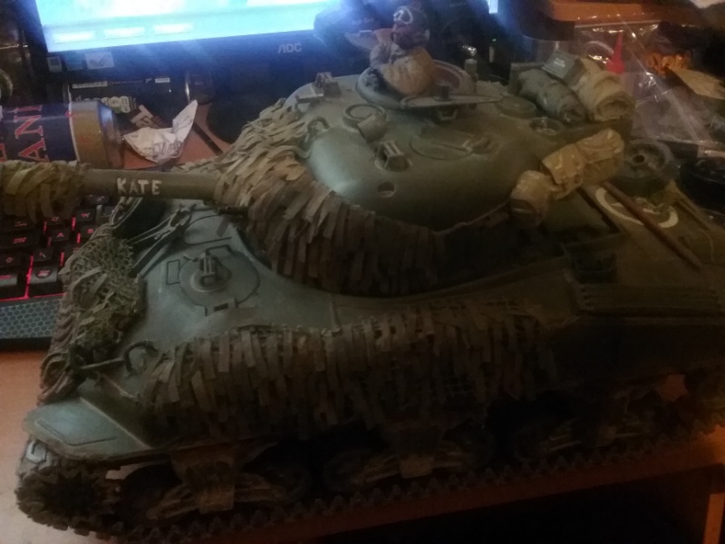

Re: H/L sherman
If picked this one up of eBay recently it needs some work but should have it done soon it is a firefly IC hybrid
