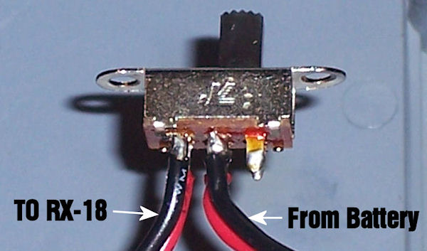

Notice, yesterday I made another work on wires. I made a new welding of the wire on/off switch of the tank using this scheme (see the picture, from rctankaustralia.com)
cablaggio switch on off.jpg (49.43 KiB) Viewed 3467 times

Teo,
For the main switch wiring you definitely need the same gauge wires and nothing skinny. Otherwise it won't bring enough juice to everything on the RX-18. There might not be enough power going to the rest of the tank. The high intensity flash also needs to build up the charge in order to flash properly.
Still think it is battery/power related.
MichaelC.
