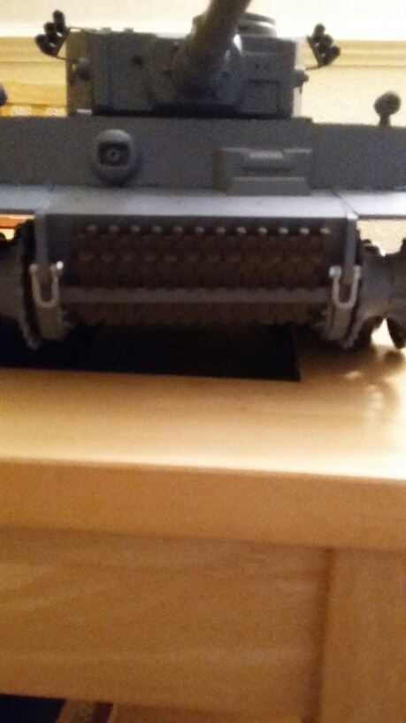

Hi just starting to fix bits on my Tiger 1 completed adding transmission reinforcement plates and I have finished the three lifting points. During next week I will be adding the shackles and relocating the antenna to its proper position. Steady away as its all new to me. Here are some pics of my progress so far.

Good start. It's hard to tell fully from the second pic, but is your cupola forward vision slit lined up facing forward ?
It looks a bit looking left ?
If it is in the right spot, your hatch hinge will be in the 20 to 8 on a clock with the slit facing forward.

Hi Herman thanks for pointing it out as sometimes our eyes play tricks on us. It's just off a touch but I can sort it as it's not glued down yet. I am getting there one step at a time. Waiting for few more items to come then I can do a bit more. ?

Well done a little more today I added my new shackles with Hex bolts. Looks really nice. Next to add will be the metal sight slits on the turret once they arrive from Europe.
