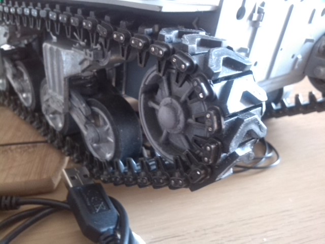

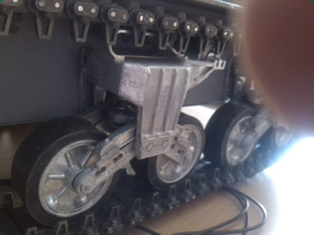

I assume that these are the ones you are referring to. Mato double sprung? I have these on a Mato Sherman Hull, they slot straight in. As long as the Taigen and HL mounts are the same, with the two screw clamp on the inside, then they should fit ok.

Yep Rob those are the ones. :thumbup: How well does the spring action work?
According to MichaelC there are not a direct replacement for the HL and do requiring engineering to get them to fit. :think:

They work like a dream to be honest, I can push down as hard as I want on the upper hull and it doesn't move at all, but the road wheels float over bumps when they hit anything from underneath. :thumbup:
