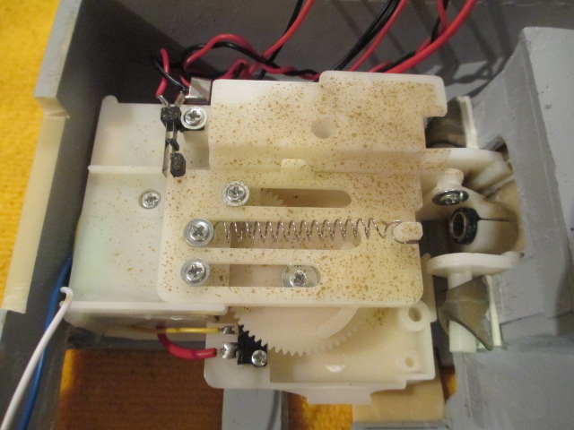

Good afternoon,
The Taigen recoil and flash should work in your casemate, Arnie. I mounted one of them in my StuG III Ausf B with doublestick tape and epoxy. The recoil unit only needed to have the recoil arm shortened and in the case of your StuG IV, that may not even be needed.

That looks like a tight fit Painless :)
Posts: 7900
Re: Asiatam/Taigen Stug IV
Arnie,
It is an 'exact' fit, I won't kid you. ;o) It can be done without too much stress tho'. The recoil and flash is impressive on a smaller Assault Gun like the StuG III.
