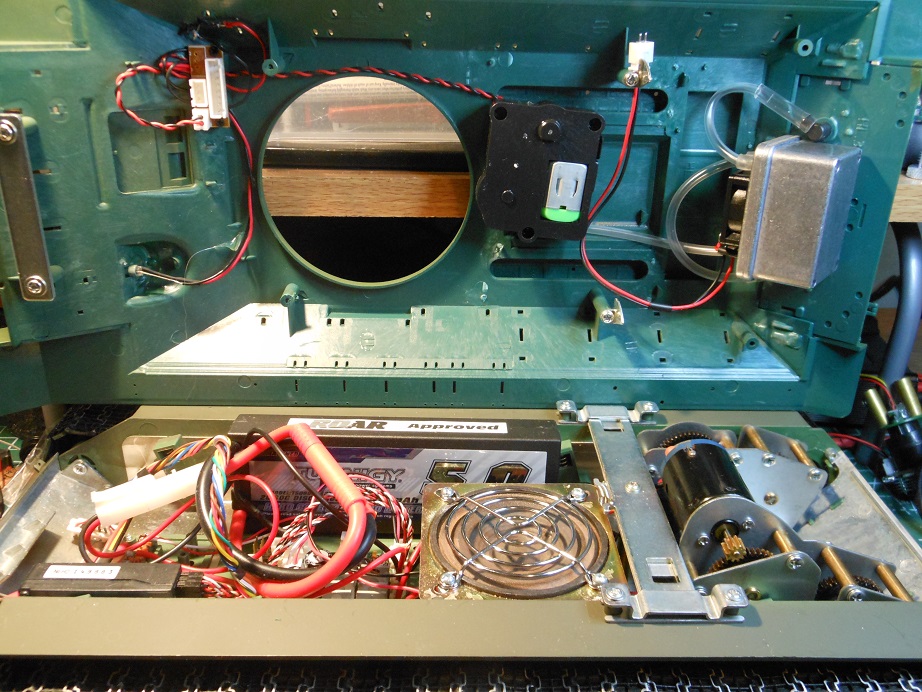

As per Kiaser if you remove the speaker from the base plate you can re-arrange it so that it is more efficient. This is the layout of mine, and I even squeeze in a TARR smoker in between the gears and it is affixed to the upper hull. The battery I have there is 5000 mAh lipo that is the same size as the HL battery case. It doesn't matter in this case as I am just putting it on its side. The speaker is also much larger than the stock Taigen one as well.
MichaelC.

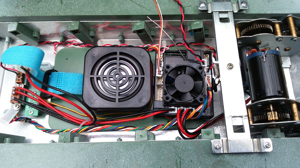

Kiaser wrote:I could be wrong but someone might jump in here but the plate your referring to is screwed from underneath the bottom of the tank the hole thing should come out then the speaker has screws holding it from memory and the bottom of the control board is stuck on .
Thanks, I'll check that out :thumbup:
Thanks Kaiser you were spot on :thumbup:
Removed the board and modified it can now slide the larger capacity battery in no problem :D
