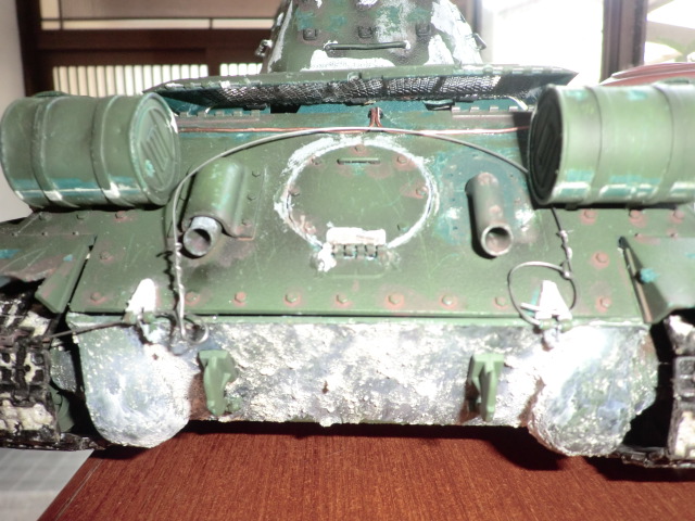

but this is what I did with my T-34, the rear hinge is made of wire, superglued through the lower hull and a bit of putty to hold it up, has a little flex too,
the front is like RC car style,
I just pop the lid up and swap the batt out, only downside is the smoker sometimes needs teasing back between the motors
