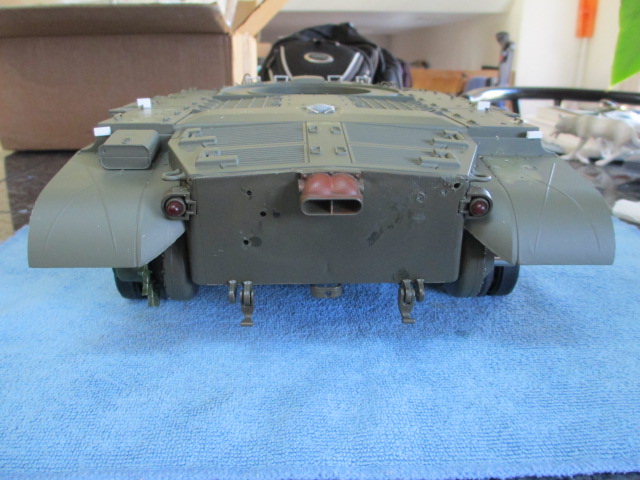

A careful start filing down the HL leds to make room for the Tamiya lens and ring.  Tamiya also provides black out light lens on the 'E' sprue to further dress up the lights.
A careful start filing down the HL leds to make room for the Tamiya lens and ring. Tamiya also provides black out light lens on the 'E' sprue to further dress up the lights..JPG (80.52 KiB) Viewed 4012 times
Simple two piece Tamiya tow hooks  attach directly to the HL mounts with no modding needed.
Simple two piece Tamiya tow hooks attach directly to the HL mounts with no modding needed..JPG (95.27 KiB) Viewed 4012 times

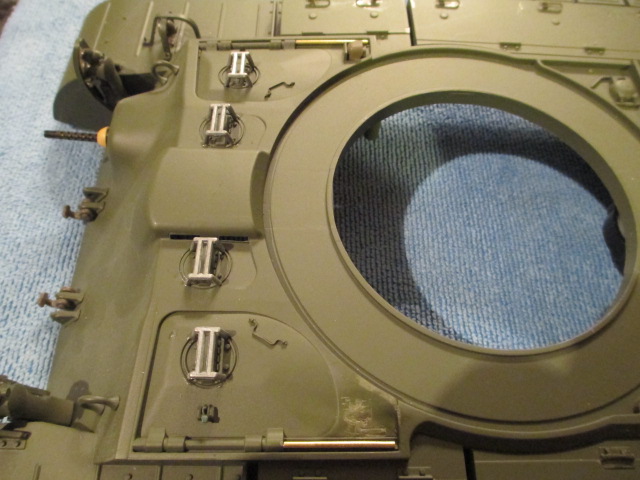

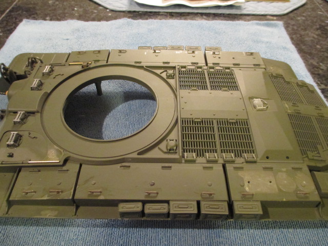

Alpha, thank you. Yes, Woz's work is really a boon and looks much better than the molded caps. It is fully workable and opens either side by pulling a pin. The antenna port it covers might make a decent charge port one of these years. Nothing in the post today so I got started again on the headlights and continued work on the upper deck. Pics:
Last job for the evening was drilling for and gluing into place all of the stowage bin handles from Tamiya.
I added the rest of the torsion bar hinge for the hatches cut to length out of brass rod.

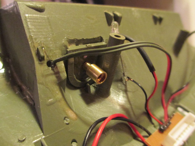

I took a tip from HL and used rubber cement  to keep the led in place.
I took a tip from HL and used rubber cement to keep the led in place..JPG (94.23 KiB) Viewed 4001 times
Tamiya barrel mated up with the  brass led carrier.
Components to make a more realistic bow  mg.
Components to make a more realistic bow mg..JPG (87.32 KiB) Viewed 4001 times
Completed headlights with Tamiya ring and lens and blackout  cover.
Completed headlights with Tamiya ring and lens and blackout cover..JPG (81.09 KiB) Viewed 4001 times
Closeup of the sanded led.
Closeup of the sanded led..JPG (71.93 KiB) Viewed 4001 times
Filed and sanded down, the HL leds look almost like regular headlights
Filed and sanded down, the HL leds look almost like regular headlights.JPG (79.48 KiB) Viewed 4001 times

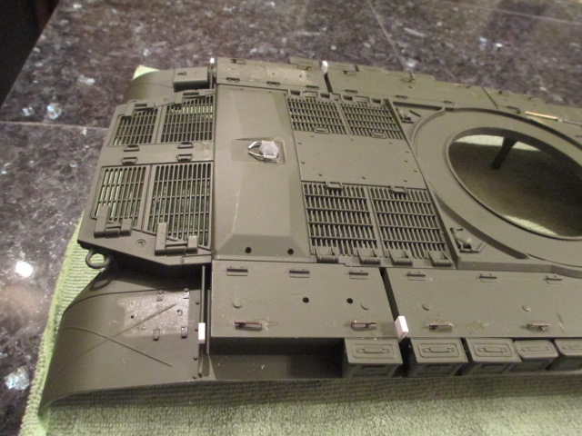

Nothing in the post today. That's not all bad since I am feeling a little under the weather and didn't want to repeat last night's session. I contented myself with continuing to add upper deck detailing and cut out the engine grill stops from pvc strip and glued them on. Pic:
Engine grill stops.  I didn't even know that these were needed until I read through the Squadron Signal Book as neither Tamiya nor Heng Long added them.

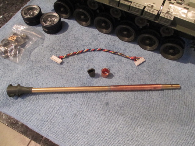

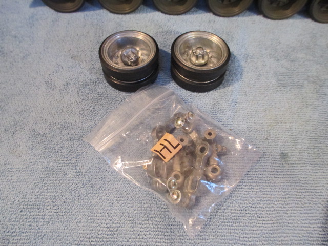

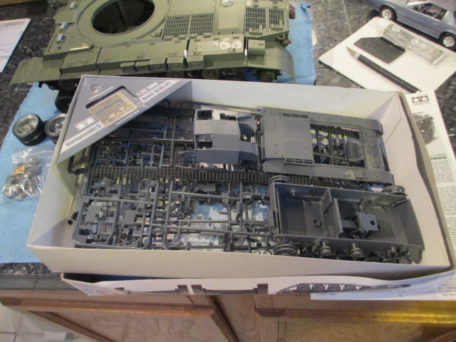

Great day for the Post! It's like time stepped forward and delivered the metal idlers and suspensions as well as Alpha's unique turned brass barrel, buckets, 8 pin cable and a Tamiya 1/35 Stug :O I will finish building this beautiful kit, Alpha and use it as a research tool for a Taigen Stug. *bows* Thank you, my Friend. For work, I backed and filled the upper deck mounting holes and discovered that HL has made a couple of changes over the intervening years in their Pershing. Doing a test fit, I saw that the single central mount in the rear between the gearboxes turned into dual mounts on the new upper. I sawed and sanded them away and did the test fit. Six screws will see the two hulls mated as well as seven ( or eight ) ever did. Finishing up, I drilled as small a hole as possible in the caps on the front road wheels and removed them with a phillips head driver. Going to removable caps on their road wheels was one of the best changes HL ever did, that and dropping the use of push rivets to hold suspension arms in place. The new metal arms use hex screws. Now, I need to order two more of the metal wheels and once all are mounted, they will balance the weight of the gearboxes in back pretty well. Pics:

and lastly a partially built Stug which I will be happy to complete.

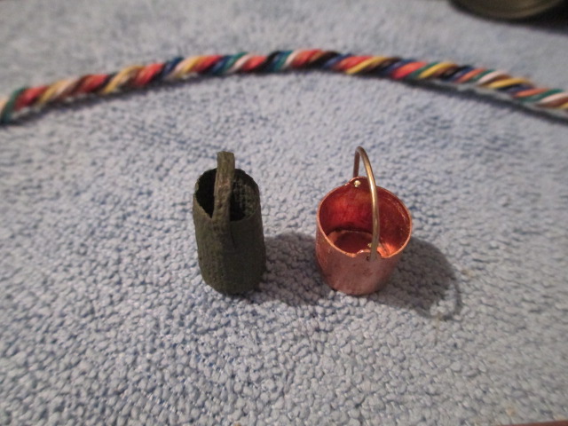

two buckets, one fabric for the Pershing and one copper for a future tank build as well as the eight pin cable for the tank
a one of a kind turned air soft barrel for the Pershing which once mounted will correct the length and diameter of HL's main gun on the tank
Classic Stug packaging from Alpha contained...
Metal idlers and suspension arms
Heavy Metal from Tank Army!
