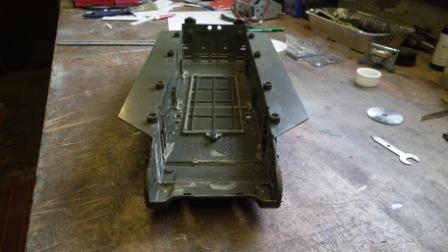

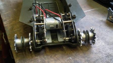

hawkeye3guns
Posts: 486
Joined: Wed Dec 09, 2009 12:12 pm
Location: Grantham, Lincs, UK
Re: brain surgery is easier
Post by hawkeye3guns »
Hi canned not sure what your building ( I been away working abroad) but if your putting heng long boxes into a mato hull. here's a couple of pictures from my trailbrazer build if it helpsI used the metal gearboxes with long shafts it very tight and you have to wriggle the gearbox/motor assembly's in as a pair but so far they are working a treat.
empty mato hull front.jpg (28.91 KiB) Viewed 568 times
new Heng long gearboxes and M26 sprockets.jpg (30.47 KiB) Viewed 568 times
if they of any help.

You can chop quite a lot off the front as the transmission cover will cover it
