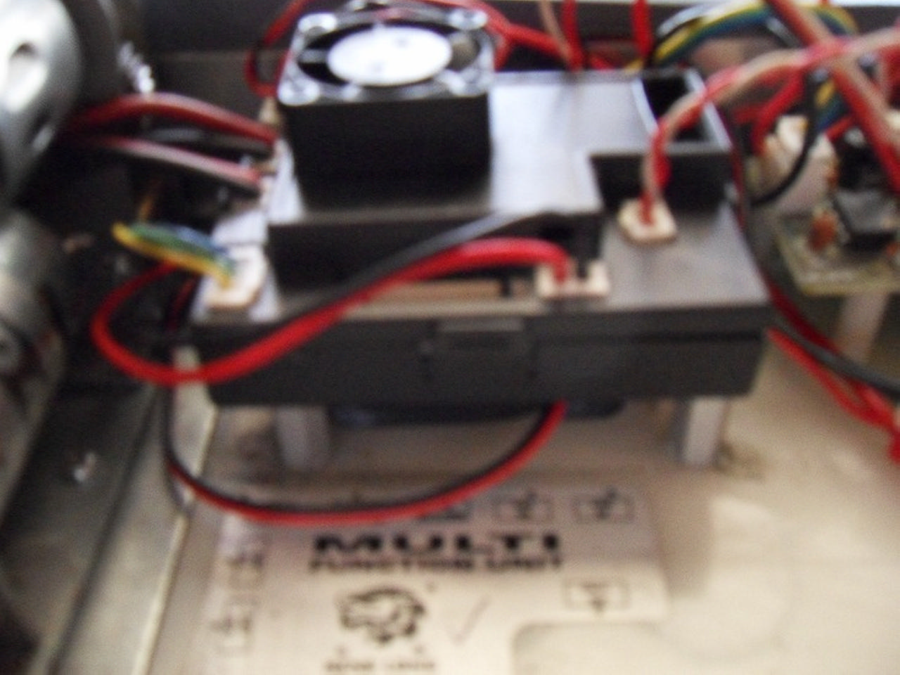

Excellent work! And a part I for one would like to have. When Asiatam first introduced the Tiger lower hulls they included a new component tray. I used this tray but found the layout was not optimal for the other modifications I wanted. Specifically the elevated MFU to allow dual fan cooling, Vertical mounting of the receiver to allow cleaner wire routing, and a reposition of the smoker location.
My point being custom component tray to mount upgraded components have not evolved with the lower hulls. This might be a worthy project to attempt? I have included a picture of the original layout. Even the RX18 ENCLOSURE could be created which has fan mounting to allow airflow cooling? I am sure the possible creations are almost endless,
standard Asiatam Component Tray
Elevated RX18 unit with dual fans for air flow cooling
