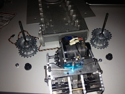

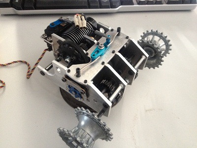

Hi Folks, I have a Mato metal Tiger 1. Ive built a steel gearbox that will give me more power and control , i hope. this is my test version and its first test, overall a success. version 2 is going to be a lot lower gearing , more compact and asthetically pleasing to the eye. ive built this as i intend on using the tank for crawling mountainous garden and deep mud...and also is very quiet ,with more power than any condition requires cheers...

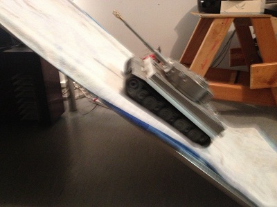

incline test result 11s all the way up the towel

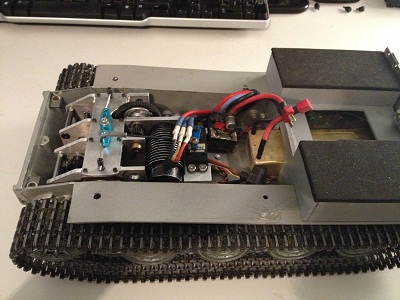

ready for testing, not yet ready for mud

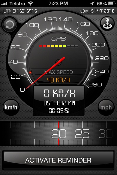

43kph,@7,4volts. i plan on lowering the top speed to 9kph-12kph

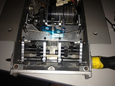

how i check my alignment, with screwdriver
cartridge unit and axles
assembled unit testing on bench for brake adjustment

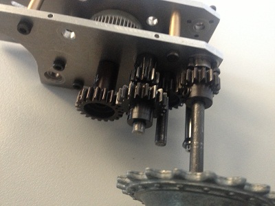

L/H gear assembly .note only stepped down once
centre, diff and primary drive 19T {ver2 has 12T}

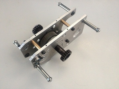

bare carcass with brakes

That is really nice work Sir.

Hi Very nice bit of engineering you have done there. Have seen gearboxes made for brushless motors but they used 2 smaller motors ,havnt seen one done for one motor. :thumbup: :thumbup:

That looks strong. Next time do a short video :thumbup:
It's a step away from the traditional gearboxes today. I love the design of the tamiya leo gearbox, and Wonder why nobody try to make a cheaper version ( I know there is a super expensive German on)
