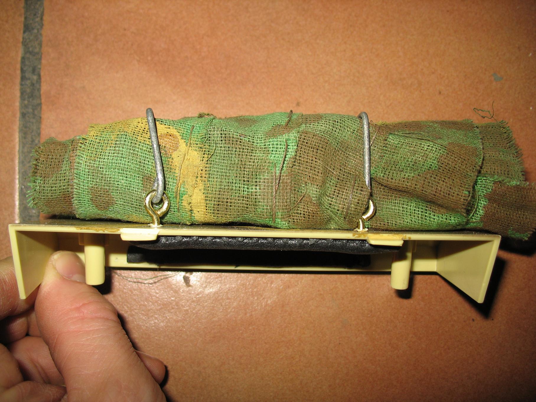

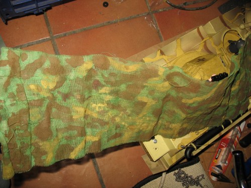

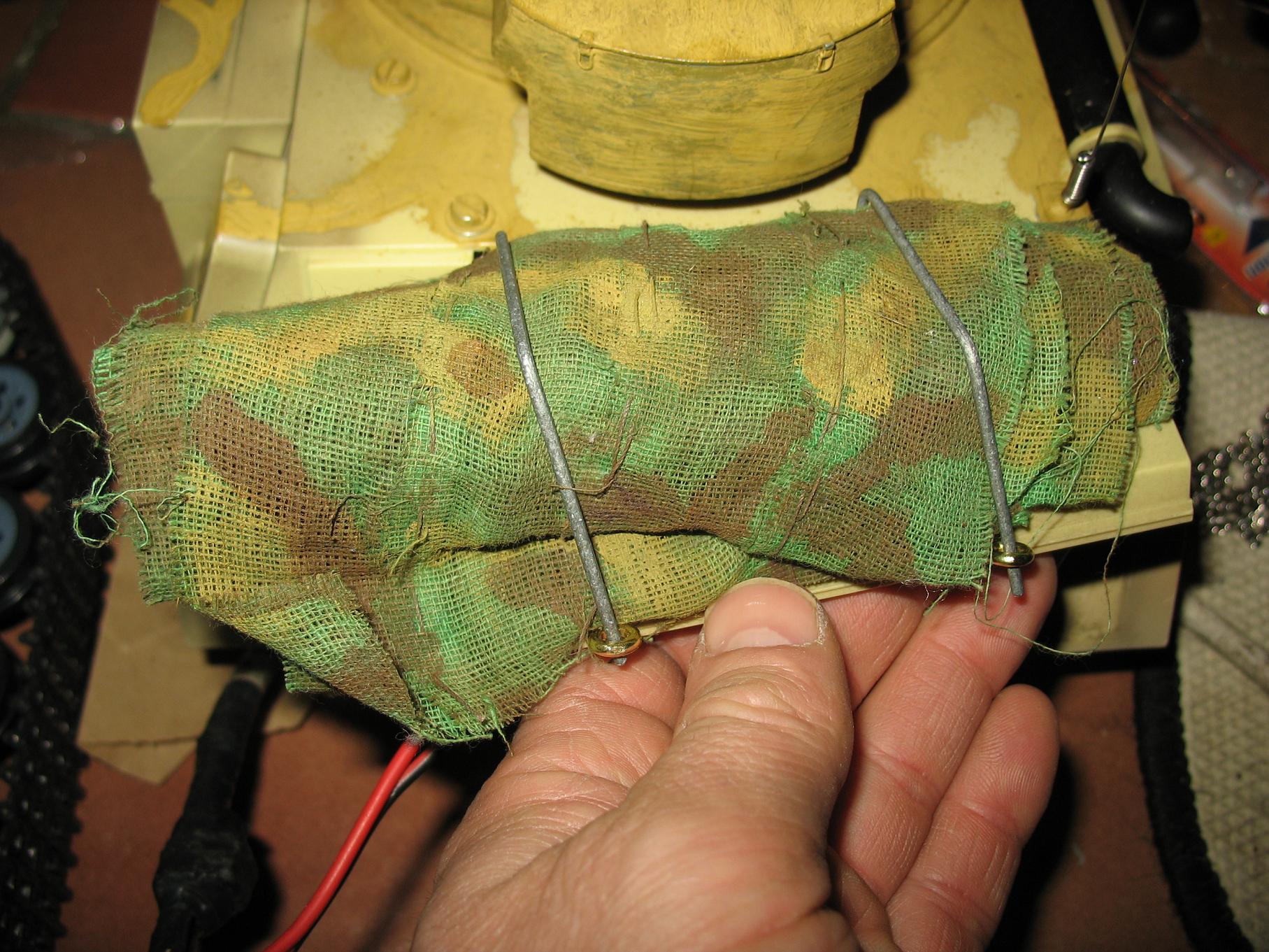

Latest addition.. Camo netting on the rear..
Mounted on the removable rear storage....Simply held with self taping picture hooks and bent pieces of wire that rotate around and are held by their own tension into two more self tapping picture hooks..
Camo net is simply a bandage that was unrolled to full length, cut into sections and sewn together in 5 strips wide before being 'painted' with a brush.... Its crude but it works...

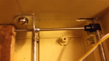

Shedding tracks on carpet? Sounds like you need a track tensioning system. My son's tank turns fine on anything including grass!
Track tensioning system using a 3mm threaded rod and a suspension part from an RC car. You will need to cut a slot in the hull to allow the axle to slide back and forth etc.
Hope this helps
