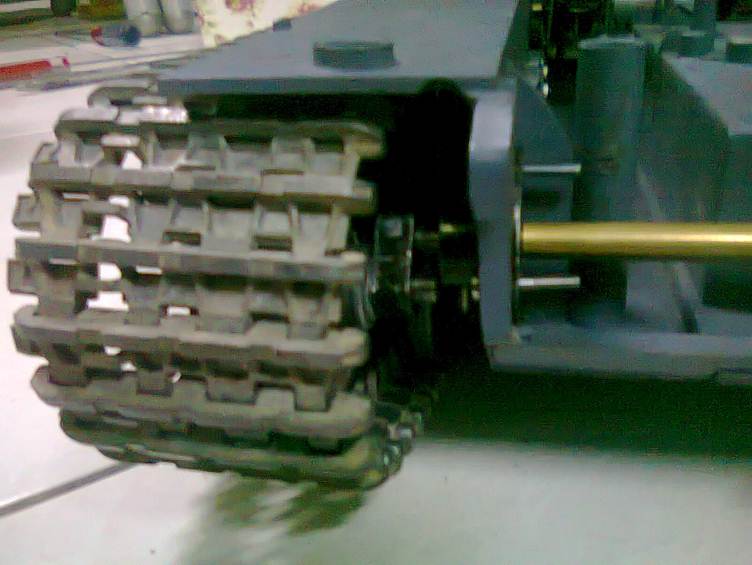

i have done setup for my track tensioners , the installation is very hard for newbie like me He3...here is the pic. i'm not install the big "washer" yet because I'm forgot to do that but maybe next time i do...
for you information i just drill the 13mm hole only and the other hole that for tiny screw i use a small size allen key then i burn it until the allen key getting hot than it's make me easy to make the hole for that tiny screw here is some picture after the process..
best regards

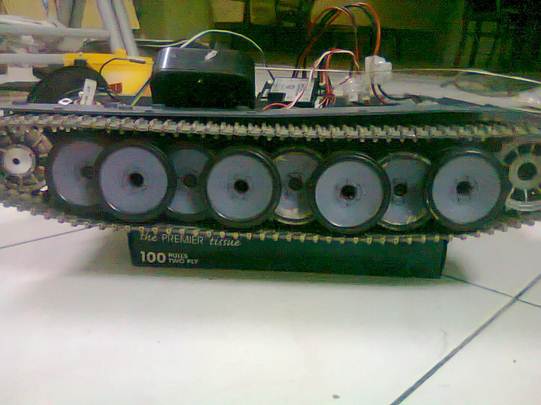

other picture
picture 2

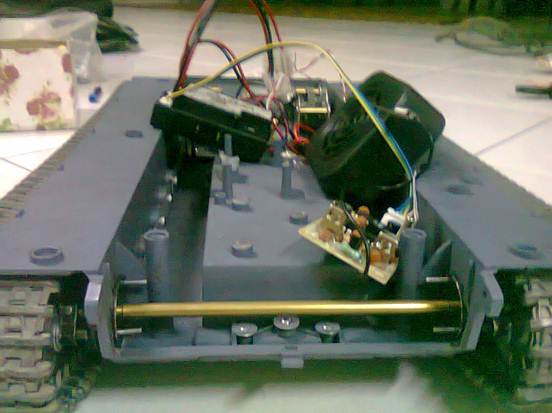

just another picture after process 8)
picture 3

akina_subtitude wrote:i just drill the 13mm hole only and the other hole that for tiny screw i use a small size allen key then i burn it until the allen key getting hot than it's make me easy to make the hole for that tiny screw here is some picture after the process..
hello, this works with the plastic hull, but not with the metallic one... ;D
also, in some of your pics... it seems to me that you have excesive tension on the tracks, they must go down from the sprocket to the 2nd or 3rd wheel, or you can use the '4 fingers' rule, between the first wheel and the track they must have a separation of 4 fingers, about 5mm in scale.
look to pics of real Tigers and see the correct position for the tracks.
best regards
Jussek
best regards
Hi jussek ,
Thanks for the advice ...so for my understanding that maybe i need to adjust a little bit my idler wheels to the lower and reduce the tension of the track is it right..correct me if I'm wrong......or the worst thing i have wrong in doing my track tensioners setup :sick: huhuhu...

Hello Syrulizan - Very important - check the wheel alignment too , with a steel rule or something similar , so that there is no binding on the rack horns .
