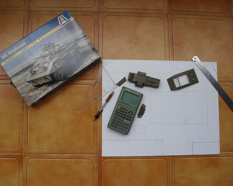

I was looking for a non standard vehicle to go with my U.S. tanks and come to the idea of the M8 but it doesn't exist so lets go I start to make it using a small rc 4x4 with turet made in china for electronics componants.

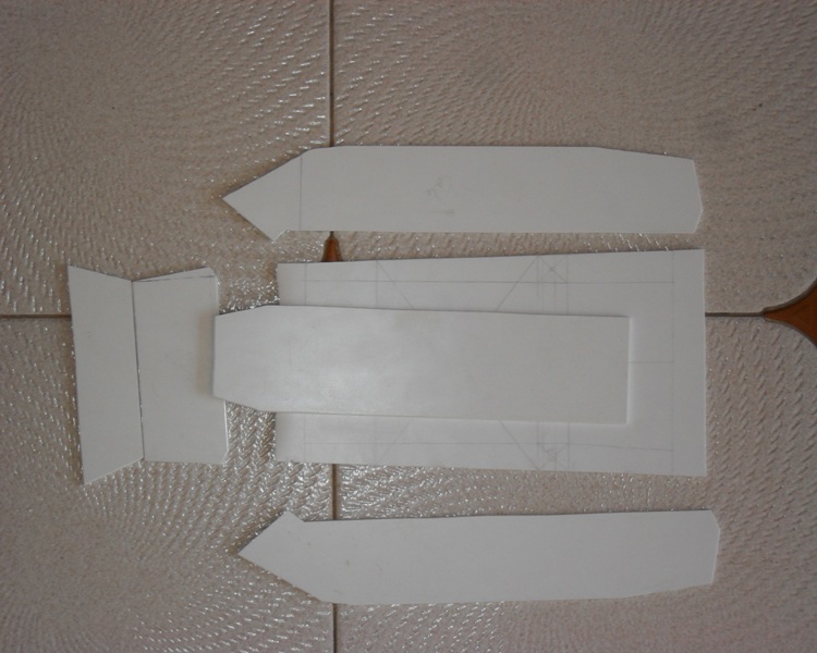

First step I started with 3mm plastic board using a 1/35º model as reference:
M8 greyhound scratch build

thanks for your comments, I've try with drawing but to have a realistic model like for the M8 who have a lot of small parts and or angle I prefered to start from an existing model like 1/35º

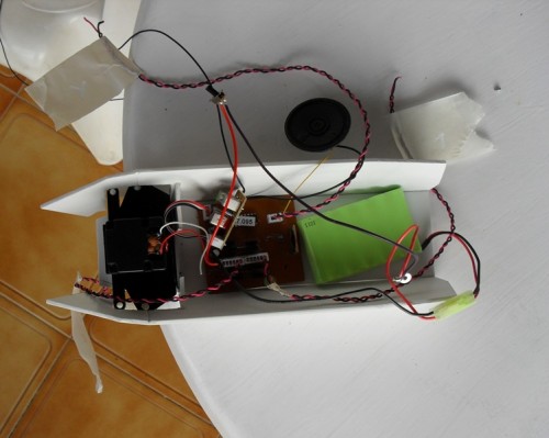

I have placed the streering system and equiped it with Hobby Engine electronic's. Why Hobby Engine electronic's? Just because the 2 engines are working seperatly, it have sound and turret engine too. I modify it to use 1 engine for the transmission, the other one for the turret and the engine normally used for the turret for the steering.
I put it into the base to check if everything fit well, the on-off switch will be located under driver's hatch and the engine cover can be removed for battery access

Looking good mate . It looks as cramped as my Hetzer in there with all those electronics.
