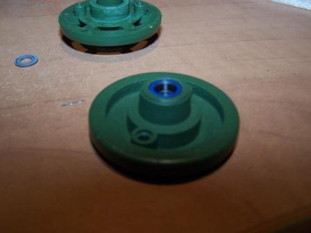

Drilled a 21/64 hole in both idlers and pressed 2 pieces traxxas sealed bearings (Part 5114 I believe ) in each wheel. An inner and an outer cost $5.49 per pair, see pic below super easy mod.
Panther 008.jpg (15.7 KiB) Viewed 2073 times

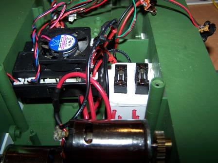

then as always I add a fan, and 7 amp fuses to the motors, On this one I built a box for the fuses to sit on and placed them inside the tank.

I have them inside as I plan on using rare earth magnets on the hull for easy access- ergo no need to keep undoing screws to get at the insides.

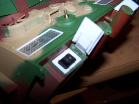

Now i really hate the switches being located on the bottom of the tank so they gotta be moved. To the boxes at the back of the Panther with them.

First fix the light. 8) I made the cover from a piece of thin aluminum and the hood from Tamiya 2 part epoxie. sands easily but don't wait till it's completely hard, then it is a killer to shape by sanding and filing.

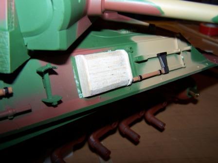

As I am detailing the outside the wooden jack box from HL really looks sad, So 4 pieces of 1/4" x 3/4" balsa glued together with some 1/8" ends glued on. Sand/cut to size and you have a real wooden jack stand.

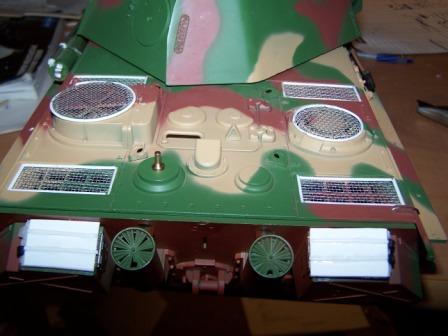

Now to add some wire to the grills. This is just a small weave aluminum mesh used mainly to keep the bugs out, you can get it real cheap at the local hardware store and it is real aluminum so after paint it looks good.
Cut to size, glue in place and make a frame around it. For my frame I am using .040 1/4 round sheet styrene. Its thin enough to really not be too obtrusive yet it still looks like their is a frame.
Panther 009.jpg (24.36 KiB) Viewed 2067 times

On the storage boxes and you can't see them clearly here I used the ends of small zip ties, cut them in half for proper thickness then cut the tie part off and glued them to where the clasps would be on the storage box. They look close enough like a lock so that wasn't bad.
I'll get a couple more pics tonight as I have moved the hatch locks to the correct position and the antanae as well.
For now I will touch up the areas that are not 100% before I move onto the next thing which will be the welds on the hull.

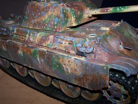

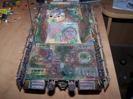

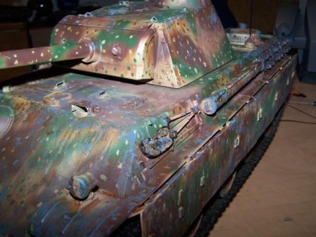

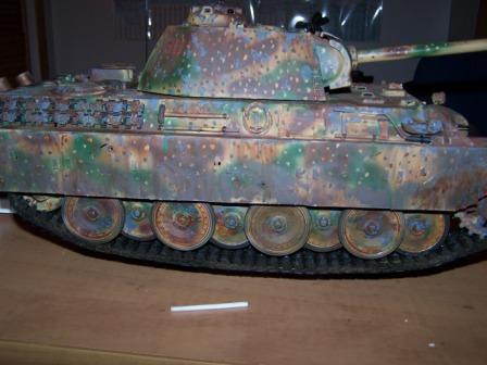

skipped a lot of steps but here is where we sit, painted and into the weathering, All the grey spots will eventually be weathered areas, i always paint spots a color i can pick out easy.
I have converted this from BB to IR and am using the Mako and ATRC boards along with the pothead volume control and an RC2HL 2.4 ghz reciever board.

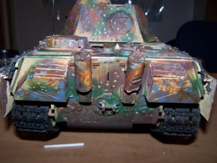

Here are a few more, next project is already underway.
Panther 021.jpg (30.53 KiB) Viewed 1988 times
Panther 020.jpg (26.67 KiB) Viewed 1988 times

That's a beauty buddy, well done. Patricia's Lead the Way!!! :clap:

Nice side skirts. Did you scratch build them?
FreakyDude
Posts: 391
Joined: Thu Aug 04, 2011 8:31 pm
Location: Canada
Re: Surprise another Panther G
Post by FreakyDude »
yes the shurzen are scratch built, I tried metal first but unfortunately don't have anything accurate enough to punch the mount holes so I used pastic card. The hangars are made from brass. I might remove a plate from each side. it may look better with a plate torn off.
