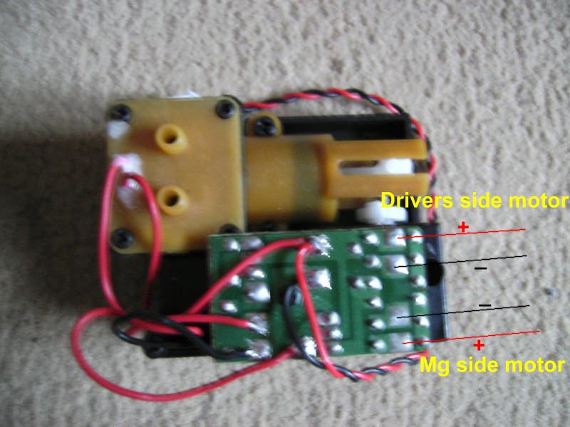

I just disocovered yesterday reading one of the post that this kind of unit need to be, not only pluged to the RX-18 but to the motors too.
I would like to ask how and which part I need to link to the motors of the smoke unit, I don't have any Idea and experience on that.
There is any scheme I can follow or instructions???
Thank you in advance.
Cheers,
Gianfranco.

Hi Willhob,
Hope this helps you out.
Ace
smoker electrics.jpg (15.02 KiB) Viewed 997 times
Smoke me a kipper.......i'll be back for breakast

this how i wired my unit up

Hi Thanks a lot!!!
It will really help!!!
