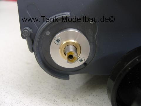

Sorry I forgot to add this bit about the 'Modellbau' sproket / final drive shaft support that is also worth investing in .....Here is a number, and the item picture to show the axle supports on 'Welsh Dragons ebay site' Steve is a member of the forum....and it is probably worth checking his actual on line store to see if the items are any cheaper when bought directly !......at the very least you will save him the Ebay costs...which are a bit steep :O .......I ought to buy a pair as well as a ' Belt ,Braces......washing line and tow rope' precaution on MY Tiger...... :haha:
Alb.
120894389105

I have those shaft supports. I think there are a couple if sizes so you need to get the right one for your gearbox shaft. If you try to force the wrong size on they just break. I also recomend the asiatam as the best upgrade for the tiger.
