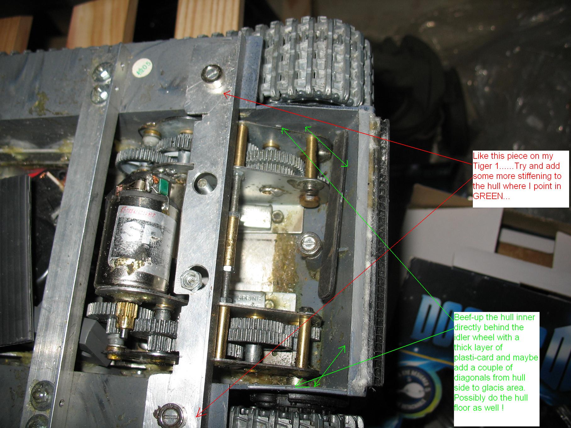

The problem that you have will also be made worse by the plastic hull flexing.....Is it an Asiatam hull or a standard Heng long ?? Either way is will be worth adding some crossbracing between the two gearboxes. The single plastic 'first' gear in the gear-train is a standard mod to convert a ordinary metal gearbox set into a 3:1 reduction unit ...here is a post on how to do it....

Are there any of the metal cross bracing 'rods' on your gearboxes ??..they are very visible and clamp the two steel plates of the gearbox together it help prevent this flexing that you are seeing.....It is possible that who ever converted the gearboxes did not put them back in after conversion...here is a photo of the gearboxes on my Tiger.....It is all braced 'left right and centre' to ensure that it is Totally rigid... :haha: .....sorry about the 'Writing ' on the photo but it was altered to send to another Forum member who had problems with a KV-1.....you can see the 'gearbox cross-brace mod' that I am referring to..it is just in front of the first piece on angle aluminium.....and it is made out of threaded M3 bar and a spare metal gearbox support....the standard ones are in the gearboxes..and there are two brass ones per gearbox.....
I have coverted these gearboxes to 3:1....but I have used a Metal first gear because the motors are Graupner 480 races and I wanted to be sure of no mishaps.... :D

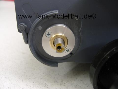

Sorry I forgot to add this bit about the 'Modellbau' sproket / final drive shaft support that is also worth investing in .....Here is a number, and the item picture to show the axle supports on 'Welsh Dragons ebay site' Steve is a member of the forum....and it is probably worth checking his actual on line store to see if the items are any cheaper when bought directly !......at the very least you will save him the Ebay costs...which are a bit steep :O .......I ought to buy a pair as well as a ' Belt ,Braces......washing line and tow rope' precaution on MY Tiger...... :haha:
Alb.

I have those shaft supports. I think there are a couple if sizes so you need to get the right one for your gearbox shaft. If you try to force the wrong size on they just break. I also recomend the asiatam as the best upgrade for the tiger.

Ive now purchased some Black Steel gearboxes with 18,000rpm motors. Im reinforcing the hull with struts that Dietrich has very kindly helped me with info on how he did his. Ive done some already and am really pleased with it :) so more mods are in the pipline
