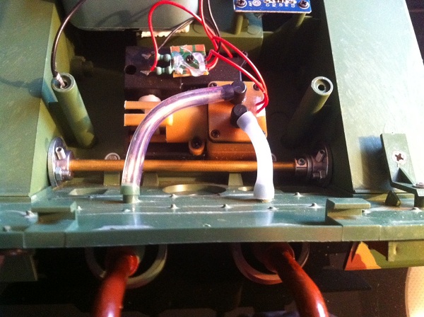

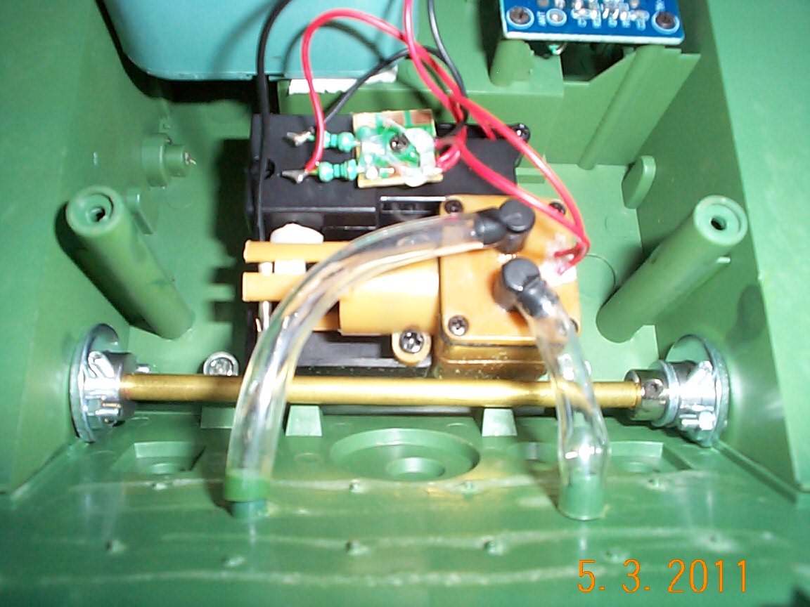

A few weeks ago I got out my lil' camera, one of the early Kodak digitals, to take pics of the Idler Tensioner\Brace install on this tank for Phil Flueger over at RCTankWars.com. He had mentioned wanting pics of the install on the HL KT since he hadn't seen it done with his parts yet. Well, long story short, the pics looked good on the view finder but were so blurry on the PC that I just scrapped them all.
Some Tanker with better camera knowledge can provide them. The setup worked and was basically the same as the install pics for the other make KT hull that came with the tensioner so no great loss to the Modeling world *chuckles* Ok, pics of my tank? I'll see if I can bum the Mate's Smart Phone and take a couple tonight and post them. That will be a pleasant break from packing for the trip.
P.S. Here is the one halfway decent pic from that earlier set. Timestamp is off. I've since replaced that kinked smoker tube with a more flexible type tubing I had laying around in my modeling toolbox.

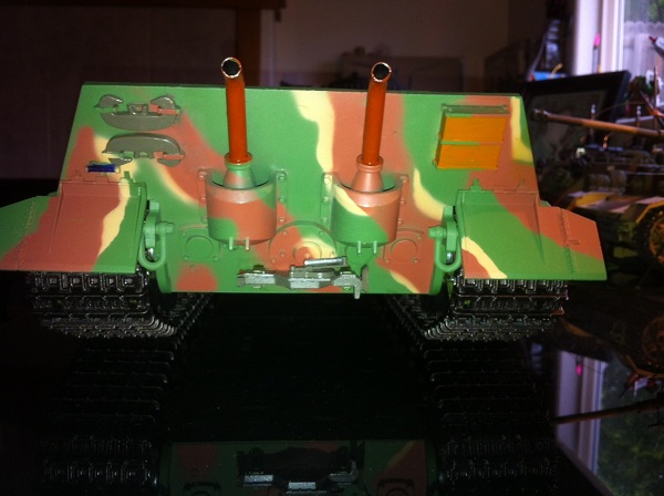

Tankers,

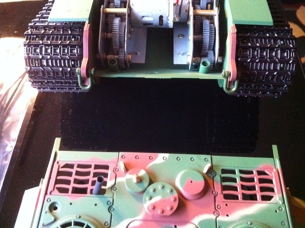

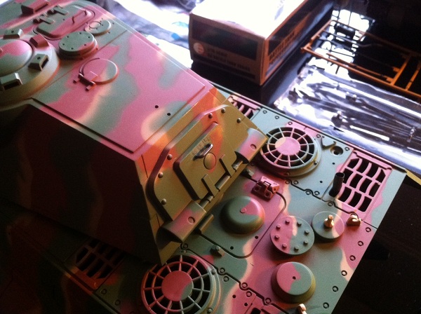

A few Pics as requested. Pardon the dust, Mind the Gap, etc...
- Upper Hull
- Upper Hull.JPG (96.9 KiB) Viewed 779 times
- Back mit Exhausts
- Back mit Exhausts.JPG (73.08 KiB) Viewed 779 times
- Additional Bits
- Additional Bits.JPG (97.05 KiB) Viewed 779 times

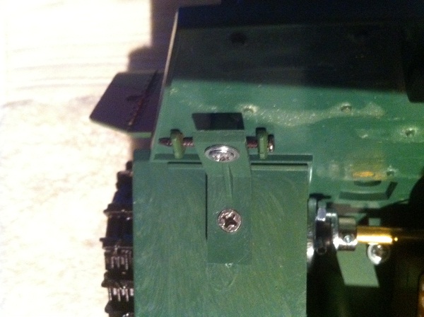

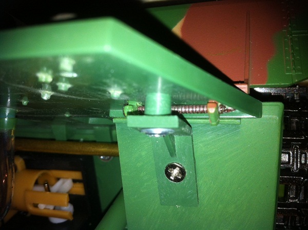

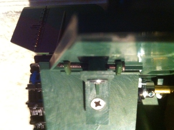

Tankers,

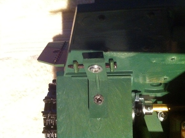

Vacation over and back at work. Here is the little mod I dreamed up to keep the rear mud guards from being lost in high brush (grass) or rough terrain. I put the guard in place and marked the spot where the tabs that went into the hull met the inner surface. I checked twice and used a fine tip Sharpie to mark the best spot for a drill through. The hole couldn't be too big or it would weaken the tabs. I removed the guard and used a 5/64 drill bit in a Dremel and drilled straight down through both tabs. A tiny drop of Super Glue was placed in the drill holes after the guard was fitted back on and a brown paneling brad was pushed through the tabs (I had looked for a good fastener earlier and the brad was the right diameter and length. No cutting needed) It was a perfect fit. The guard even swivels up and down normally. The second guard took even less time. Here are some pics of the finished mod.
P.S. I know some guys here would have built working scale hinges out of plastic stock. This works for me as it is strong and invisible after the deck is back in place.
- Mud Guard Mod 3.jpg (77.88 KiB) Viewed 720 times
- Mud Guard Mod 2.jpg (74.91 KiB) Viewed 720 times
- Mud Guard Mod 1.jpg (82.56 KiB) Viewed 720 times
- Mud Guard Mod.jpg (84.83 KiB) Viewed 720 times
